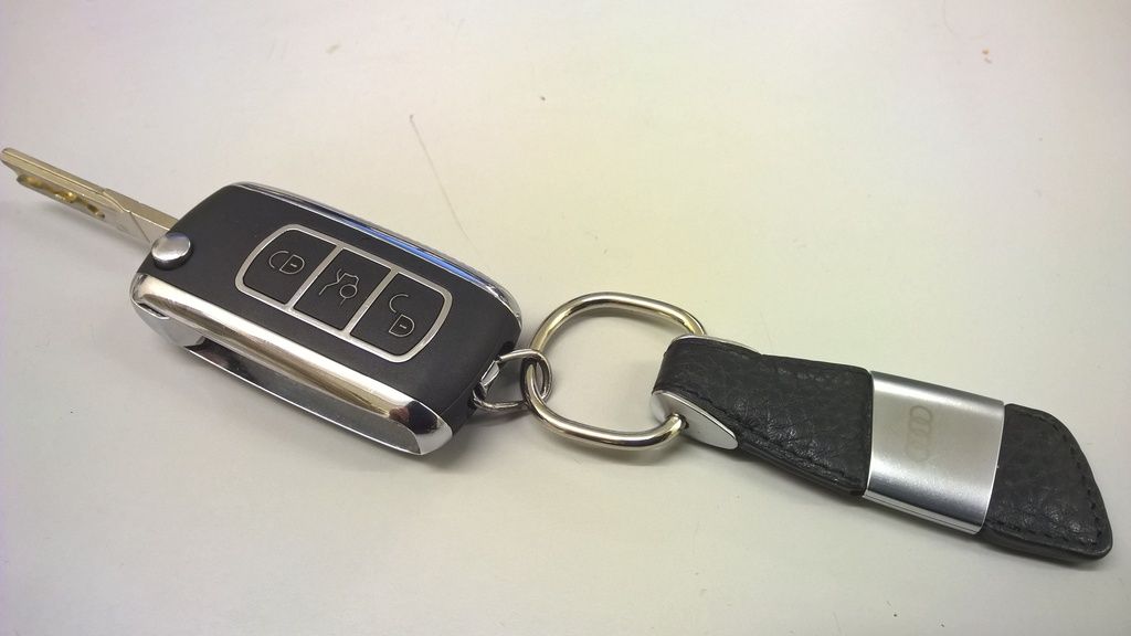

This is my experience.
My car is an 1998 S8. I wanted another key as the 2 I had were looking like death warmed up.
So on advice I contacted Craig at http://www.autosolutions-autolocksmiths.co.uk/
And I booked him in to come visit my car. Couldn't have met a nicer guy. Sad thing is he said he was unable to programme a new key for my car as he didn't have the software, despite trying all things.
Being one who never gives up on something I bought a key from him as he had already cut it before finding out that it wouldn't work.
I was able to programme the central locking function very easily from information from Ross-Tech.
I then spoke to my local Audi to see if they could and yes they could do the immob easily but for all the money ever earned, so that was a no.
The immobiliser proved more troublesome, so I took the new key to bits and removed the transponder chip itself from within. To see how easy it was.
I then disassembled my worst key (which started the car but remote buttons were dead) and removed the immob chip and inserted it into the new key.
and it worked beautifully, so I have a nice Bentley style key with all working functions as if it left the factory
