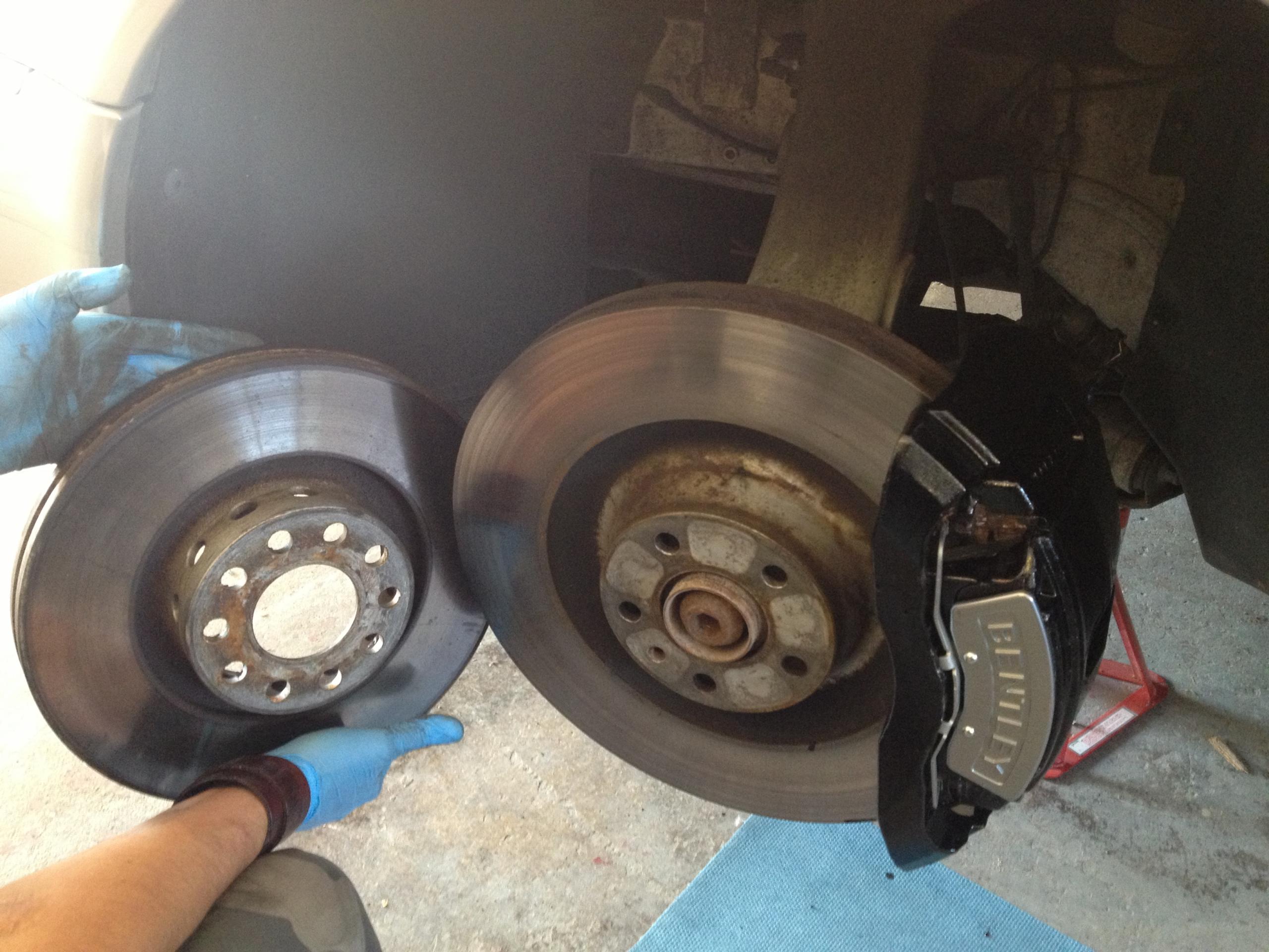

the armoured car looks like a W12 from the exhausts on it so I would suspect that the wheels shown are bigger than 17 inch as the brakes are likely to be the 394mm s8/w12 discs and calipers which are pretty damn big!
here is a picture when I upgraded my D2 to give you an idea of comparison!
Name:	Pic Brakes.jpg
