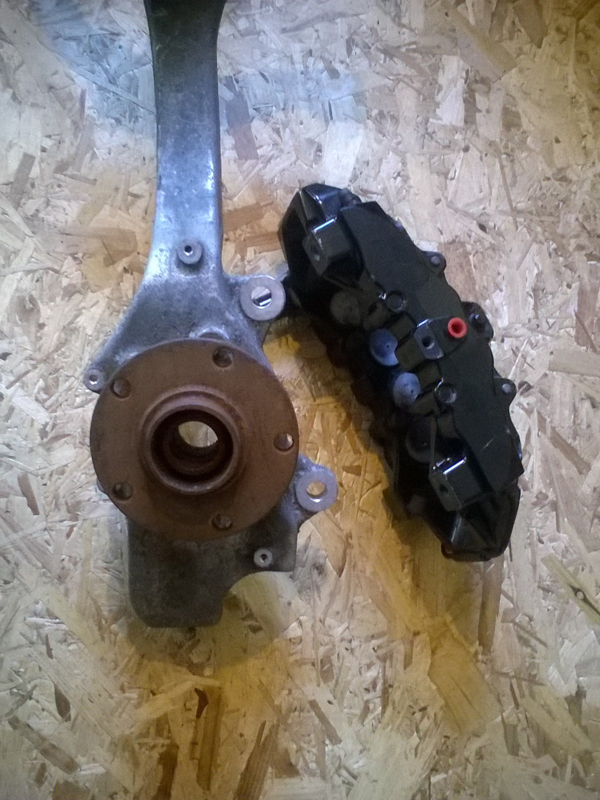

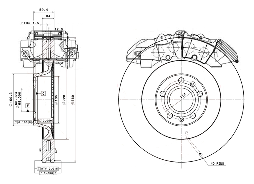

I've had this set of Brembo 8 pots for some time now and thinking of putting them on the D3 with a 360x34mm disc, which is also the oem size disc so a choice of drilled or grooved from Zimmerman. Good idea or not? I've compensated for the 2.5mm difference as usually this caliper used the floating two piece 365x34mm disc. I could easily redraw the bracket to suit a floating 365x34mm disc using the centre bells off a Phaeton for correct offset, should that be the better solution. But my thinking was I'm not a sports driver, the stock 2 pots on 360mm are bit poor and RS4 or Phaeton 365's are £500+

My concern about anything like that would be the mechanical properties, i.e. what forces/stresses do they need to deal with.
This is brakes we're talking about, you don't want any sort of failure......
Old 23rd July 2017, 05:53 PM
Sounds like a good plan to me. Mikes car certainly stops exceptionally well with those calipers.
