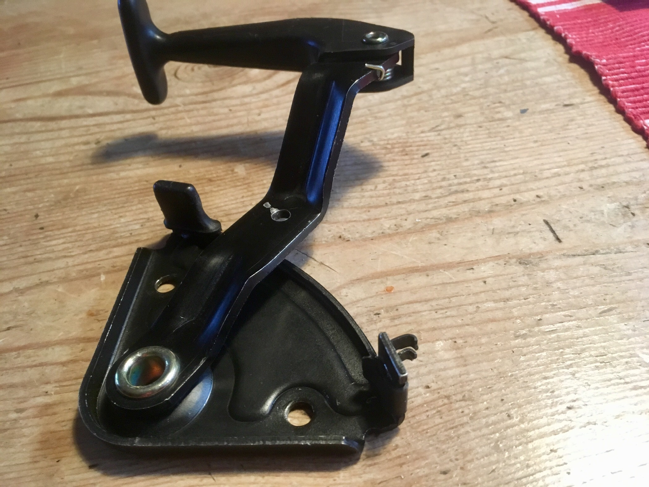

I found a couple of release levers on ebay and, you’re right, the clip has a return on it. I’ll call our sponsors tomorrow!

It just pushes in to the clip from the front of the car. It'll be obvious when you see the replacement. If not, I can grab a pic at the weekend.

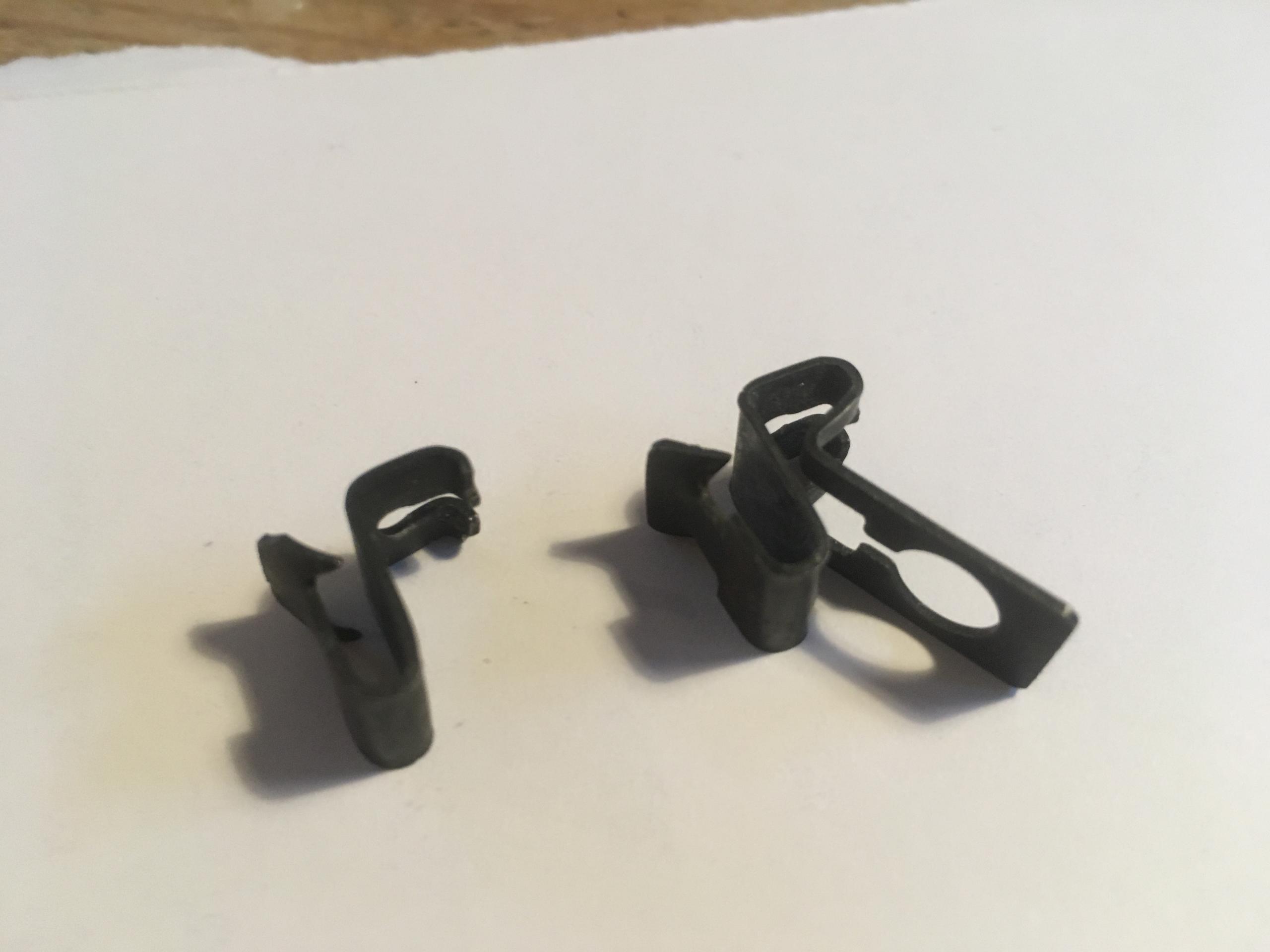

As the photos show, quite a lot had broken off, so it's no wonder the release cable came undone.
