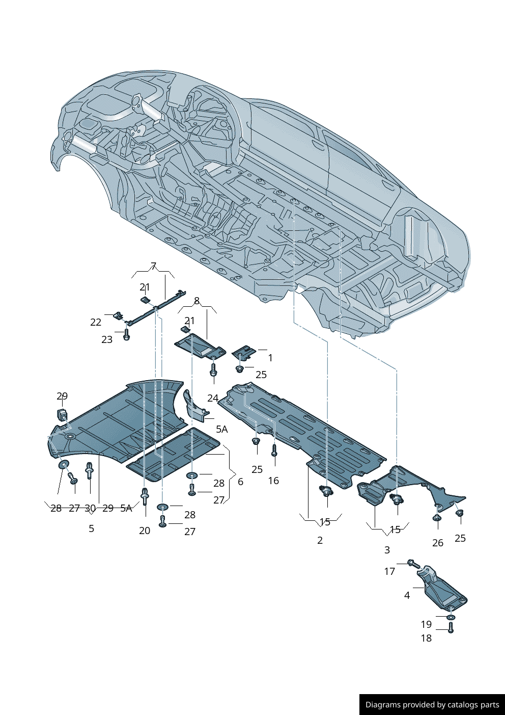

I installed the front two pieces of the belly pans / skid plates. There is a third piece that I did not purchase because I did not know it existed. It's a relatively small piece that covers a very small portion of the transmission pan but mostly the transmission cross member which is just a hunk of aluminium.
Does anyone have experience attaching the third place? I know two screws from the second belly pan will connect to the front of the baffle, 4e0825285a, and the rear will connect to the transmission cross member, 4e0399231n. Or does it attach further back? This part seems like it doesn't protect anything and might be not useful. Also the shape and design of the vent could put stress on the part from the wind.

Is yours petrol?I think it's only for diesels to reduce the noise

Hi, yes it is petrol. I think it might be a universal fit for A8 and S8 models from the catalogues I've seen. The dealer gave me this part number also for my VIN. Regardless, I'm going to go without it this year. Maybe I will get it next year.
Found a diagram,
https://www.lllparts.co.uk/_/product...pn/4E0825285A/
