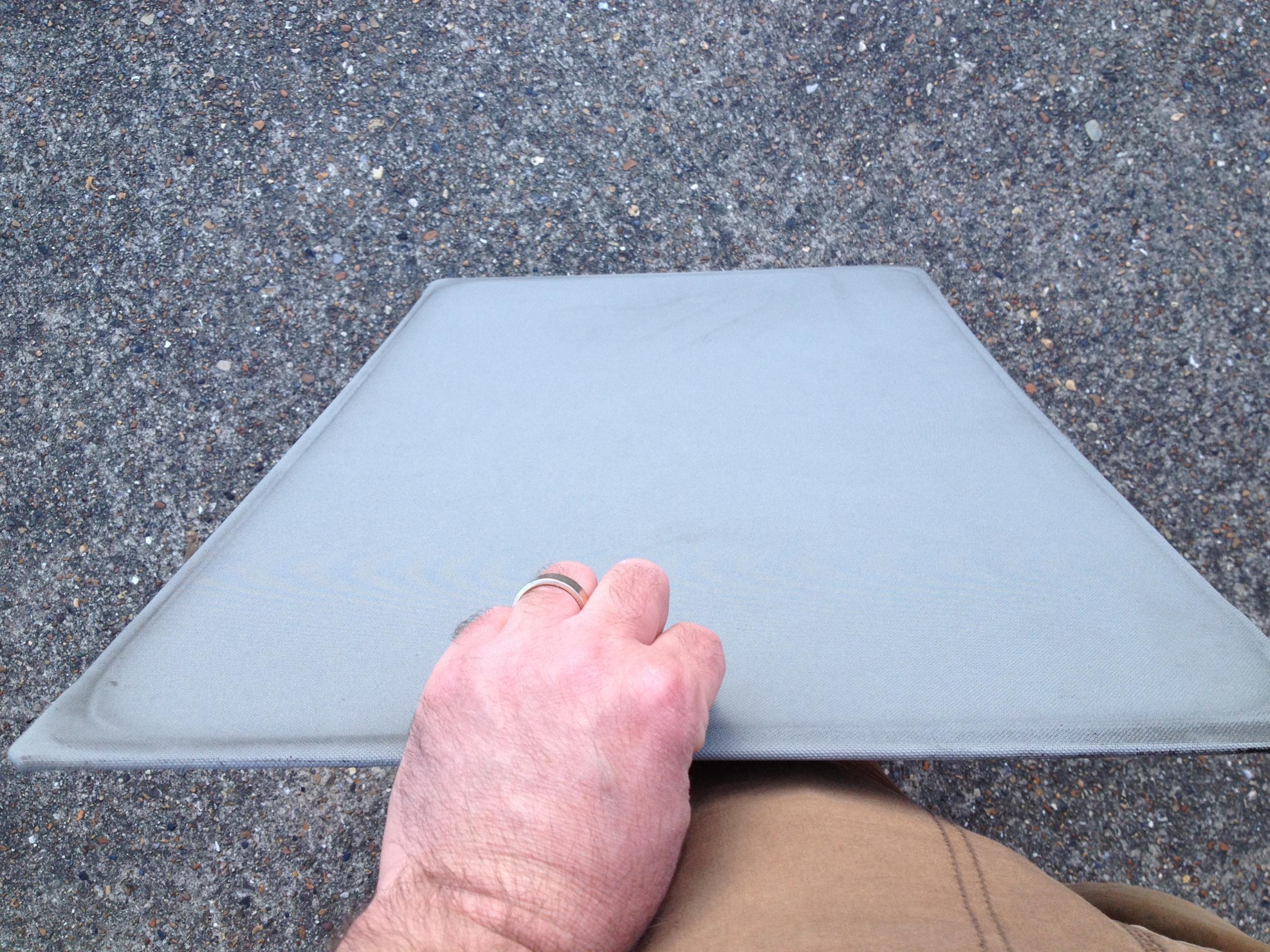

What colour is your rooflining? I've got a spare one from a solar sunroof I bought to go in mine. Both clips intact but obviously depends on colour. Can put a pic up when I get a chance

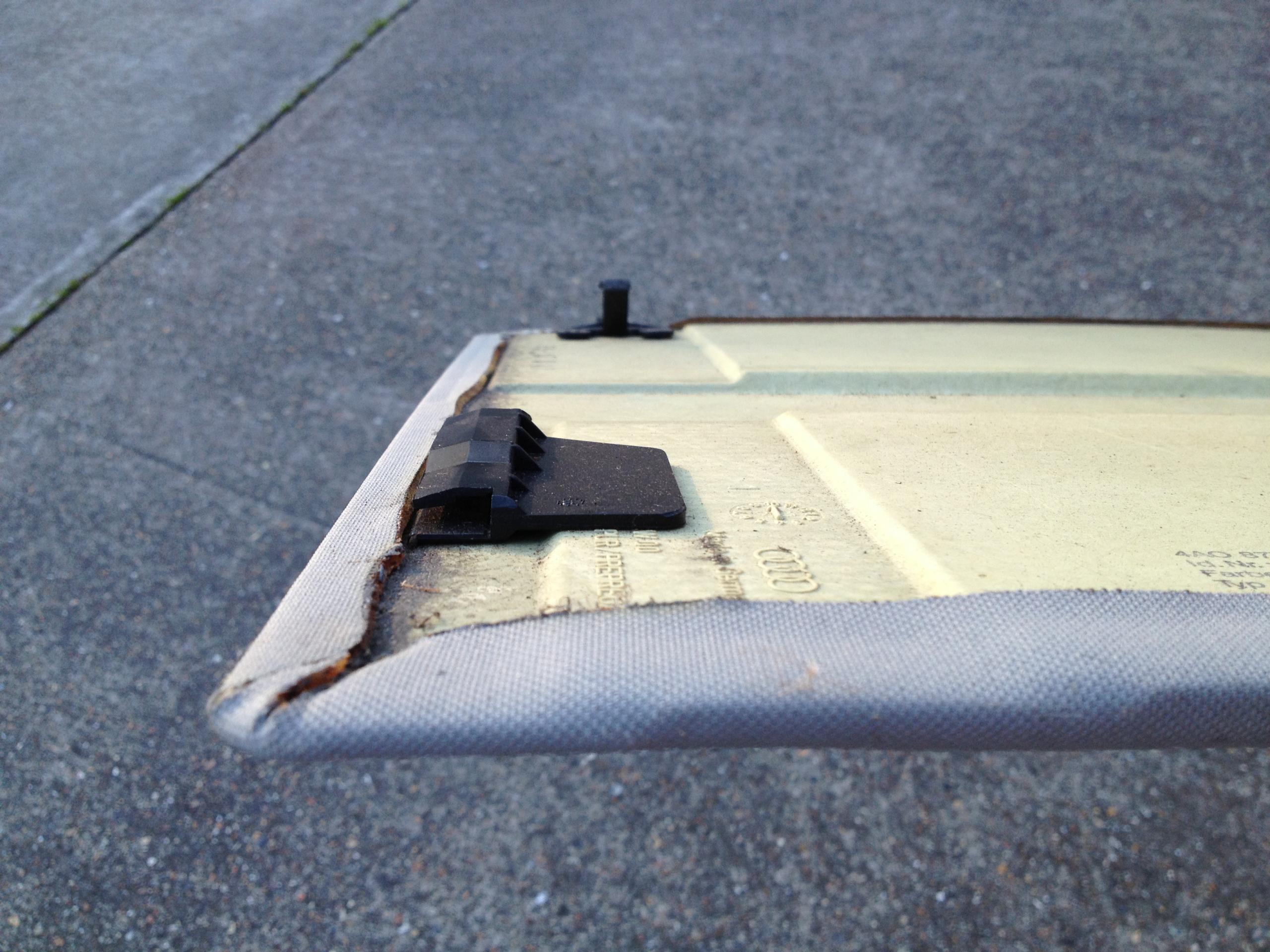

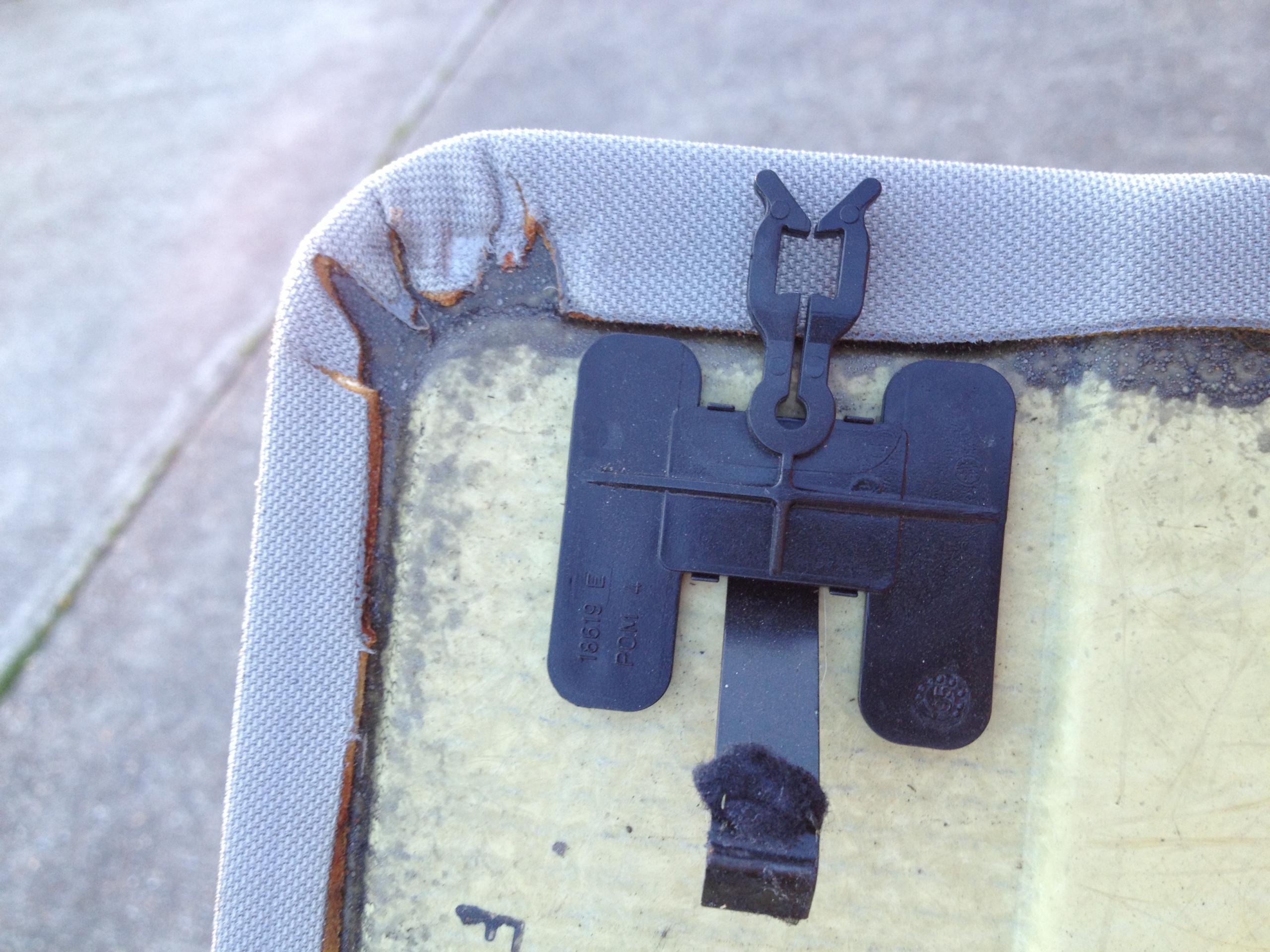

Here's some pics of my spare in case it helps ID what's missing:
They're very easy to remove - open sunroof a bit, release clips at front, put tape over the exposed fittings to stop them clipping back in, tilt roof up and withdraw panel through the gap - it just slides out.
Mind you mine was removed with the whole sunroof installation out of the car!
