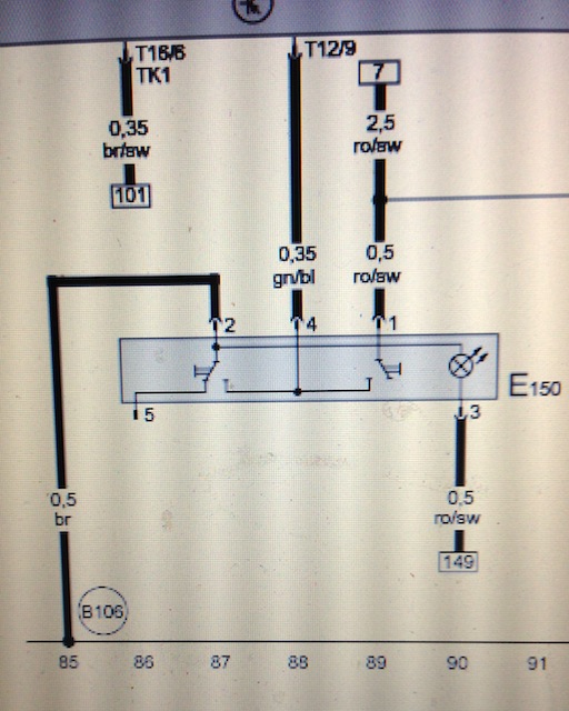

Here is how the button works in my car:
There is a wire going directly to central locking ECU and the switch connects ground to that wire if we want to unlock the car or it connects +12v to the same wire if we want to lock the car.
Do we have an empty pin in your central locking ECU where we can connect a wire and a switch? I don't know.

thanks. the diagram helped me understand a bit more. i will have to check the ECU for a spare contact. where would it be located?
i have tried to wire the switch into the same wires that the lock would use to lock and unlock the car when you open and close the car using the key and it works fine until you plug the wires back into the lock then the switch no longer works.
