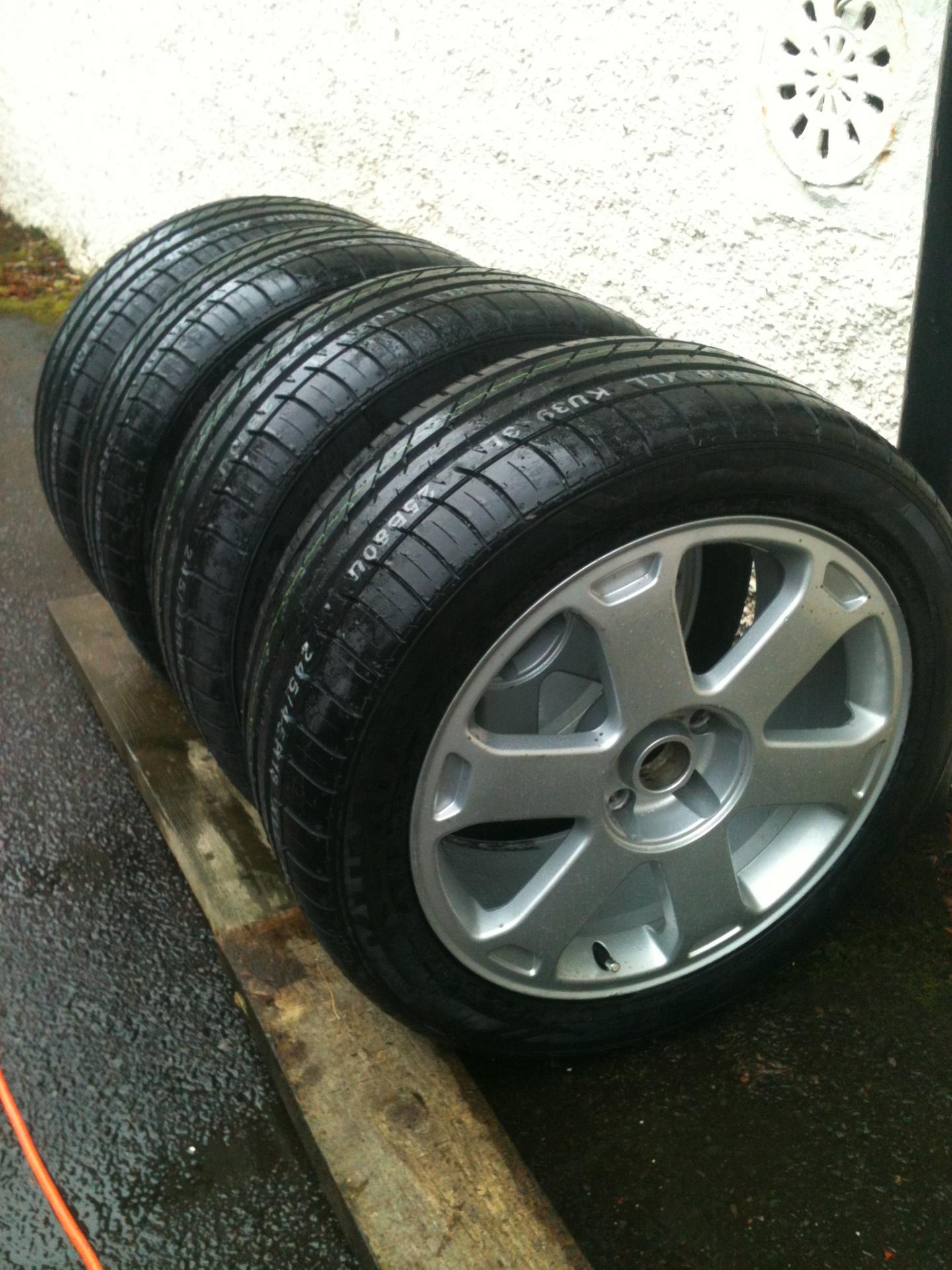

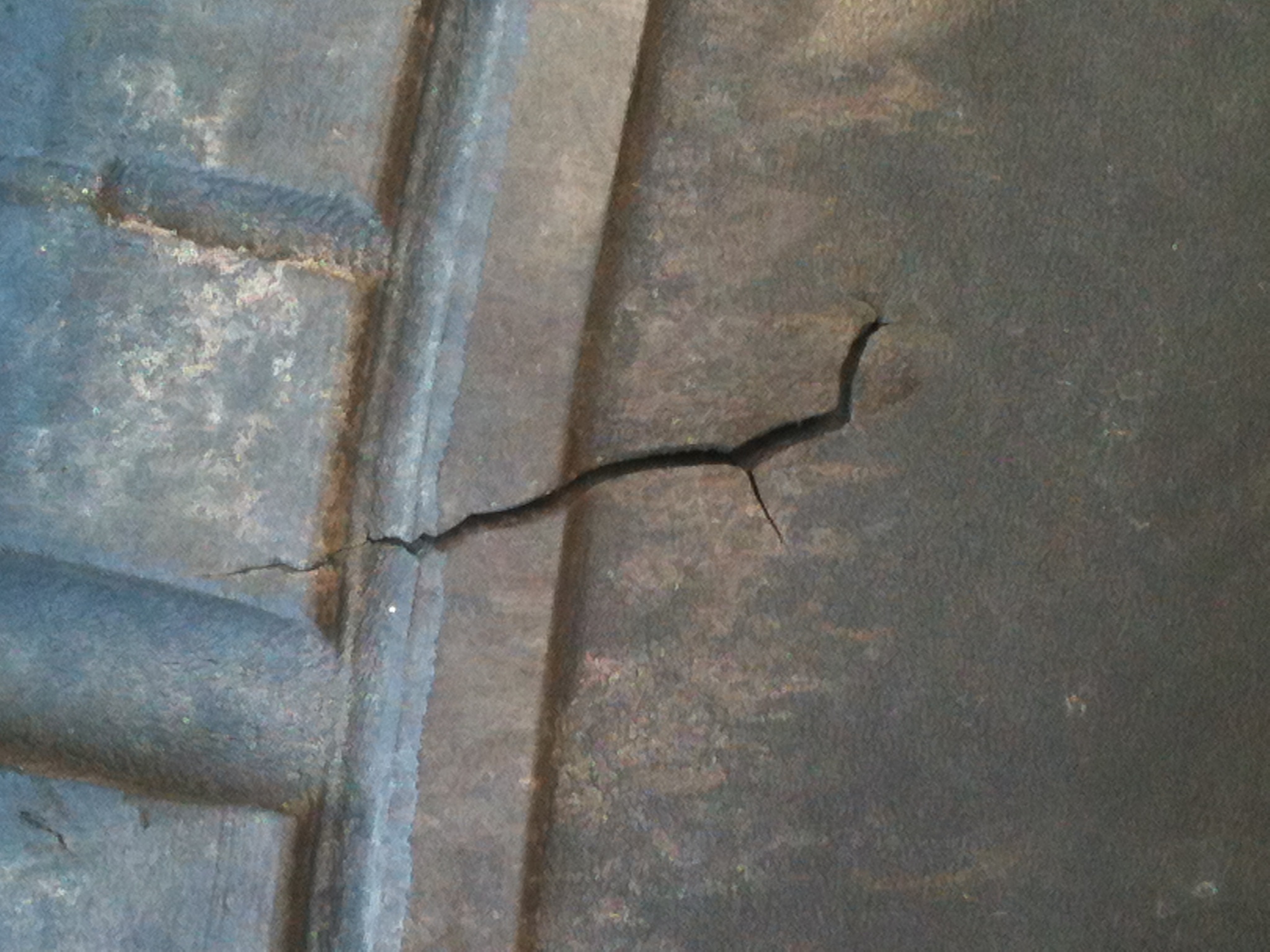

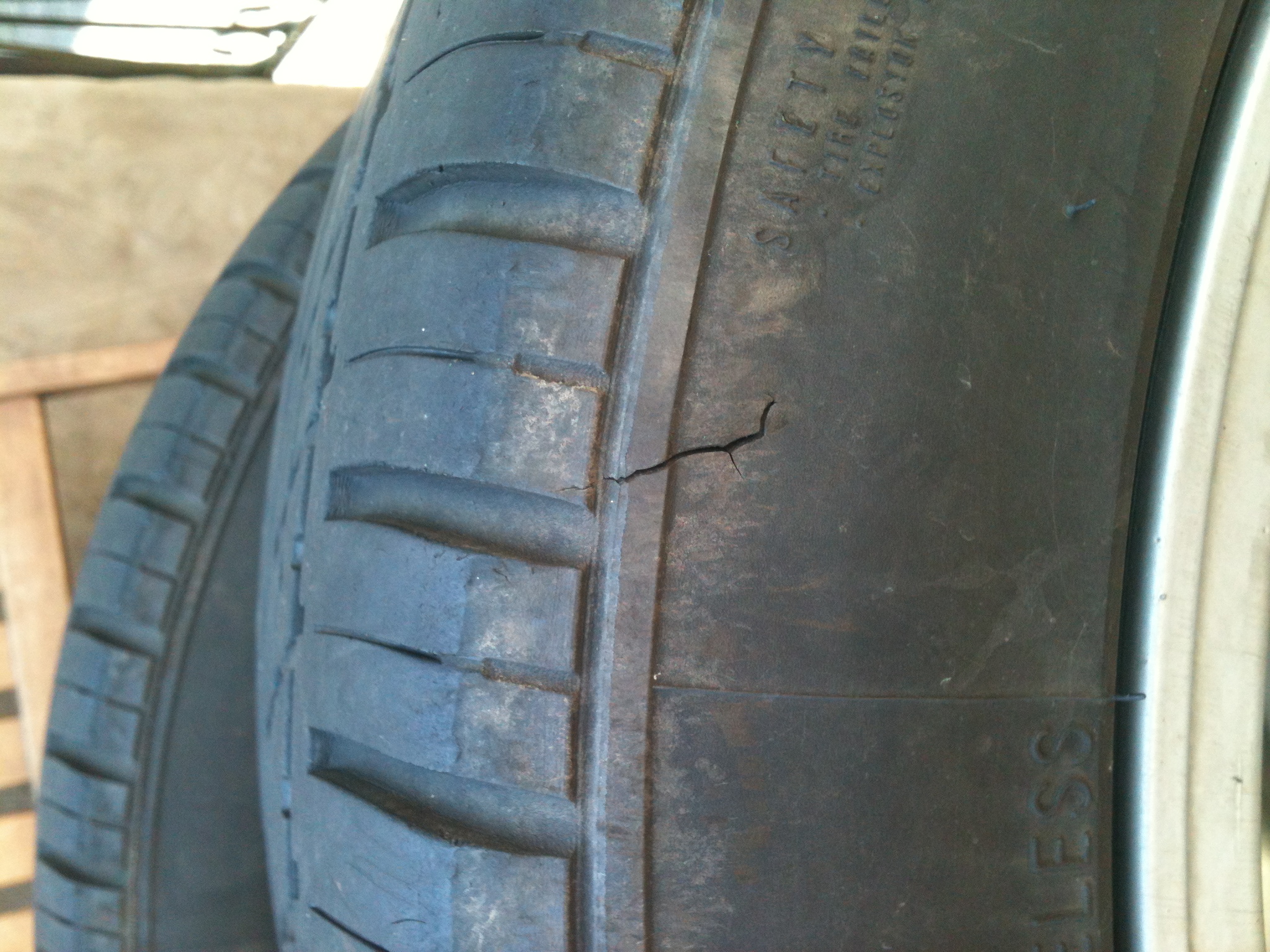

On removing all 4 wheels for my various brake issues (see other thread) I found that the inside wall of three of my Kumho KU19 tyres had splits. The splits looked like tears rather than cuts (see photo). Two of the tyres were about 2 years old and had 5mm of tread and both had splits whereas of the other 2 (approx 3 years old and which had 3mm each) only one had a straight split high up on the wall. The photos just shows one of the tyres but the other tyres had similar damage. I took them back to my local tyre guy who after much discussion with Kumho agreed to replace all 4 tyres with kumhos at £69 a tyre inc fitting. If I had wanted to change tyres they would not have offered a bean. So, whilst it was another unexpected cost, I thought I was going to have to change at least two of them anyway so it didnt end too badly. JUst another few hundred quid to add to the thermostat failure/timing belt+pulleys/output shaft seal/exhaust repair/rear brake caliper refurb undertaken over the last few weeks!!
