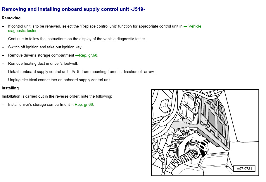

Old 25th January 2016, 09:29 AM
Location: Norwich & L'viv
Posts: 1,679
Matt
Old 25th January 2016, 10:29 AM
Posts: 1,679
Hi Borys,
If all is fine with J519 (09 - Central Electronics) there maybe a fault with the wiper motor control unit J400 or wiring in between. J400 is a slave from J519 and controlled via LIN. The physical wiring between J519 and J400 is from plug C (that's the 32pin connector)
J400 is one complete unit with the wiper motor. Have you replaced this in the past?
Matt
