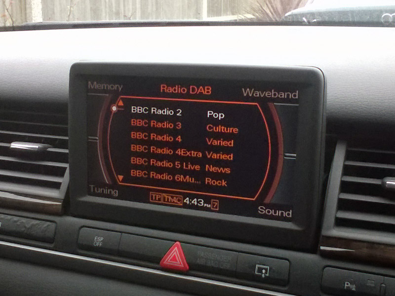

Hi mate. It's on the info bar at the base, number '7' in my picture attached.
It may need to be selected via the green menu. Let me check and I'll post back.

Yes, just looked, it's in the green menu > Tuner > Tuner Settings > Show DAB Quality Level, where you can tick / untick it

Cheers I’ll look for the green menu. Think my MMI screen info at the bottom is different to yours, my BT phone shows up there where your no.7 is.

Within the green menu > tuner section there is 'DAB Tuner Quality' which displays these fields,
EID
SID
Sync
Freq
FIC
MSC
EECC
SCID
Mute
Label
Qual
I guess we could post our results so we can establish baseline for Ray. I'll post mine once I'm back in the car.
