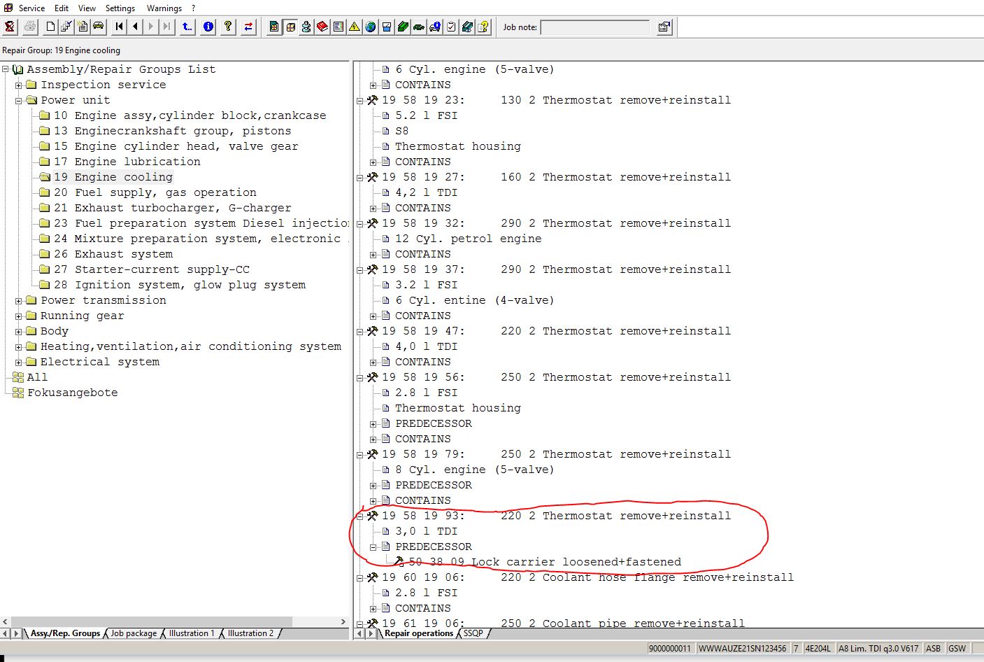

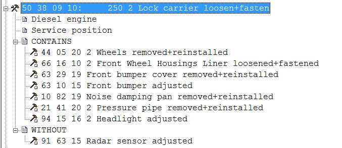

Old 9th March 2016, 08:18 PM
Where do you find the time to do the job info?
ElsaWin
Here are the screen shots from Elsa, 1st shows thermostat remove reinstall time 220 labour units. 100 labour units = 1 hour, it also show predecessor - work that needs to be done before that and not included in time allowance. 2nd shows time for lock carrier loosening and fastening 250 units
ID:	12665   Click image for larger version

Guys; thanks for your comprehensive replies.
Wow, that looks like a large job for a £30 part and shows my dealer's quote of 4 hours was very reasonable guess of the time involved.
