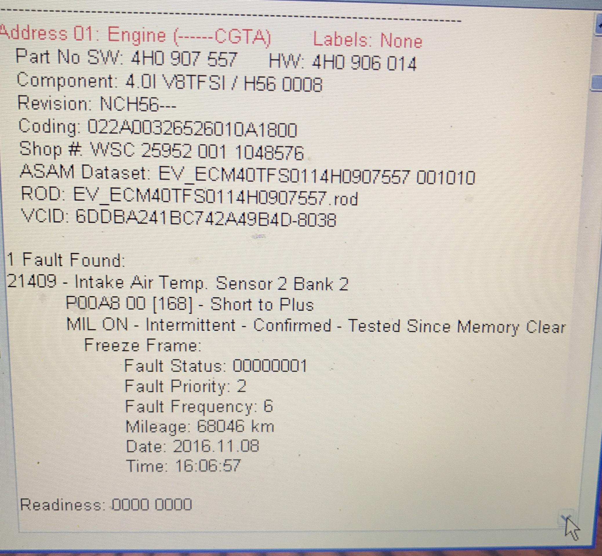

Hello guys. I have a issue with the intake air temp sensor on my Audi S8 2012.
Does anyone know where is located, as i can't find it ?
Thank you !

Had a quick look for you.
Theres three temp sensors, two just after the throttle bodies, and one in the Bank 2 inlet manifold.
Bank 2 is the passenger side of the car looking at the engine and your fault says sensor 2 on bank 2 so I would take a look at the G42 sensor that you can see on page 58 of the attachment.
If you go to page 376 of this you'll find instructions on how to remove said sensor.
Part number for the sensor is 079919501F and is around 45 quid without discount.

Excelent ! Thank you very much, i will give a try tomorrow. i did tried to reset it with Vag but it comes back after 20-30 miles.
I will let you know the outcome and post some photos as well )
