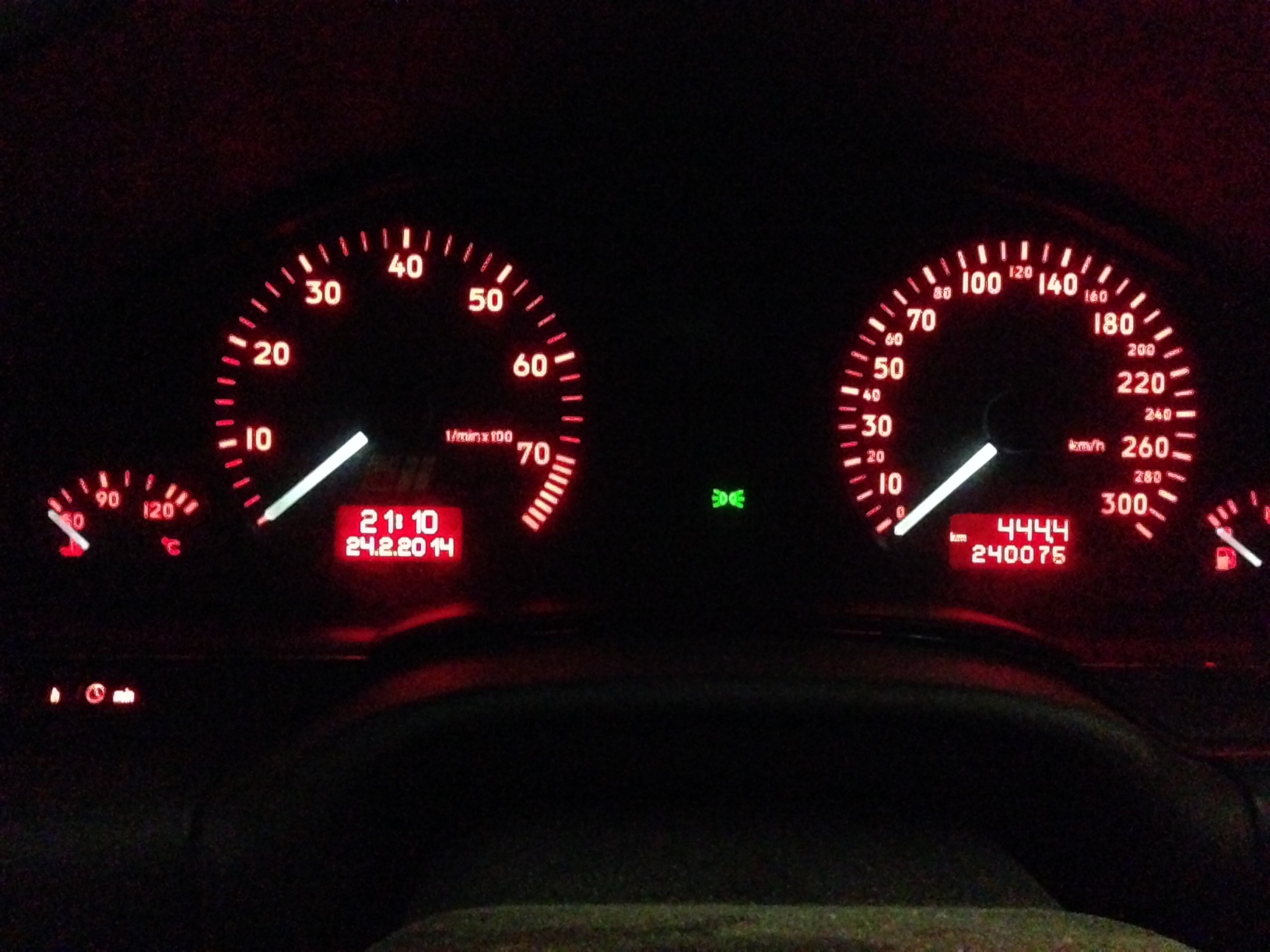

240075 km = 149175 miles

Is it cold? Mine fades out below about 7C?

aah.. Didnt think of that actually. The DIS works fine(ignition off in the pic)
If it was only that easy...
Seems the fuel pump is preset to die at apx 150 000 miles on most 8's
