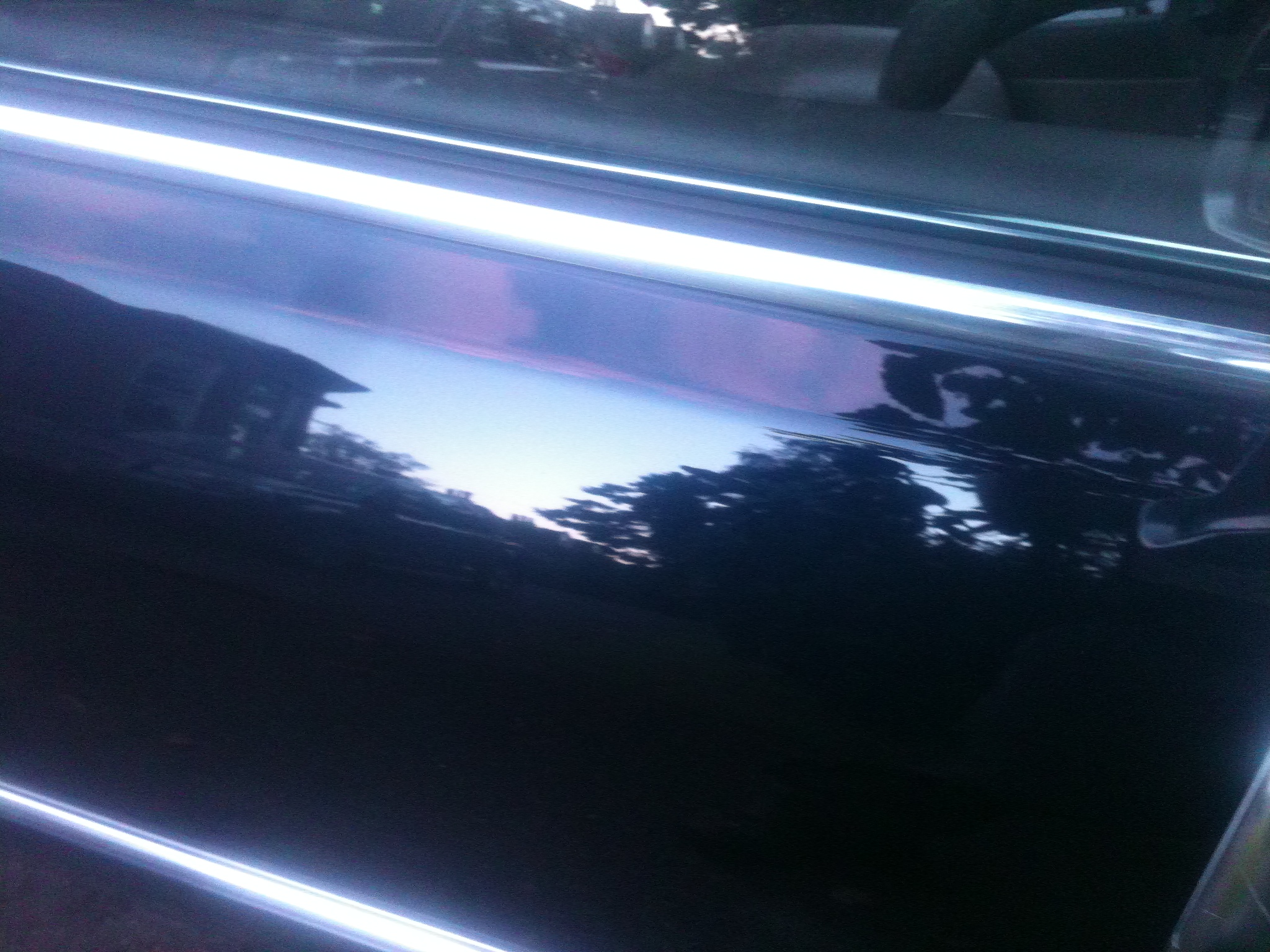

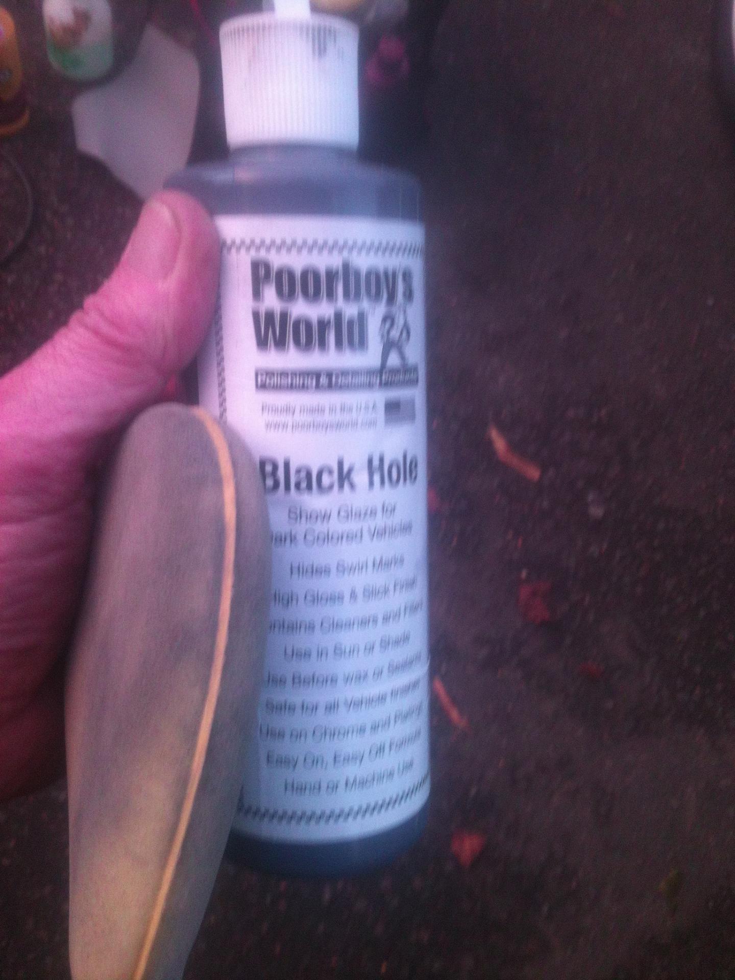

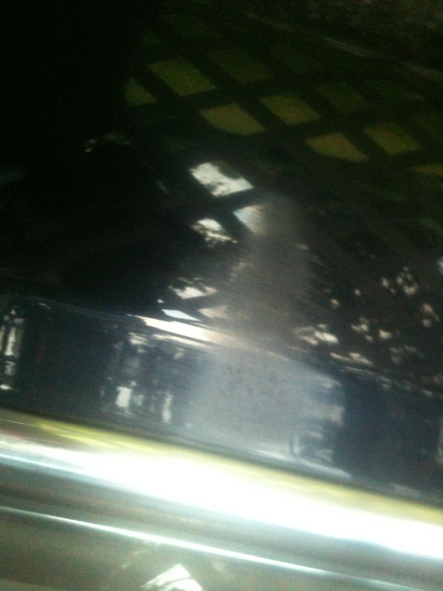

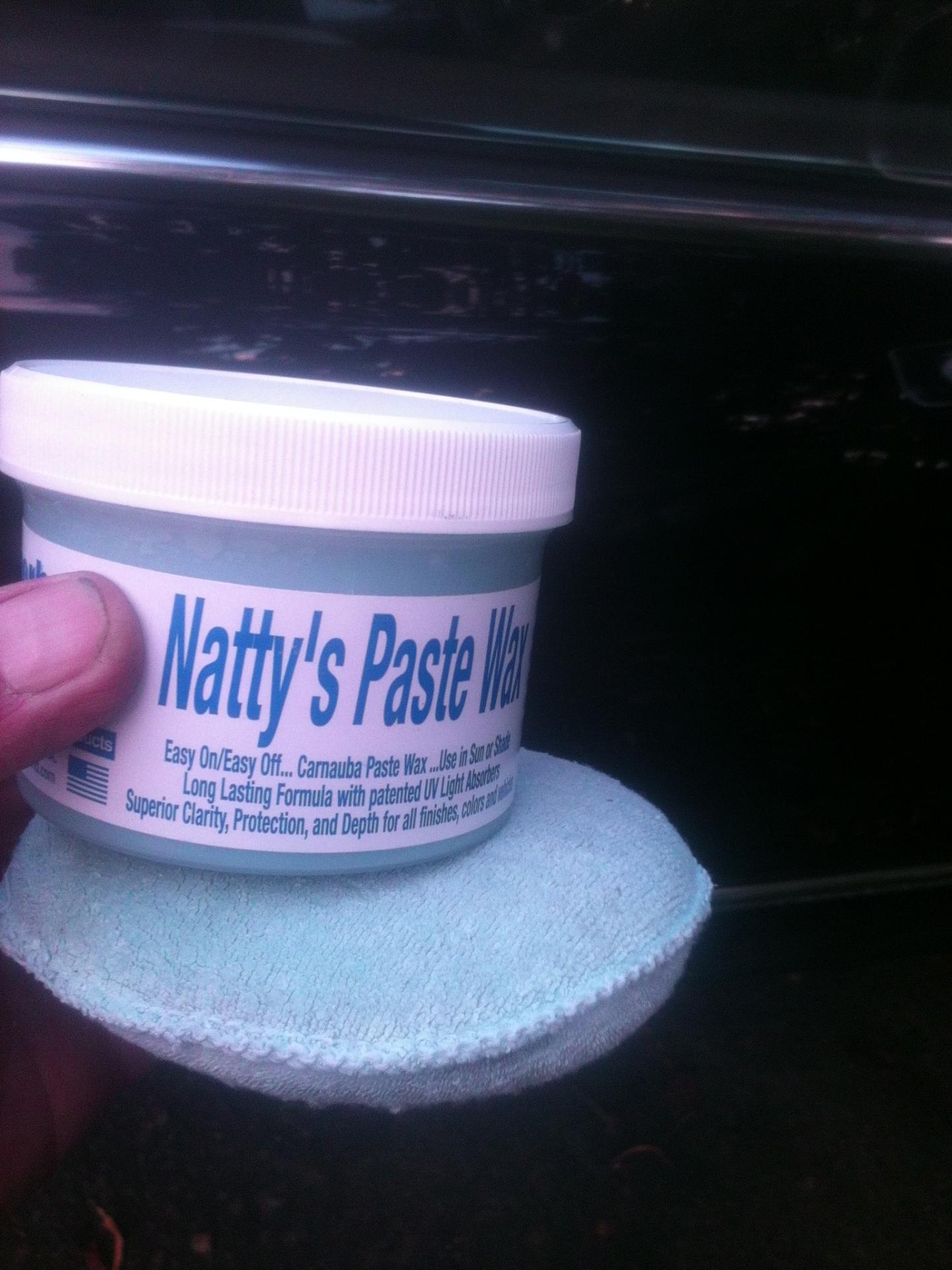

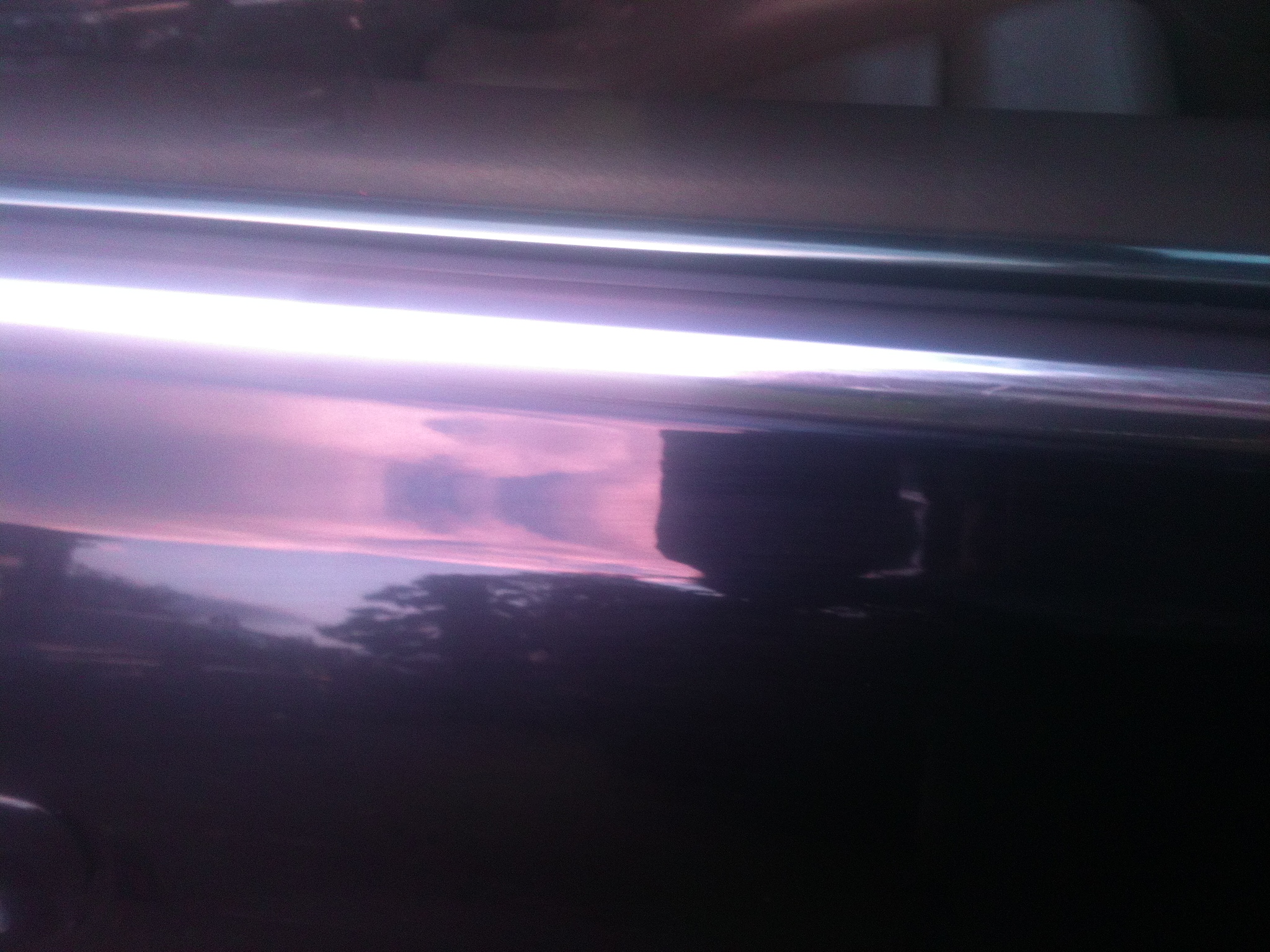

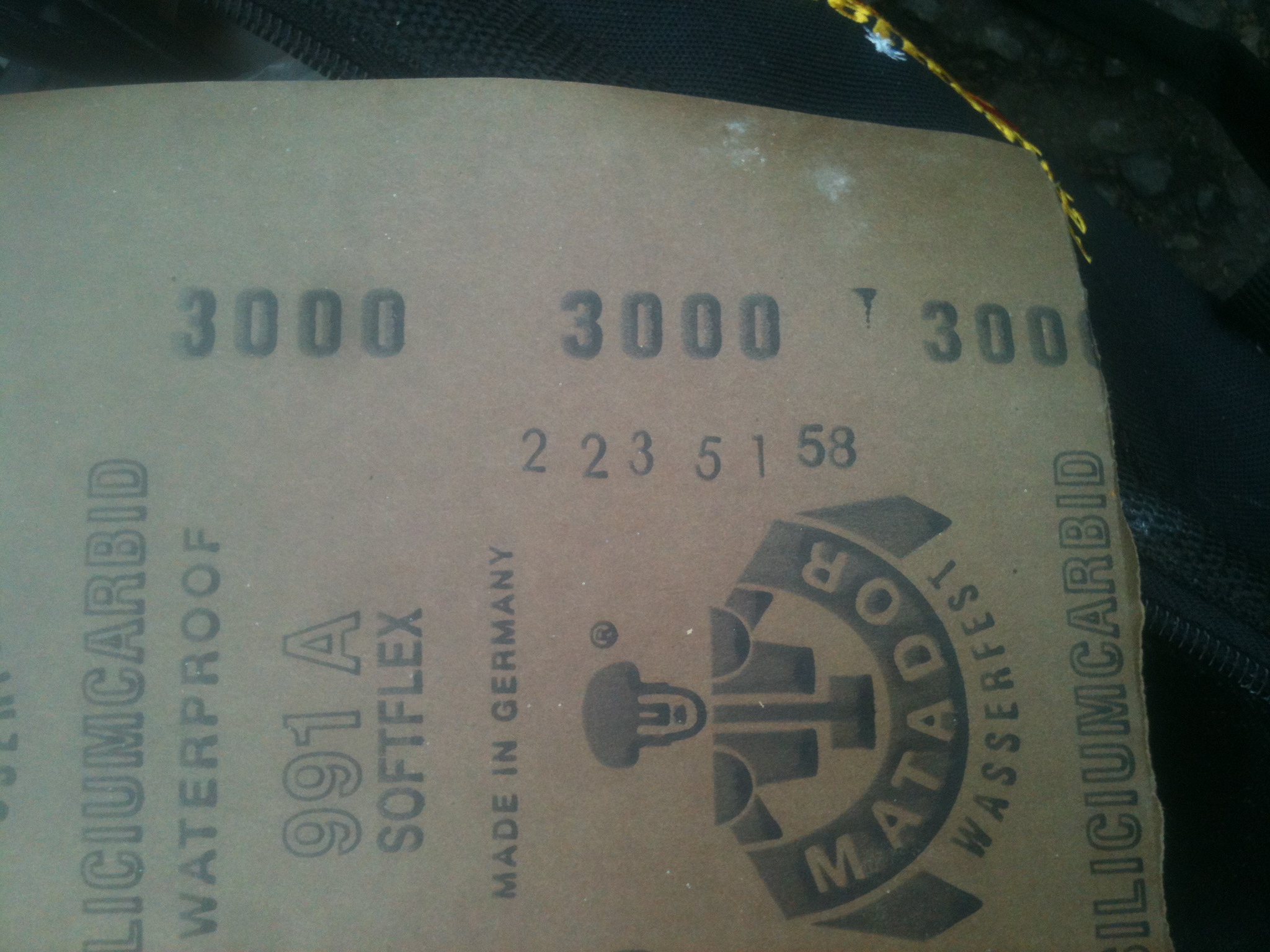

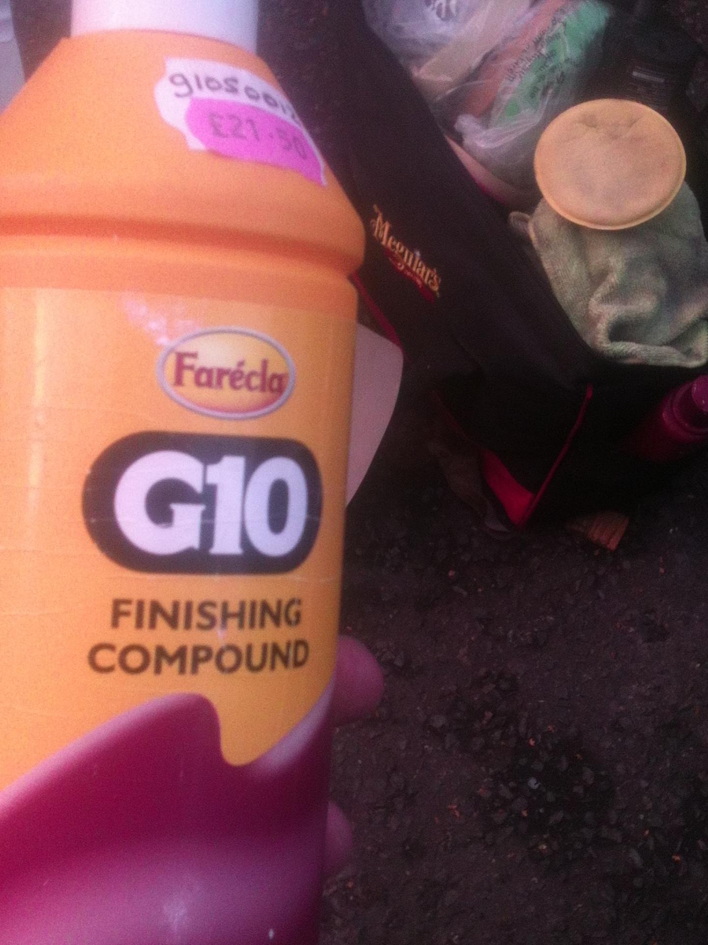

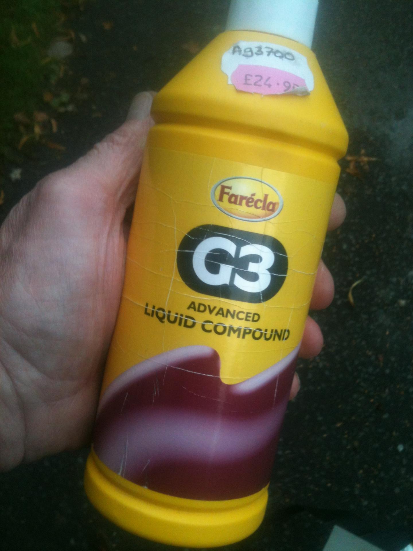

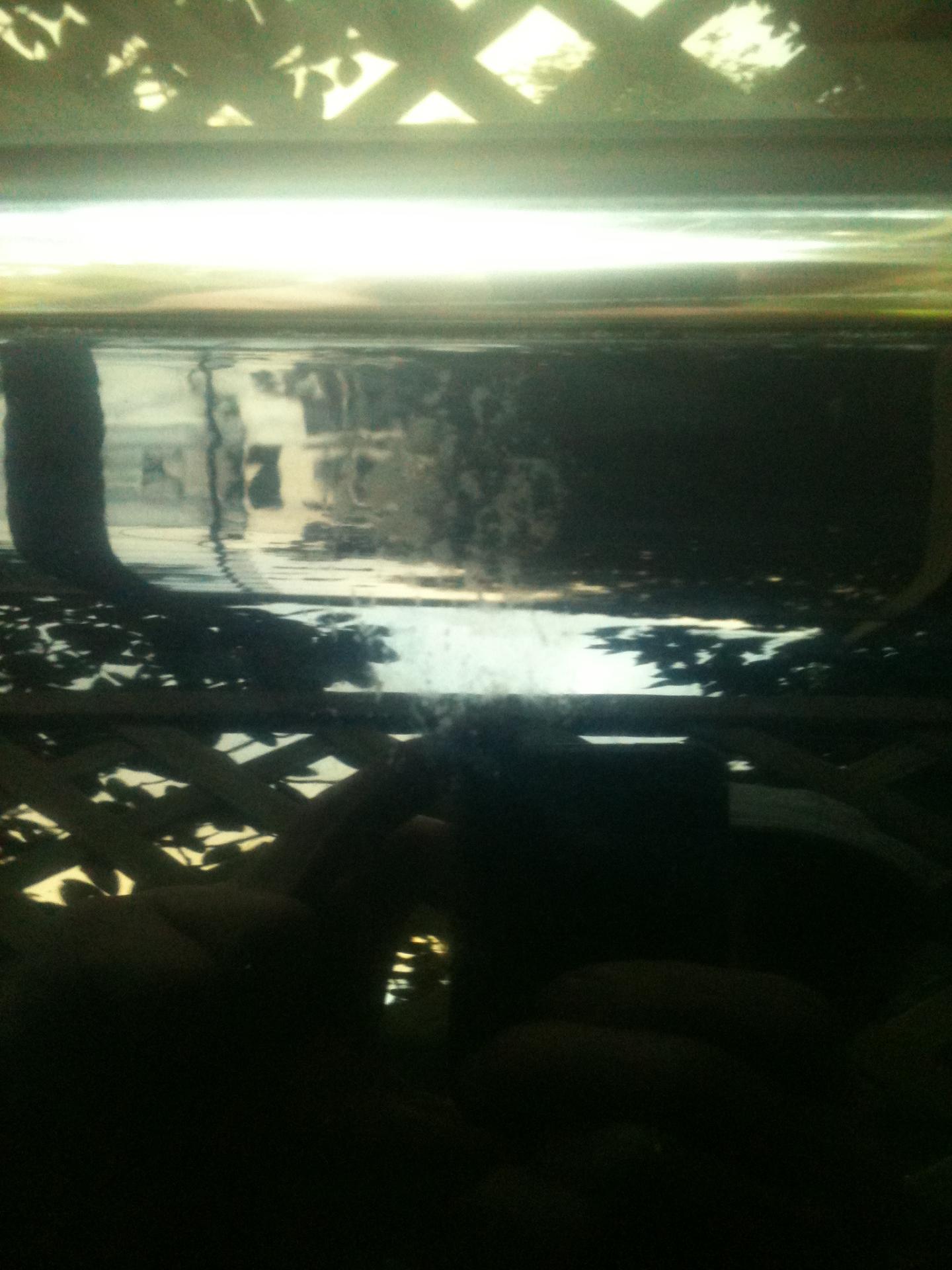

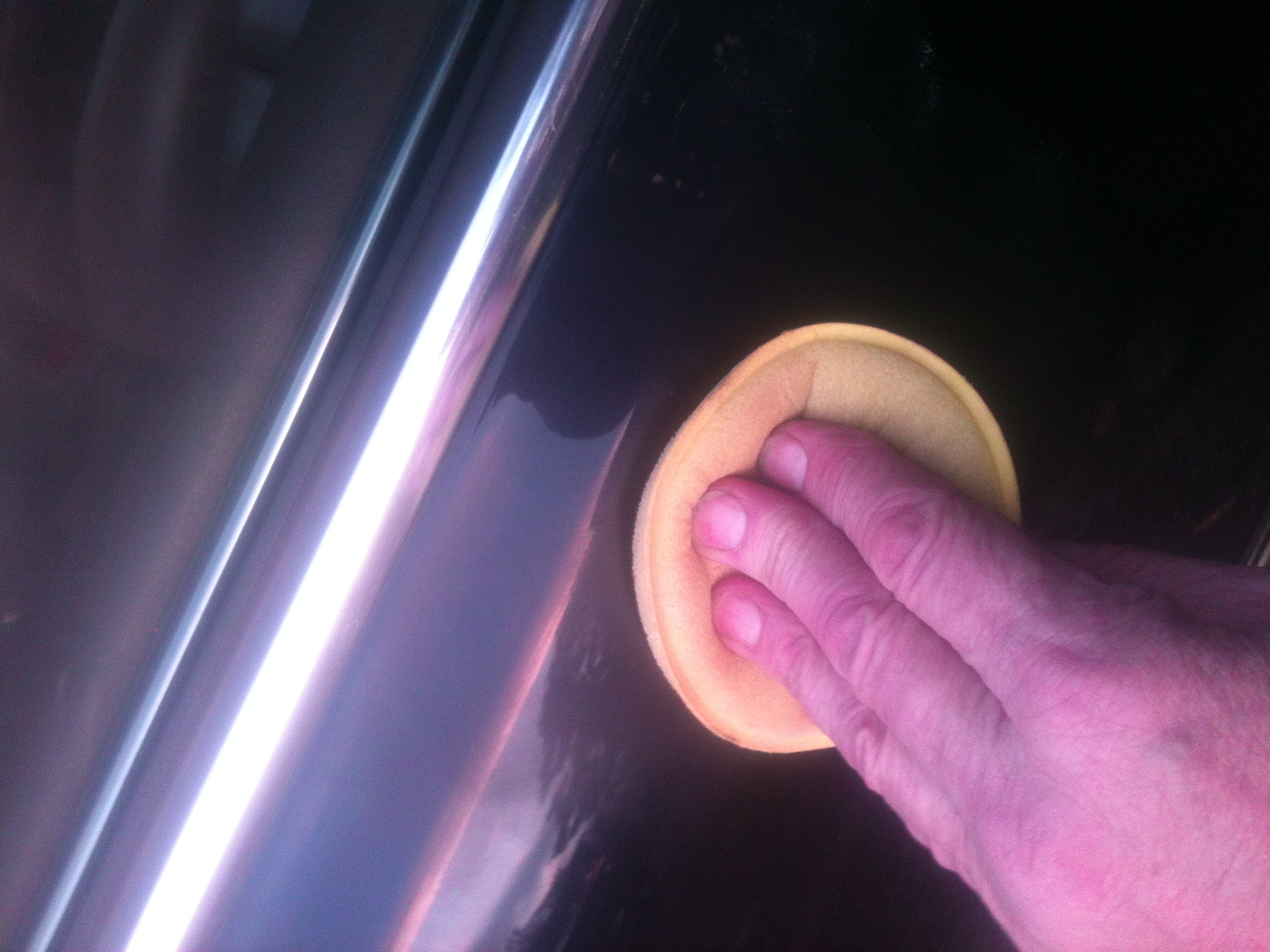

One of the problems of living near the sea is the frequency of ****ehawk attacks. As bird cr@p contains uric acid unless you get to it quick, it burns into the gel coat. I was too late getting to one on the drivers door and despite giving a good going at with the DA polisher with Fareclas G3/G10 two weeks ago it was still there. So today i resorted to good ol' wet and dry. Gentle rubbing with some 3000 grade got rid of most of the mark (and some of the gel coat!) before some G3 using a small hand pad, followed by some G10 applied in similar fashion. Some Poorboys Black Hole glaze and Natty's paste wax and all was good.
Photo 0292 shows the mark although its hard to see in the reflected light. 0302 shows the end result.
