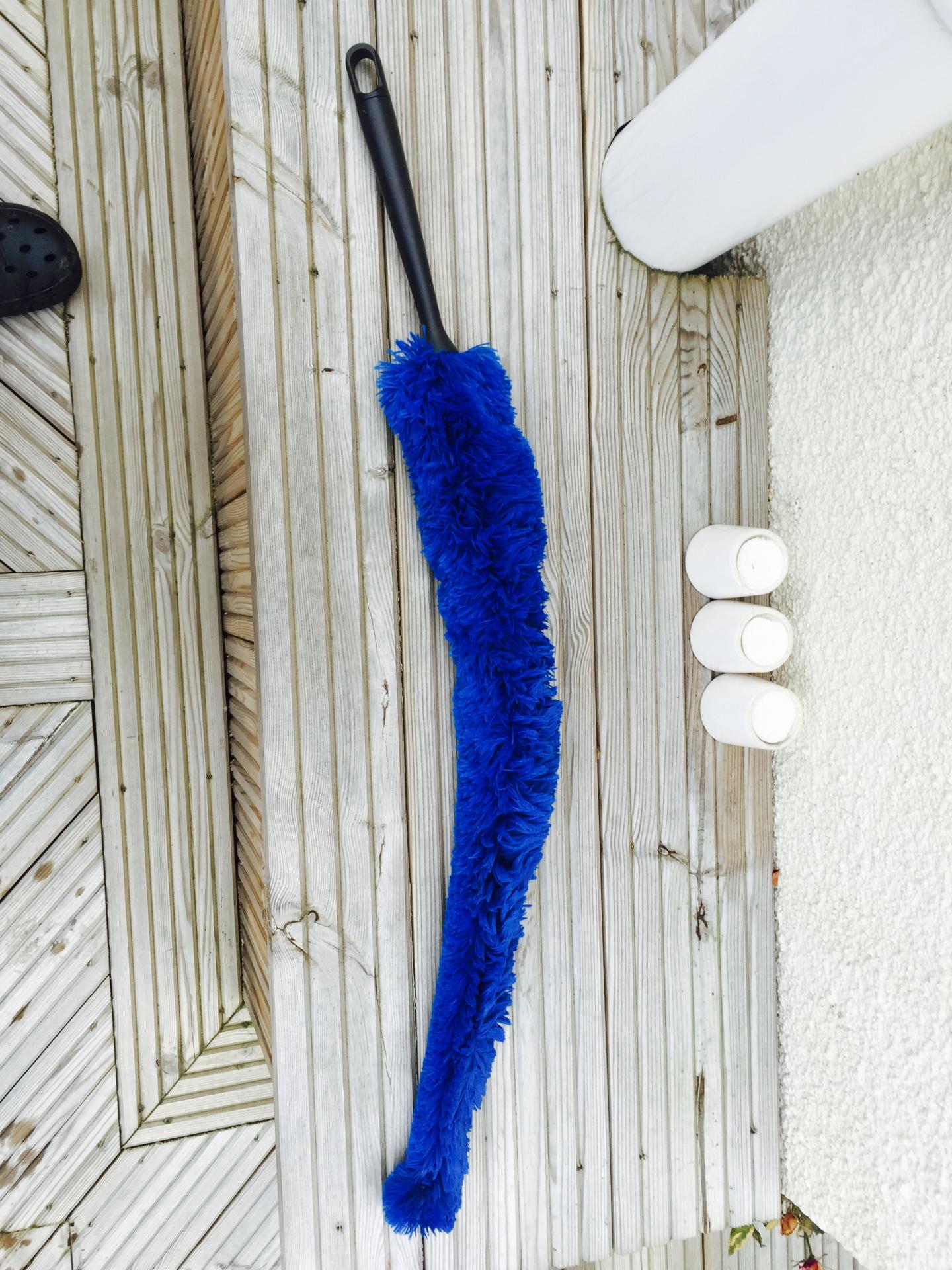

So today I decided to attack the scuttle with a different approach, the missus had a long thin brush kicking about under the stairs that's never used so I thought I would give it a go. It's very effective as the leaf debris and stuff sticks to it and gets pulled out quite easily so using that I went at it with the brush and Hoover for about 40 mins till it was clean.
The brush was most effective going in under the plenum from driver side, and the Hoover detailing attachment was best in the passenger side down through the heater hoses.

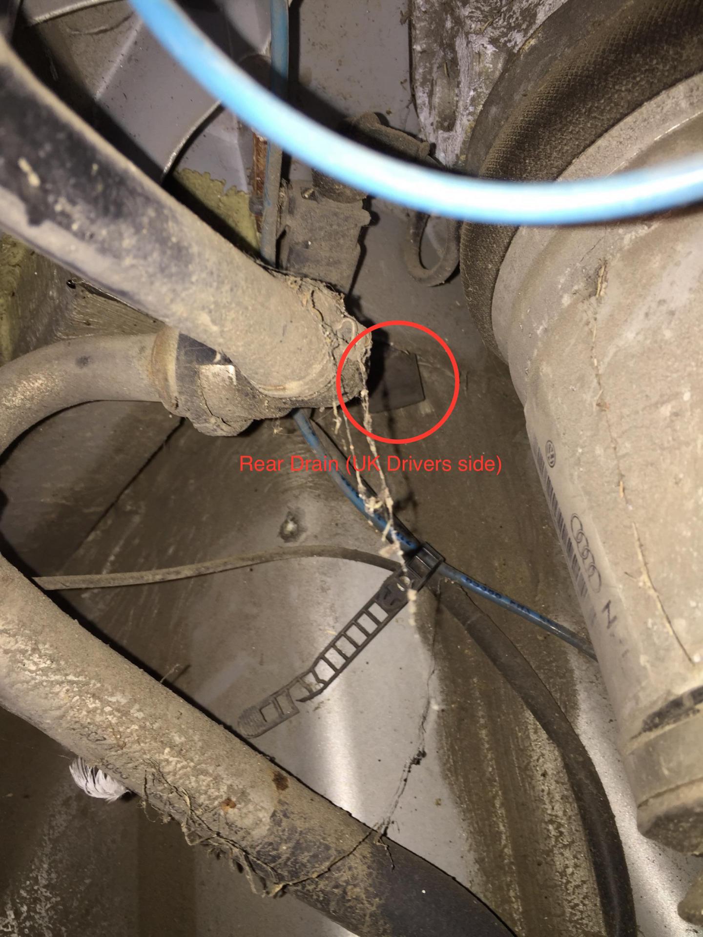

Thanks Neil, took on the challenge today. Managed to get access to both sides. Assuming I was looking at the right things then both rears are clear inside the arch. So I added some water, and after all that it looks like the drivers side front is blocked. I have a photo of the outlet to add, in this picture the rear of the car is on the left of the picture.
Interestingly the strut on the drivers side rear looks like its been replaced at some point, the black ball part on the drivers side has less corrosion than the left.

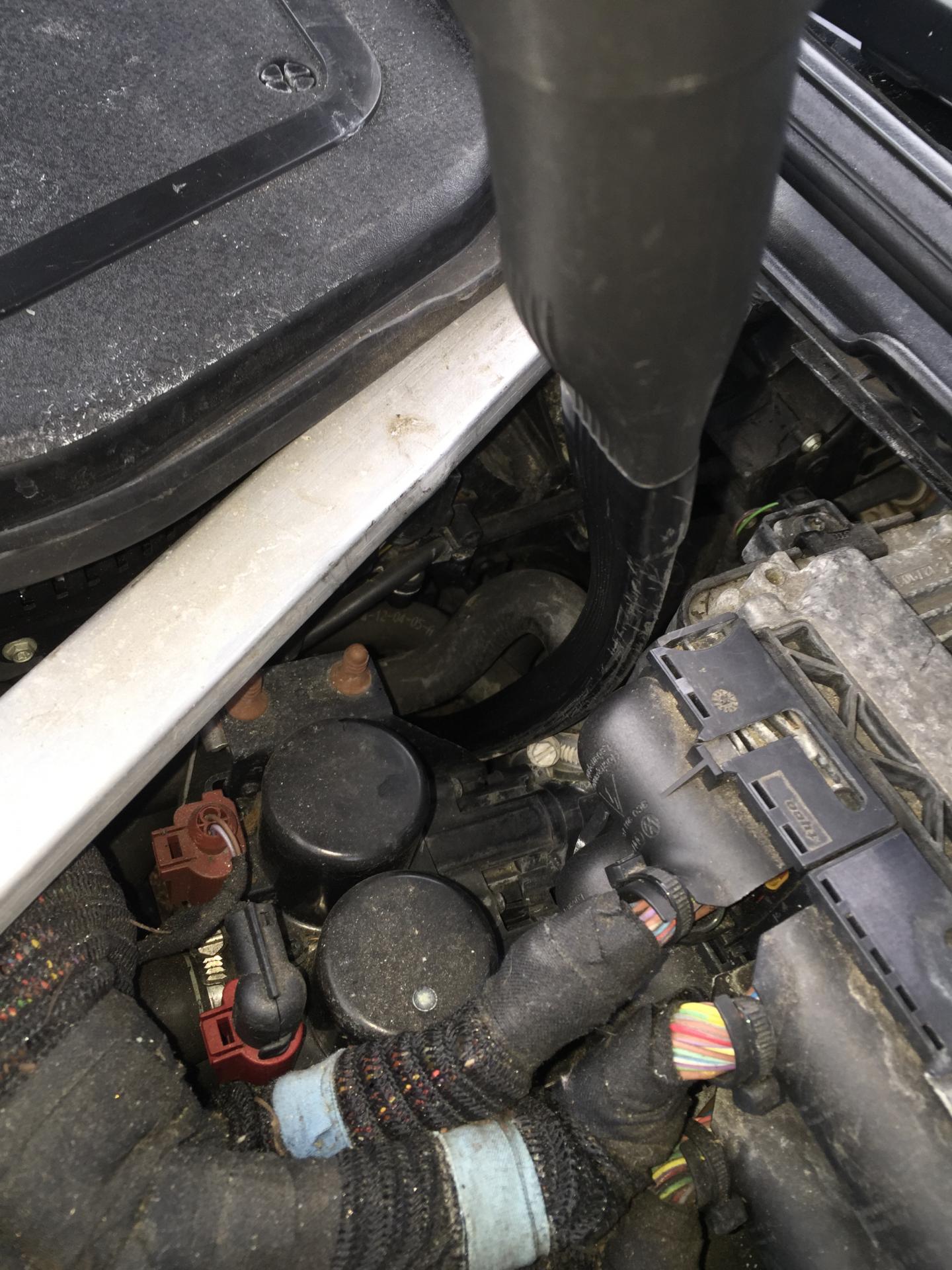

With the scuttle covers off I have since found you can actually see one of the drain tube pieces on the passenger side of the car.

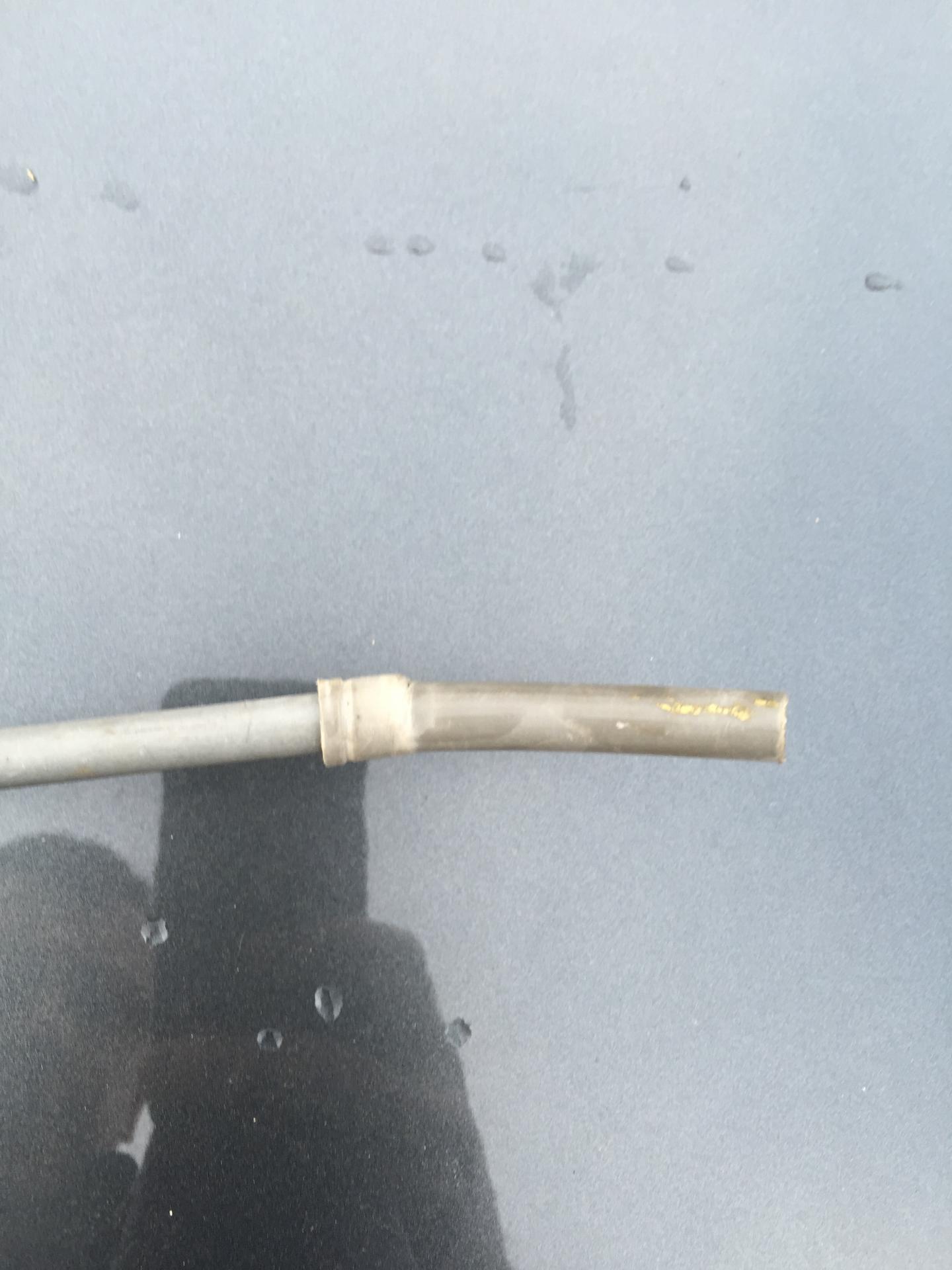

I then used my trusted bug spray tool that i made up for the sunroof to jet some soapy water down the hole and clean it out.
If you look in from the passenger side there is a couple of hoses and valves next to pollen filter box and if you go in through where i have in the picture you can move the hose down enough to see the drain hole.
Then you can manipulate the end of the hose down the hole and flush it through.
