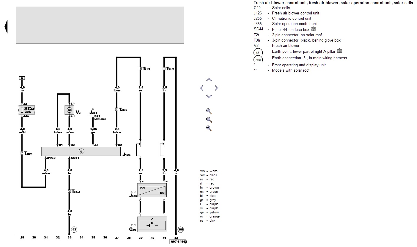

My current normal glass sunroof is having issues shutting, it won't shut on its own at the moment, so I'm going to use this as an excuse to replace it with a Solar roof.
I've been trying to find some information on how to wire this up and what components I need but struggling to find anything via the google or ETKA.
I found this link for a 2004 S6.
http://workshop-manuals.com/audi/s6/...ms/page_12942/
I assume its not a simple case of plugging the 2 cables from the panel directly to the havc or the fan.
Going by the above link there is a relay and a control module.
There's a Solar cell separation relay J309 and the Solar Control Module J355.
I don't have access to Elsa win at the moment but I can't find these relays on ETKA.
I'm wondering if the the relays and modules are built in to the cassette?
If anyone is able to shed any light on these parts of generally retrofitting a solar panel, that would be great.

Two wires, simples

Ditto Del's words

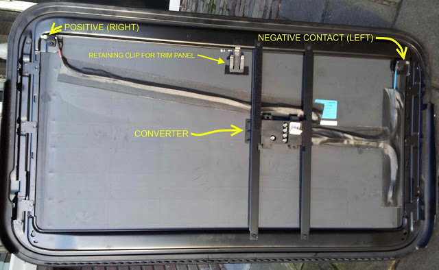

My main issue was finding the J533, I knew it was there but where it went and what it looked like eluded me.
Finding images of solar roofs that shows the underside does helps.
The J533 is part of the glass.
Thanks for the diagrams.
