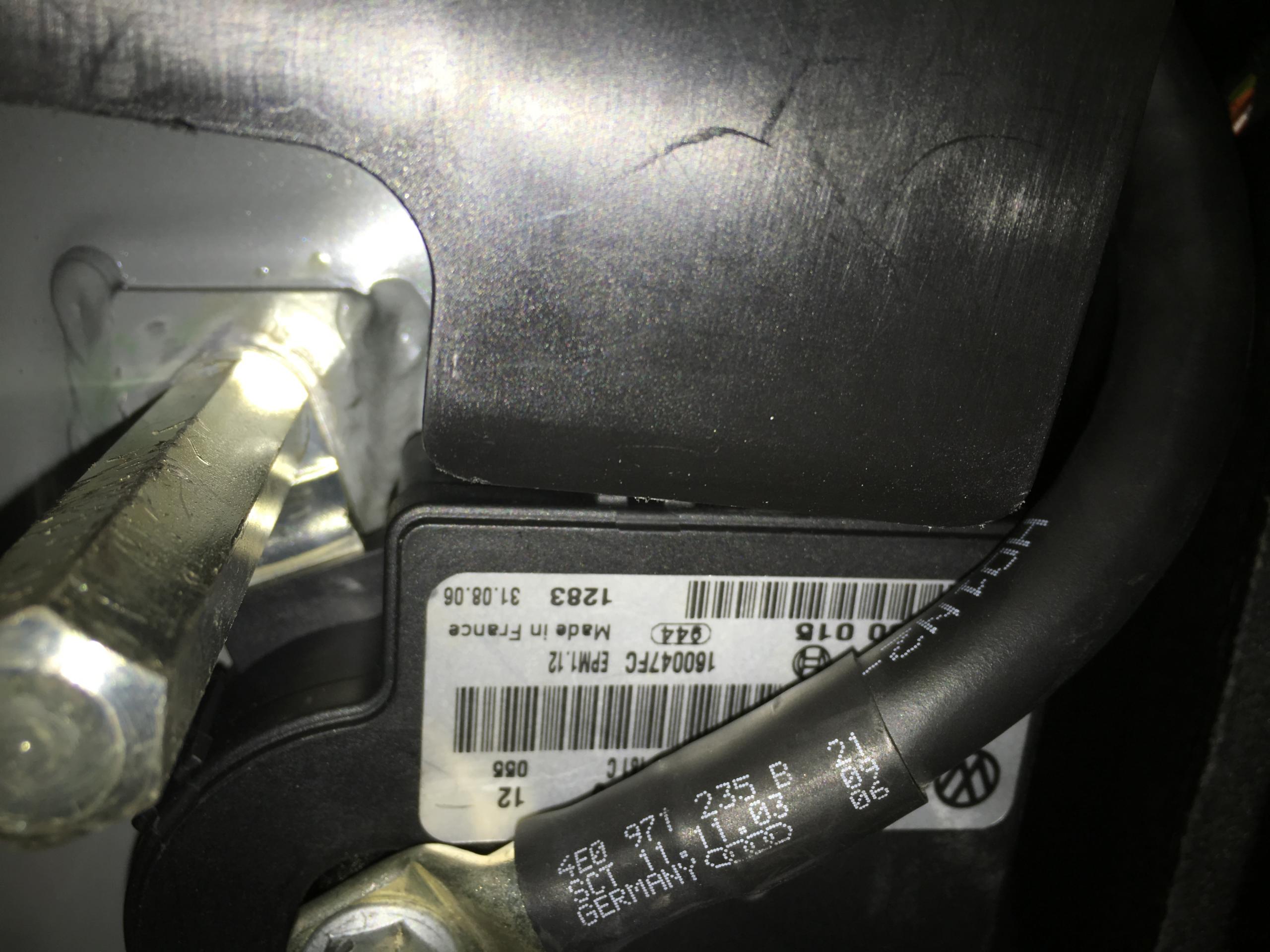

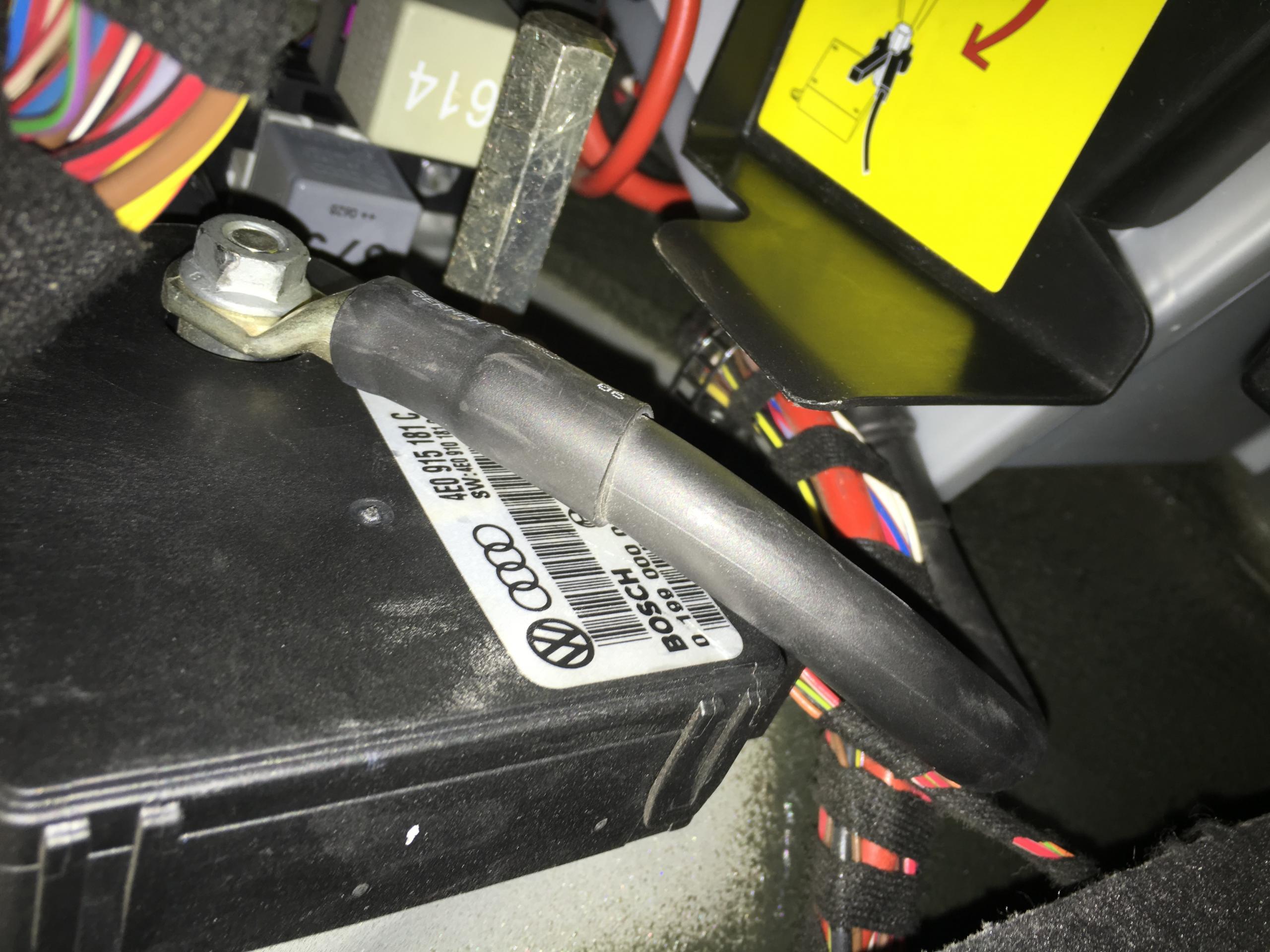

Old 17th February 2017, 07:00 PM
See pics
ID:	15677   Click image for larger version
