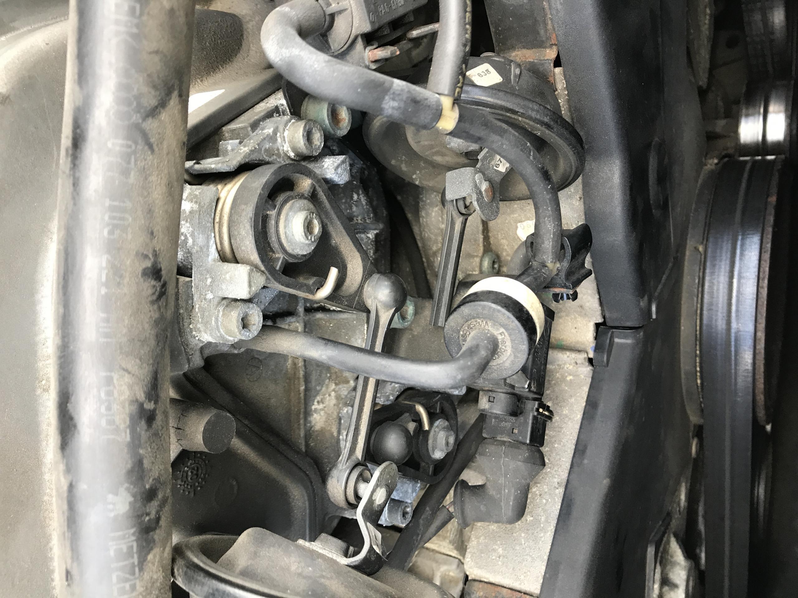

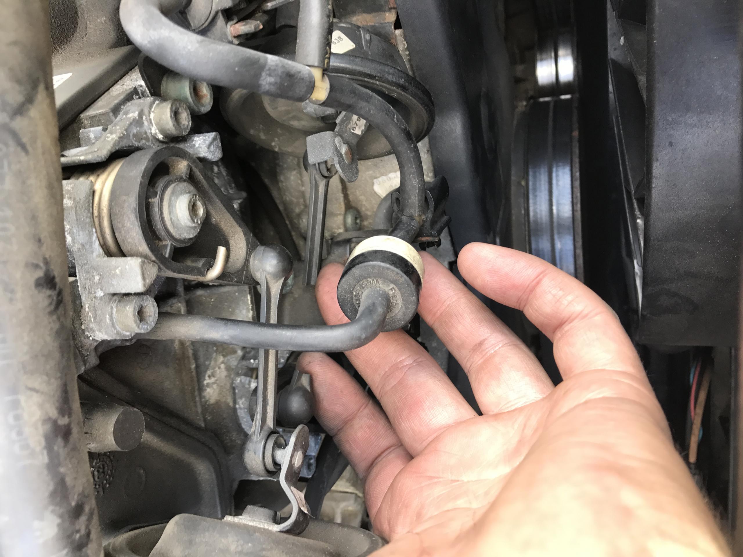

While I was doing some work in the engine bay i noticed one of the vacuum aculator bar is broken and noticed crack on the second one. What effect it has on the car and did anybody sourced replacement bars or a way to fix it? I just glued it together with a gorilla glue, I dont think is any long lasting solution.
I want to have everything tip-top so would like to get it replaced..
The bar is broken off where my fingers are on the picture..
Thank you all for ideas how to fix it.

Pretty standard failure, replacements readily available e.g. metal ones from Gruvenparts.
BUT FIRST check the flaps they move are free to move, the breakage may be due to the mechanism being stuck.
There are two lengths IIRC depending on engine type; yours look like the longer ones.

Thanks for speedy reply.. how do i check if they stuck?? If you talking about the rubber membrane that is moving easy and freely. I am not a mechanic but can do anything if i see it or somebody tells me how to.
Thank you

The other end from the membrane, the spring-loaded arm. Check you can move them both, may need some force but a hand should do it.
If one is still connected start the engine and observe the movement.

Checked the plastic spring loaded arm today, they move but you really need a force to turn it..no wonder the plastic linkage snapped. I ordered new linkage.Being shipped from the US so it will take few weeks to have the replacements in the UK. Thanks for the help.
