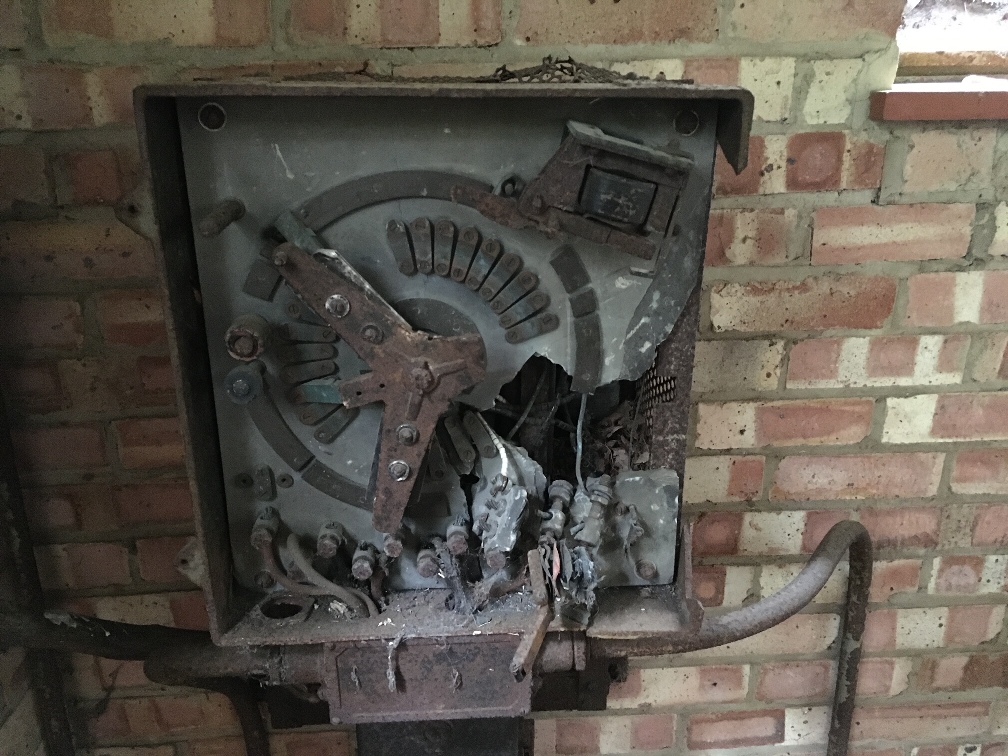

This strange object lurks in an old derelict building not far from where I live.
Does anyone know what it is? I reckon it's Audi's first prototype F125 switch....

Single phase electric motor starter switch.
Old 29th April 2021, 04:16 PM
Thanks Ray, we think the building was once some sort of pumphouse so that makes sense.
Out of interest how did you identify it and how (if you can describe briefly) does it work?

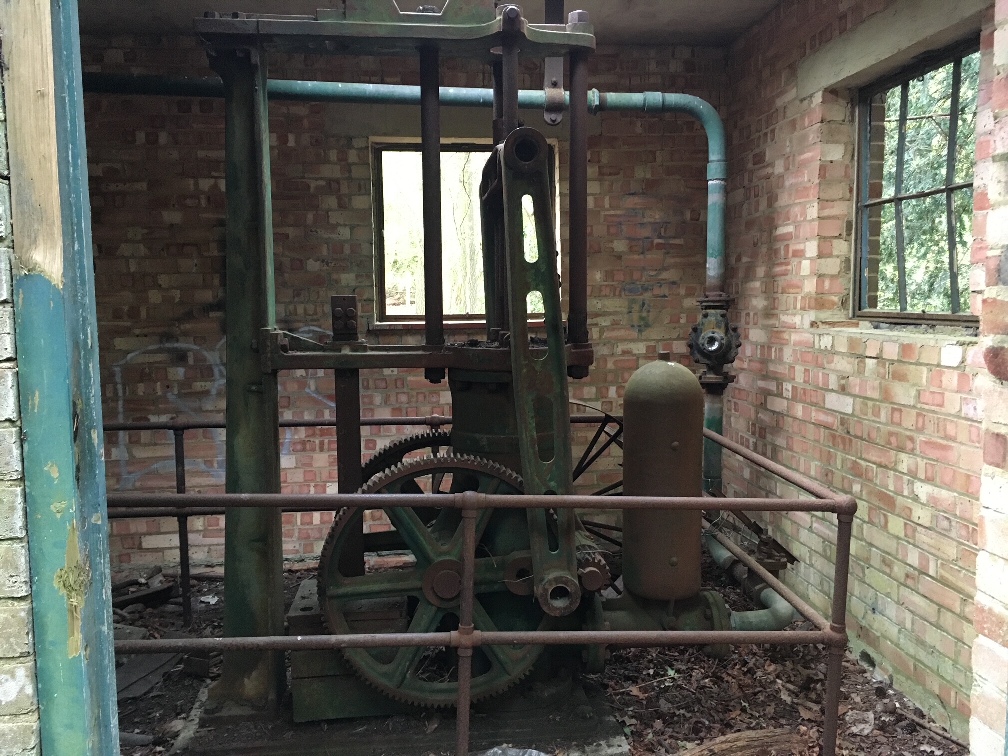

So a further challenge, this is the "pump" in the same building...

Old 29th April 2021, 09:19 PM
Posts: 2,341
Oh dear, that is beyond the realms of my memory.
I'll try.
Large motors could not be just connected and away they would go.
Power was fed to the starter. You then turn the handle clockwise, one click at a time. The switch passed power via those segments to different windings in the motor.
Sorry I can't remember the actual format of the windings but I do know that at start the field windings were in series with the armature, this gave high torque at low speed. As the motor built up speed you turned the switch further and further until the motor was running at maximum in series speed. The next click then put the field windings into parallel with the armature which gave high speed at low torque but it had enough to keep turning. In this position the control was held by an electromagnet.
To stop it you just switched off the supply, the motor slowed and stopped because of the load. At the same time the electromagnet released the switch and under spring tension it returned to the off position.
All my notes and records of these types of things are at the bottom of some sea somewhere with the rest of my kit.
Old 29th April 2021, 09:21 PM
Cheers Ray, that makes total sense to my scientific mind. It's just that I know little about the detailed design of large electric motors.
That is probably an air compressor but I know nothing.
Old 29th April 2021, 09:26 PM
Posts: 2,341
I think that is a single phase motor switch.
With three phase motors it was somewhat similar but the windings were star then delta connected.
