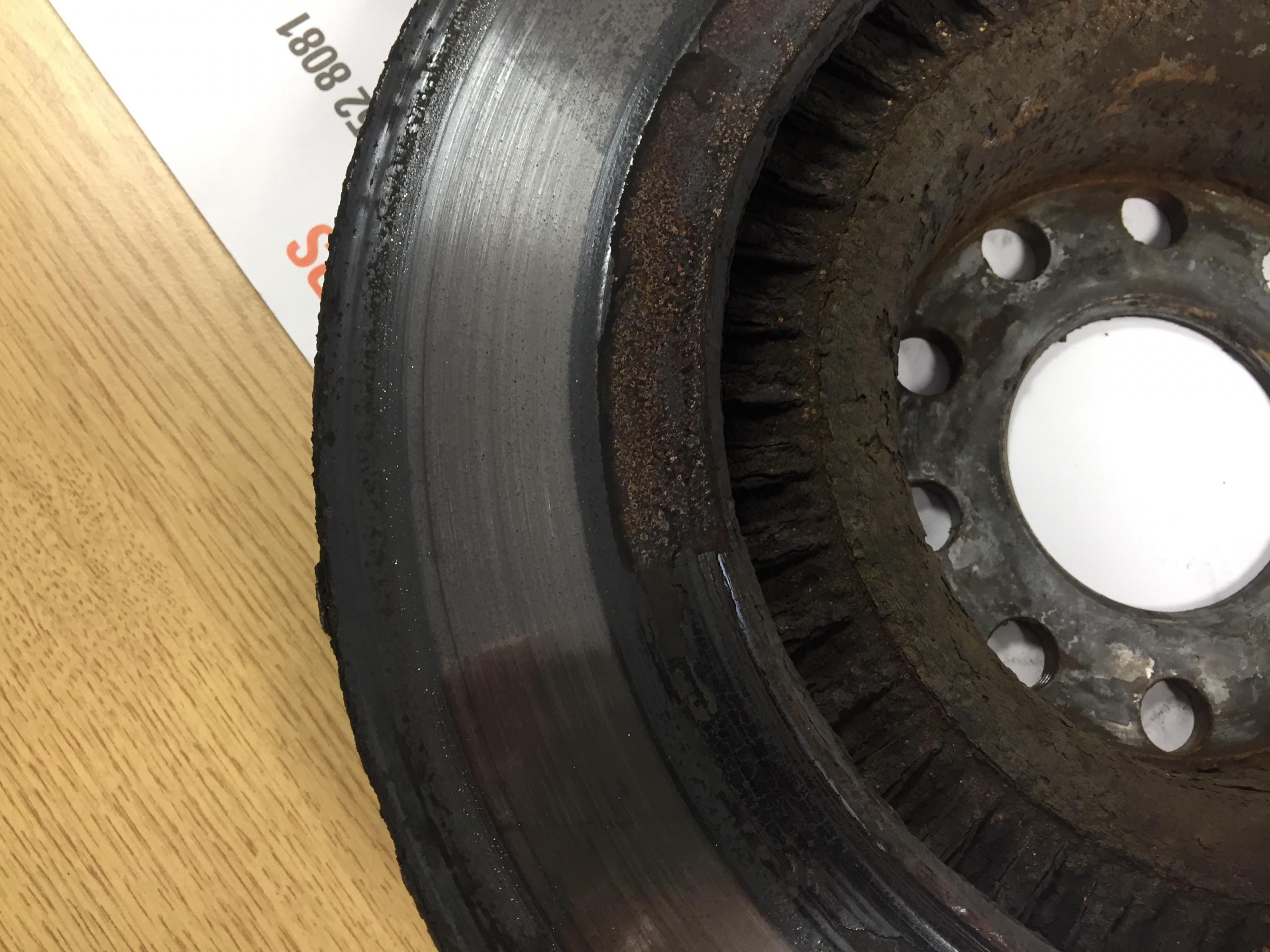

After 3 long days in the garage, my car is now back and my wallet has taken a bit of a hit!
One of the issues was a worsening wobble/shudder on braking, as well as pretty poor braking performance. New front pads, new front discs and a replacement suspension arm seem to have cured this, thankfully, but I was surprised (no, horrified!) at the terrible state of the inside of the discs and the battle-scarred suspension arm!
Photos for your amusement/horror.

I'm not surprised you had poor braking performance with discs looking like that! How old were the discs? My rear discs are looking like they've seen better days but I don't think they are that bad.

Got your money's worth out of those discs Jim!
Worn out, or faulty?
