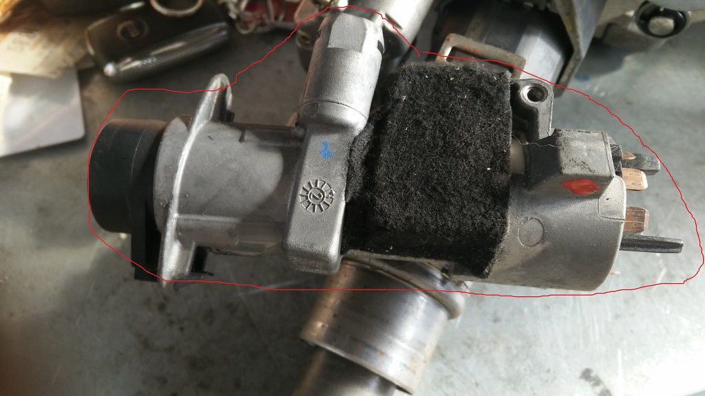

Ignition switch contacts implausible - some are on and some are not when they should all be the same. Given that you mentioned you're starting it with a screwdriver, that seems entirely plausible.
I'd probably look at changing the whole ignition switch assembly - this bit:

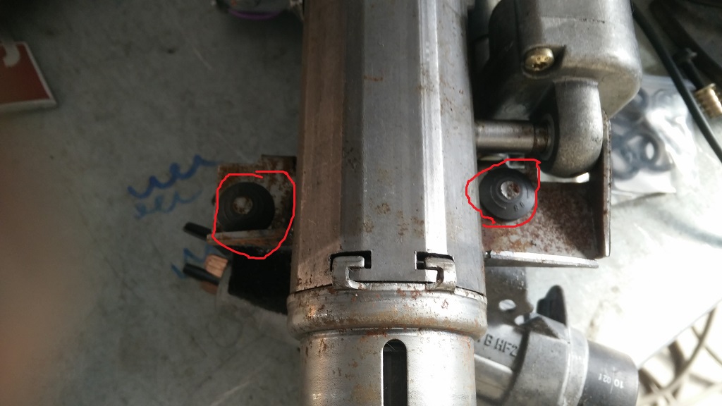

That requires dismantling the cowling, which you've probably already done, removing the steering wheel, clock spring and column stalks. Then you have to grind these two shear bolts off:
Usually I'll cover the interior with some thick cloths / rags / old blanket and cut slots in the bolts with a dremel, then chisel them out.
At this point its probably easier to swap the whole chunk than to try and change bits inside it.

Thanks for that nugget of info, MikkiJayne!
One of the codes I've picked-up on today stated misaligned contacts, so you're spot-on
I'll A8 Parts in the morning to see if they've that "chunk" in...
Enjoy what's left of the weekend and thanks again!
