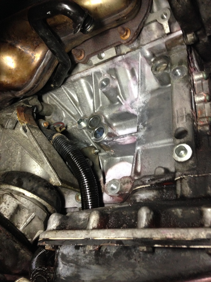

I had the oil cooler plastic pipe/union replaced with an aluminium replacement part from the States. Work was done at DS Autowerks in Crawley by Dave Schofield, in March 2017. He took some photos and I've attached the one that I think shows the two inlet/outlet holes. I cannot see any writing or markings on them. I hope this photo helps in some way.

That's the engine oil cooler
Top is inlet on the transmission

My mistake, I didn't read the post properly as I got all excited at the mention of an oil cooler.
I've learnt something new today MJ et al - apologies for polluting this thread with wrong information.
