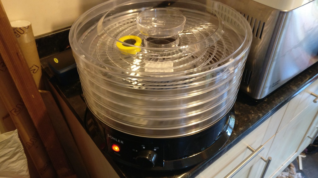

Given the shortage of priner filament, I decided to try and recover some of my older filaments. It is hygroscopic and so doesn't take well to sitting around in the house, especially given the winter we've just had. Ideal humidity for storing filament is <20% but my office has got to 40% over the winter and so most of my old filament is toast and I can't simply replace it now.
The solution? A cheap food dehydrator from Amazon
I cut the middle out of all the food trays so a roll of filament sits inside. Its been running all day at 50C and is now 10% humidity inside. A few hours of that should allow all the moisture to come out of the filament and then I'll store it with silica gel to make sure it stays dry. I shall test the dired filament tomorrow and see if it works
