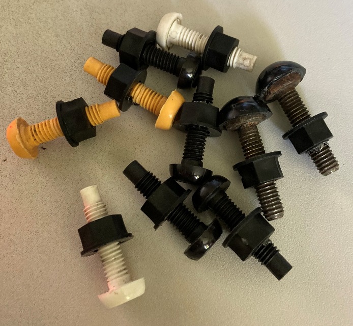

I have a whole collection of spares picture now attached. You can see the original Audi metal bolts in the collection, they needed rather large domed covers.
Probably bought those plastic ones online, maybe M6 thread, not sure........ (Something like this: https://www.ebay.co.uk/itm/Yellow-Bl...2/373039266833 )

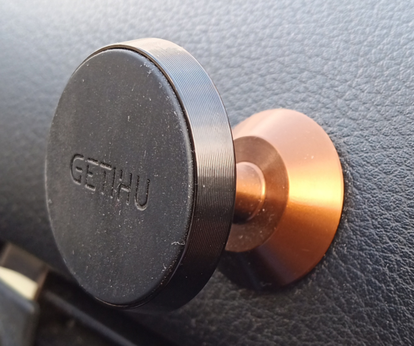

Double sided sticky tape/pads always work for me, never been problem with it coming off. Someone (3M I think) does VHB (very high bond) tape/pads. And if this is not enough there are kits with clear primer/adhesion promoter for plastic surfaces. I have a magnetic phone holder stuck to dashboard with about 1 inch diameter pad and that holds fine for over year even fairly heavy 228g rugged phone just fine.
