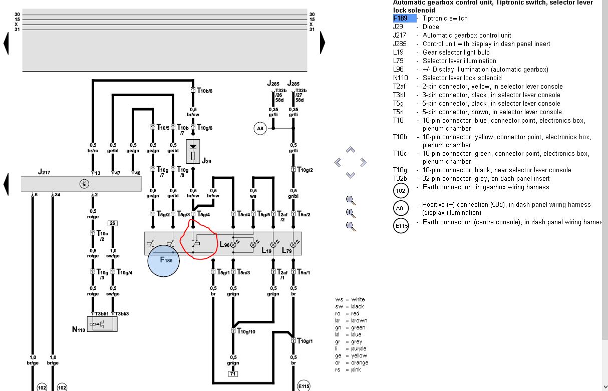

Interesting fault. This one will require some pondering...
In the meantime, this is the F189 wiring to the TCU:
The bit in red is the tip engagement switch. The two to the left are up / down. Assuming the steering wheel is the 3-spoke with tiptronic and not the multi-function 4-spoke then the two buttons are just wired directly in to the F189 wiring.
Two things I would try - swap the TCU (although thats easy as I have a box of them), and unplug the shifter with the black square-ish plug to the front right of it, and see how it responds.

Tip buttons in D are a TCU coding thing and definitely should work on an 02 S8. Assuming the stick is in D (red-circled switch) then the TCU will still respond to the tip signals which it knows are coming from the steering wheel, thus it goes back to D on its own after a bit.
There is a diode in the circuit from the tip-engage switch so that the TCU doesn't see the power to the two lights in the shifter which the engage switch also operates. I wonder if a fault on the lights would cause the TCU to see a stuck ground on the switch...? Still pondering.

Furthermore, when I saw that diagram the diode stuck out like a sore thumb.....

I wonder where the diode is and if it's possible to disconnect it then try the tip buttons (and shifter tip movements) in D?
It must be near the shifter as it's between T10g and T5g which are both in that area.
Looking at the wiring diagram a bit more there's probably a small/short loom between T5n T5g and T10g (and maybe also T2af) all in that area and the diode may be incorporated into that.
If that loom can be separated out easily A8parts may be able to supply a replacement.

Would the diode be in the wiring item marked 26 on the attached image (borrowed from another post somewhere identifying the tiptronic select switch, hence the red arrow)?
