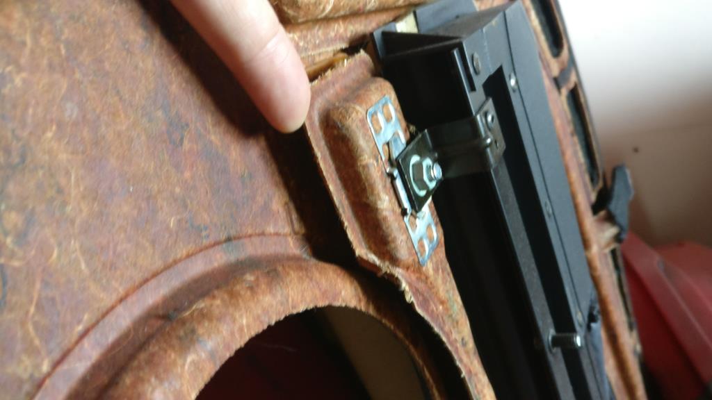

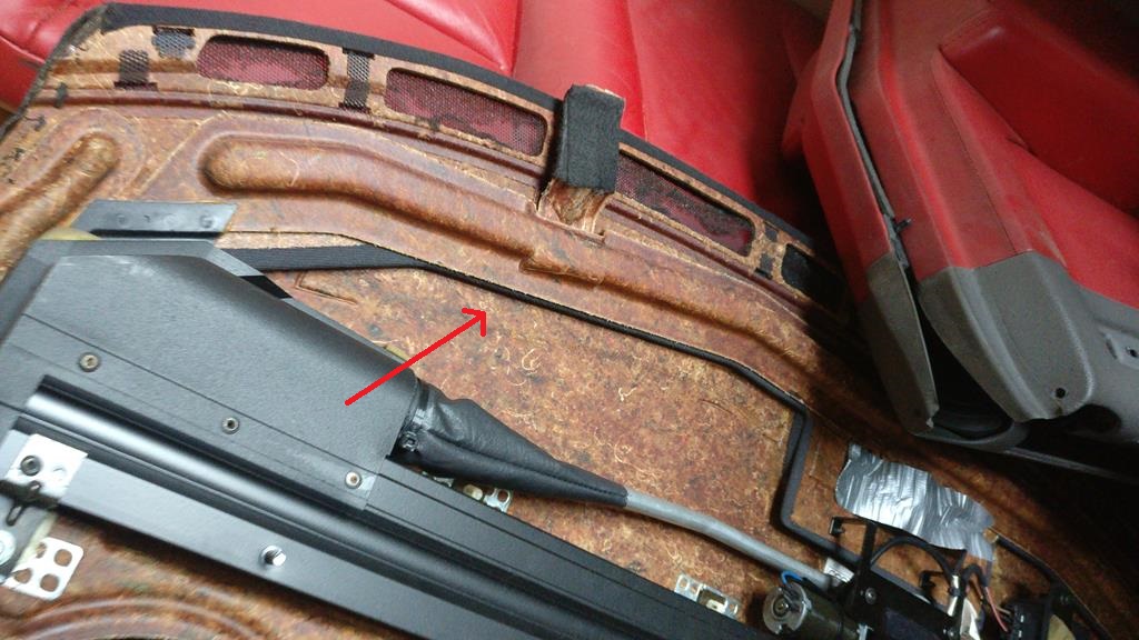

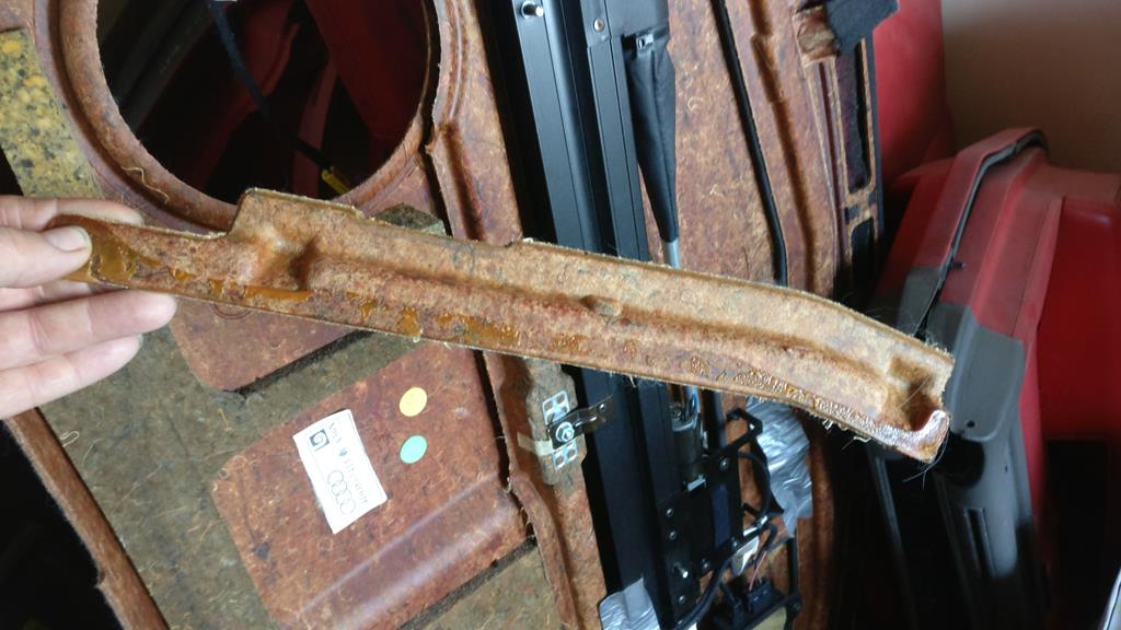

That, unfortunately, has succumbed to the effects of moisture and one of the flanges has come unstuck. The front of the cover is held in with poppers, and the rear has flanges which clip under the main shelf, allowing it to be attached separately following assembly.
The whole rear shelf is basically pieces of dense cardboard held together with a weird waxy glue, and unfortunately when it gets damp the glue lets go and it disintegrates. I have got used to repairing them with hot-melt glue which seems to work a bit better, although they do need drying out first.
You can lever the front of the cover up and then lift it out and forwards, but tbh its probably better to remove the whole shelf and bring it indoors to dry out before attempting to repair it.
This is where the flange should be:
This is the piece which has fallen off
Poppers at the leading edge of the cover
General falling-apart-ness

Thanks Michaela, that totally makes sense as the extremely likely cause.
Is that pathetic flange really expected to counterbalance the weight of the blind when raised?
It's certainly been damp in there, I noticed some condensation on the rear screen and have had some bags of silica gel sitting on the parcel shelf for the last few days.
Definitely a "round tuit" job...…. though I'm more into Evo-Stik contact adhesive than hot melt glue.
How many poppers at the front and roughly where, or is it blatantly obvious when you start levering?
Old 3rd February 2021, 10:03 AM
Its nothing to do with the blind mechanism itself - that is securely bolted through the rear deck. Its purely a cover for the mechanism.
There are three each side at roughly 8" spacing, with a larger gap in the middle. Start at the outer edge and once you've levered one up it should be possible to see the next. The cover is tucked in behind the top flange of the blind itself. I found it was easier to re-fit if the blind was lifted about an inch. They're not easy to get back in though and require an unpleasantly firm whack to re-seat.
Contact adhesive might work - I'd be interested to know actually, although it may not fill the gaps in the surface? There are indents in the cover showing where the flange should sit, and usually some remnants of the waxy stuff showing where it used to be.
