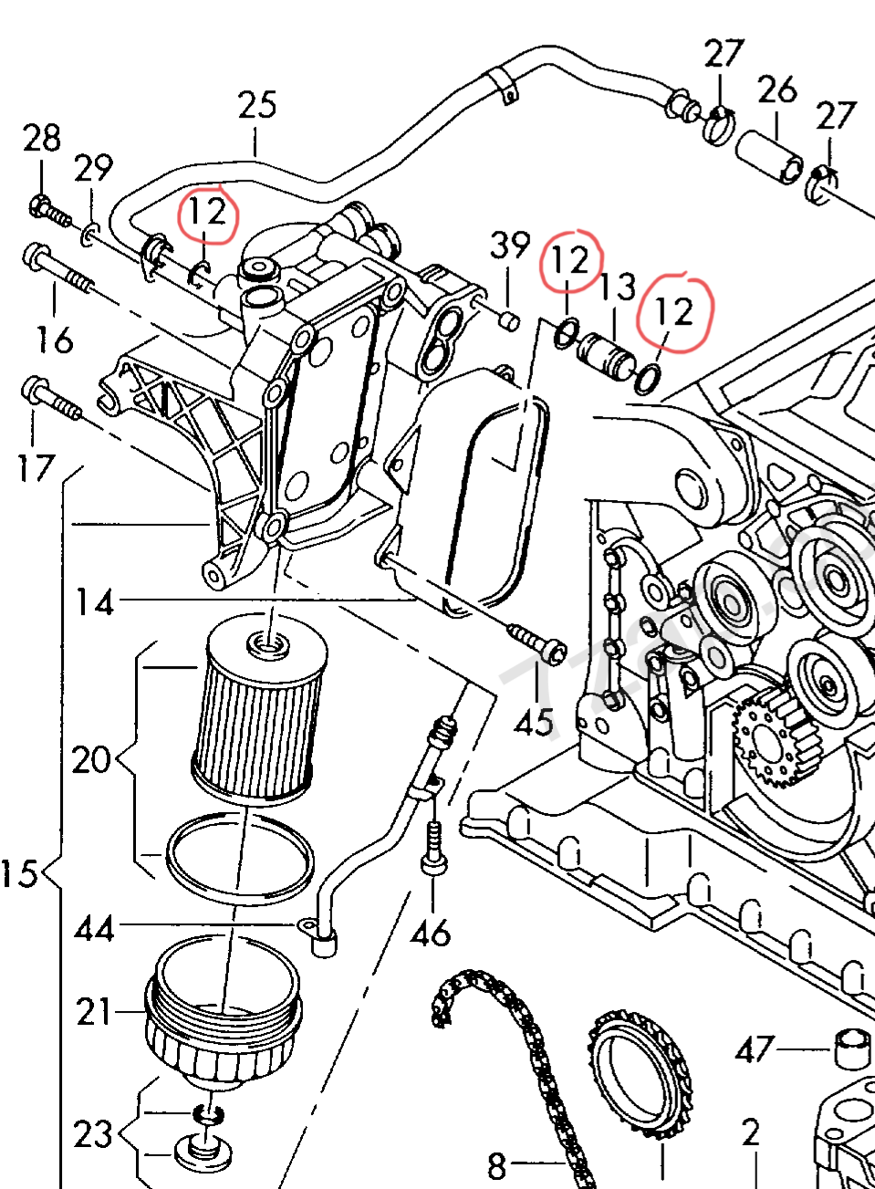

Thanks guys, are these the correct parts I'm looking at?

Old 5th May 2021, 11:44 AM
Ronin Ronin is offline
Join Date: Jul 2019
Location: Wales
Posts: 847
yes they are correct. additionally number 13 is a plastic piece that often naps and I hink you can get them made out of metal.

Best place to get the o rings? eBay lists them for £46 each
Old 5th May 2021, 04:41 PM
Remind me tomorrow and I will post you some I buy 100 at a time for pennies each.
