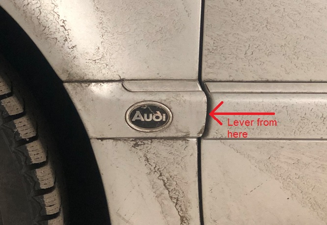

I need to replace Audi-emblems on front wing trim pieces as they are starting to peel off. I need to remove the whole trim piece to replace the emblems.
Looking at pictures and repair manual, I am still not sure, does it just pull off? Is there any clips etc. I need to replace in the process? I wouldn't like to break anything

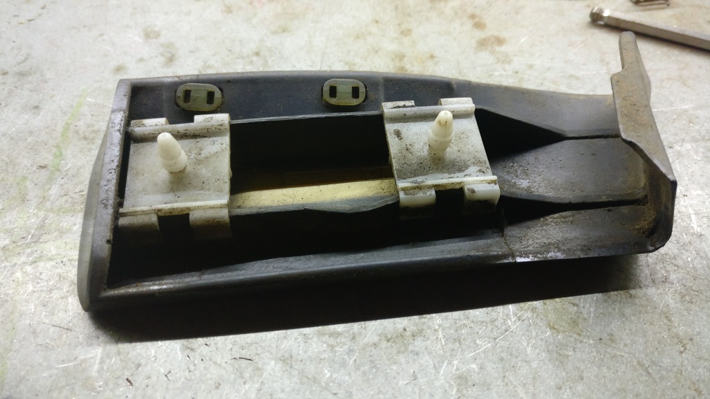

It's clipped on with pegs through plastic bungs. Prise it off from the back:
I'll try and remember to get a pic of the back when I'm in the workshop later.

Old 21st October 2021, 05:38 PM

That picture was useful, thank you!
