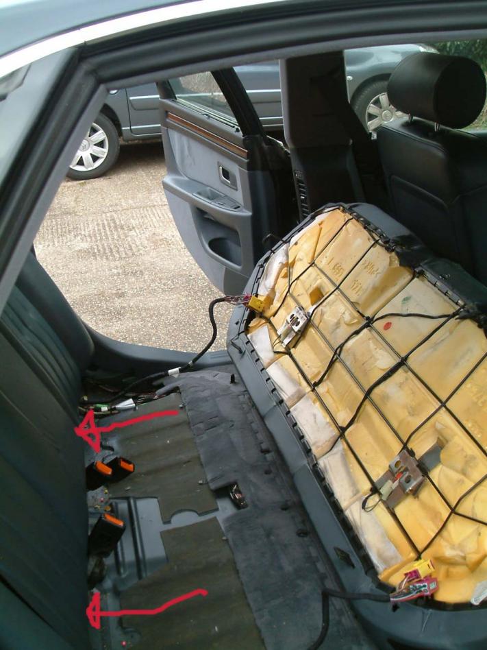

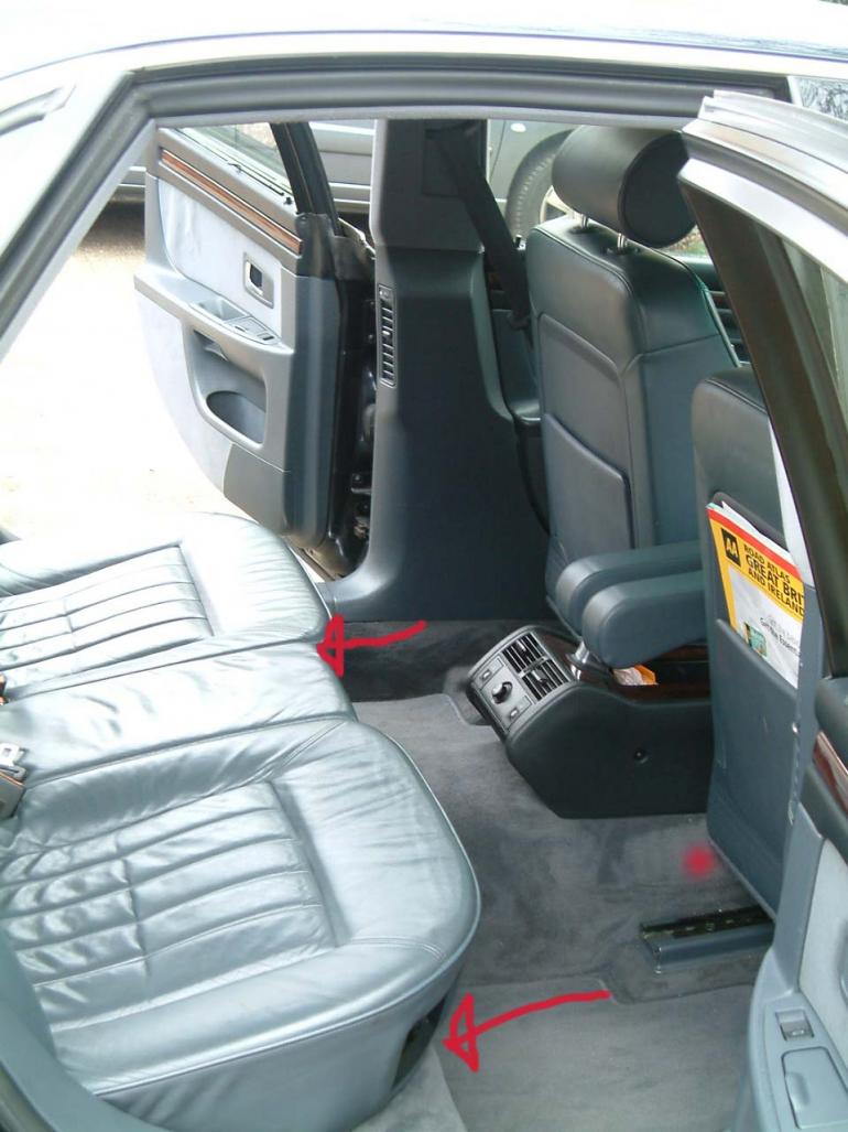

  2. Lift seat up - two screws located inbetween legs of rear passengers under carpet flap as shown in pic 1. I only disconnected the round sockets from the seats and left the other plugs intact - you need to remove those as the cable is quite short. Apparently if you do unplug some cables then a warning light comes on the dash. Since I don't have VAGCOM I left well alone.
  3. Now the rear sear is attached by two more screws at the base of the seat (see arrows in pic 2). After removing those the seat can be lifted off it's hooks. Lift it up about 2-3 inches and then it will come off. I did this by myself but a helper would be better as it's quite heavy. Careful not to unplug anything if you don't have VAGCOM.

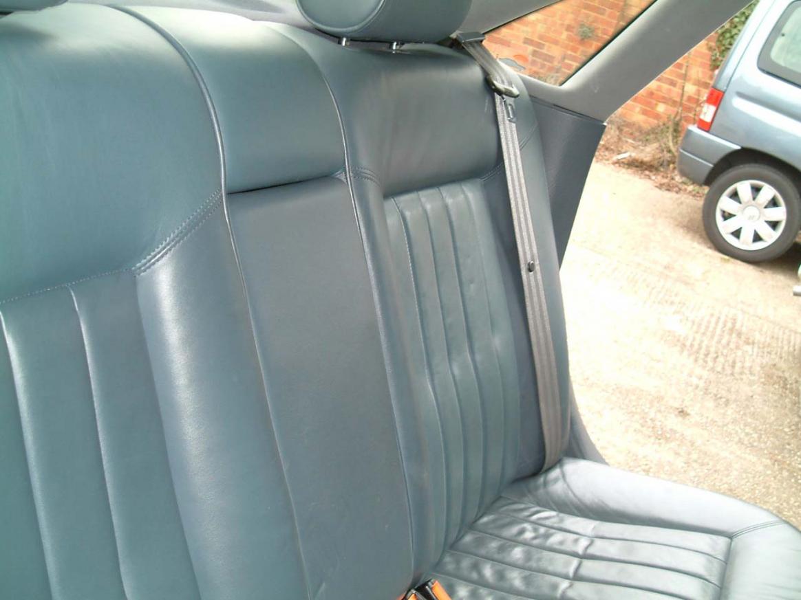

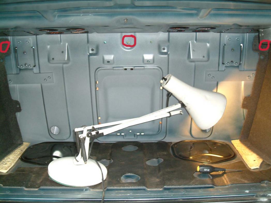

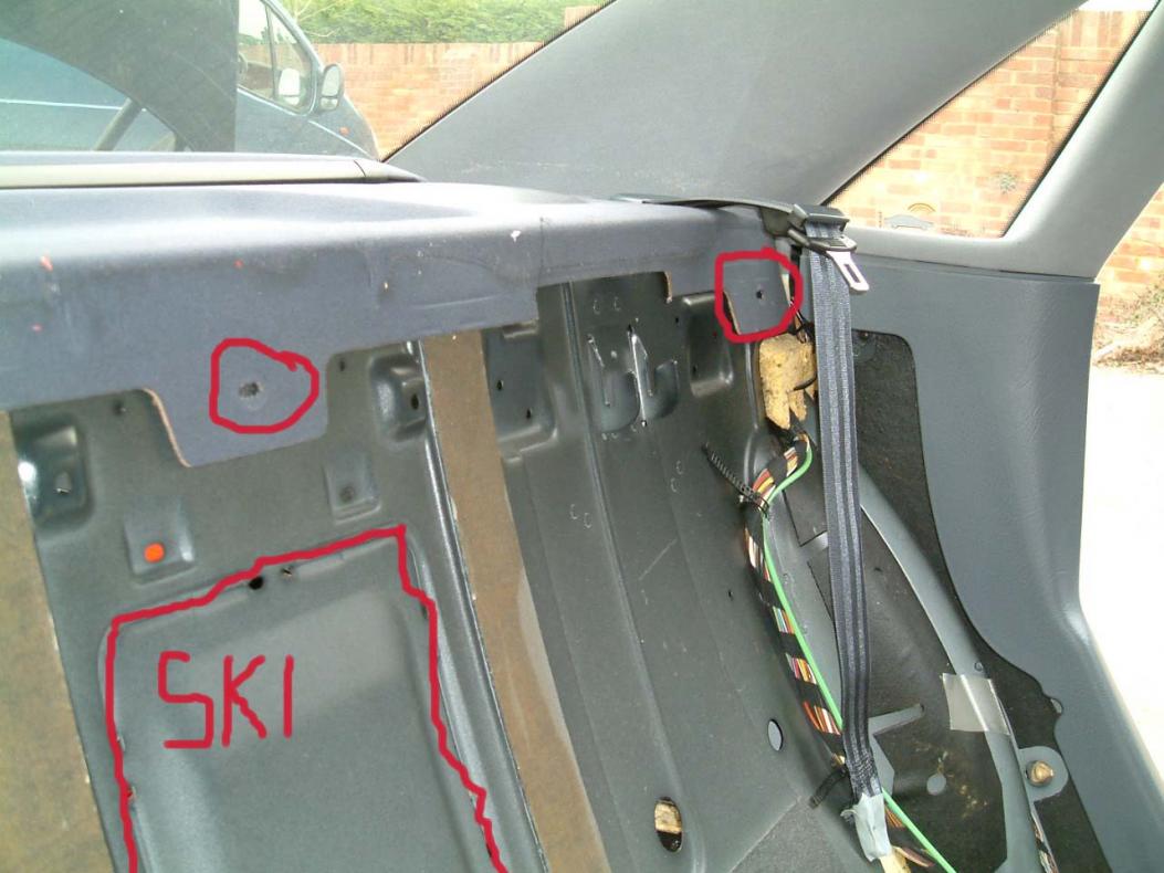

  4. So all this effort just to get to the three press-studs circled in pic 3 (only two shown - note the panel for the ski-hole upgrade that seems quite simple to remove - might have to pester Ian or Dave for the replacement cloth and carpet you'd need to complete that upgrade). I guess you could prise them out from this side but I found that if you remove the carpet on the otherside you can push the centre section of them out from the other side to make life easy. Shown in pic 4 although the outer two are hidden behind the side carpets. 7 much trickier press-studs to get this carpet off but I did want to see how to run cables from the boot forward so I didn't mind too much. As you can see there are lots of options.
  5. While you're in the boot remove the two speaker surrounds (4 screws each) and the two speakers (2 screws each). I only have the Delta system so I'm guessing people with BOSE will be here a bit longer - Serve you lot right . Finally remove the three 10 mm nuts that keep the parcel shelf from moving around under the extreme G's that these cars routinely have to deal with.....

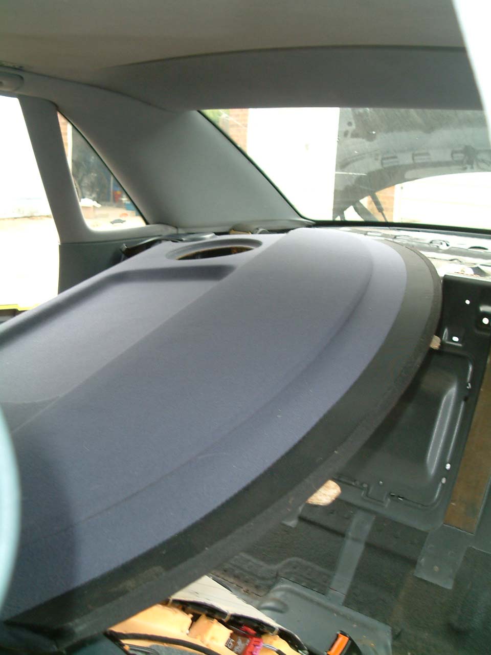

  7. Now this bit requires a bit of confidence!! Gently lift the parcel shelf up a bit and the pull towards you. I didn't remove the other seatbelt nor did I want to unplug the blind so I ended up as in pic 5.

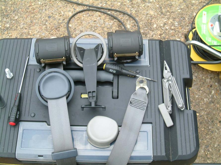

  8. Finally I could get down to business. The actual seatbelt is secured by 1 17 mm nut and a locating lip on its bracket. I ended up swapping the plastic section of the seatbelts around to keep the blue trim but I now have a cream belt instead of a black one. Ah well, guess it really is unique now....pic 6.
  9. Pretty much there then, to quote from the Haynes Manual: Reassembly is the reverse of removal . I checked electrics at most stages in case. Seems power is always connected to the rear seats but not the blind. Everything went pretty smooth...pic7. Actually I'm interested to see if anyone will actually notice the difference between grey and black.

Your interior colour is 'aqua', which is a light blue. I've personally only ever seen it twice in the flesh, so its exclusive, but really causes you problems gettings trim parts <doh>
Ski hatch is a doddle to retrofit as you have suggested - just get a ski hatch and a replacement boot carpet (or cut yours to fit) and you're away. With a little hacksawing
