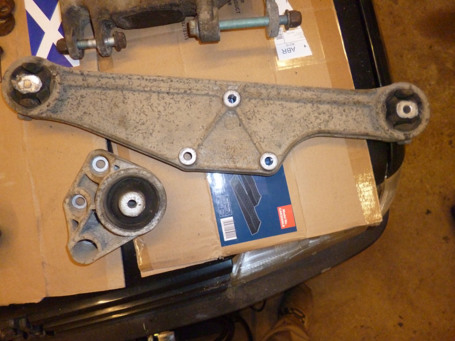

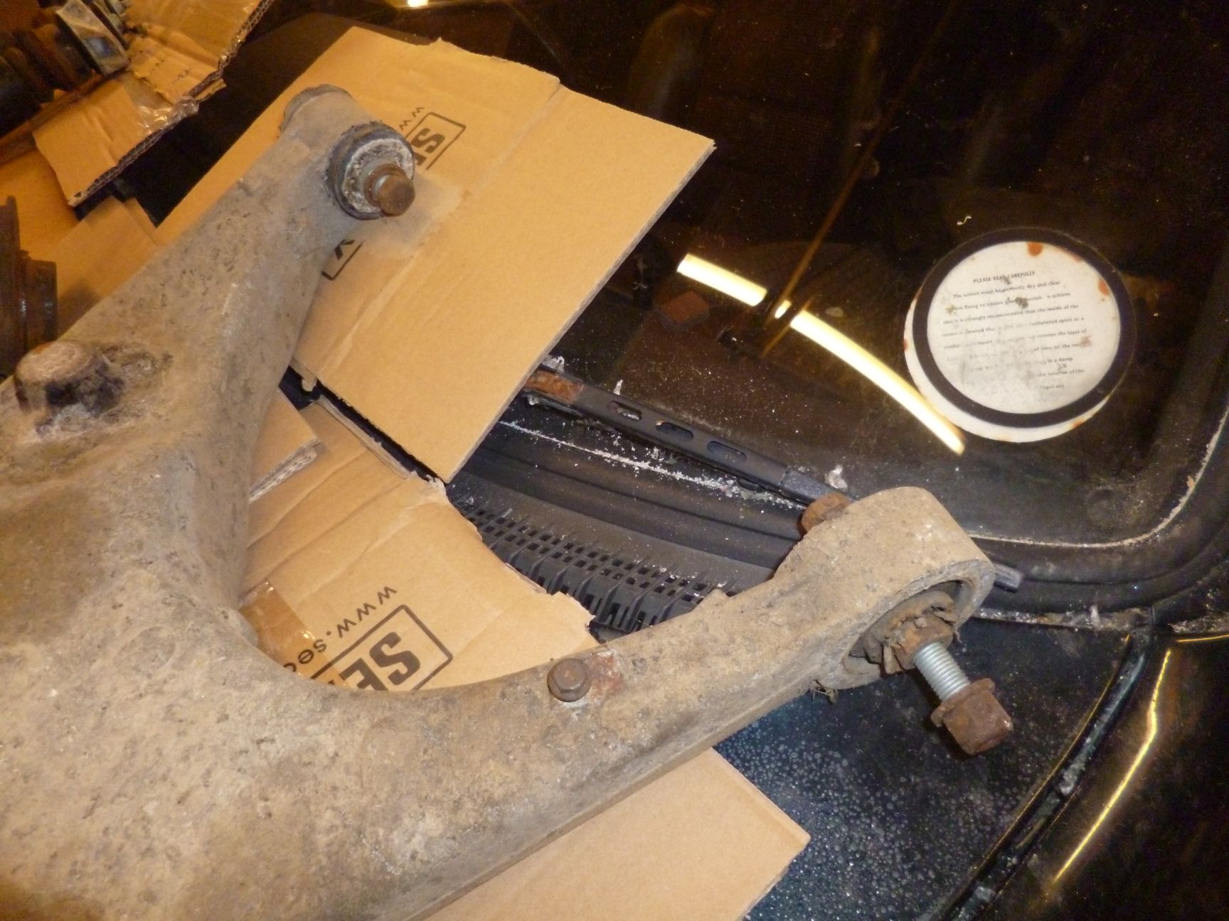

Other stripped parts:

Which leads me onto the then next bit, getting the replacement parts. The previous posts on this forum have been a great help, and I (think I) have got far more of the bits than I though I would through Auto-Doc, but would be happy for anybody to point out anything I have got wrong (or could get better elsewhere – the order has been placed, but I can always send back)!
Wheel Bearing Housings
4x FEBEST VWAB-039 (bonded rubber bush 4D0 505 171 L)
Trapezium Link / Axle Guide (lower)
4x Febi Bilstein 32226 (mounting 4D0 505 171 H) – I understand these are steel rather than aluminium
2x MEYLE 100 511 0007 (mounting 4D0 511 523 C)
Transverse Link / Wishbone (upper)
4x FEBEST ADAB-022 (bonded rubber bush 4D0 505 203 E)
Anti-Roll Bar
2x FEBEST ADSB-4FHR (mounting 4D0 511 327 C)
2x MEYLE 116 060 8240/HD (coupling rod 4D0 505 465 D)
Miscellaneous
2x MEYLE 116 050 0164 (Track Rods 4D0 501 529 H )
2x FEBEST 2329-006 (Eccentric Bolt 4D0 501 387 A - these were probably fine, but for the cost I thought just get new)
2x FEBEST 2329-007 (Eccentric Bolt 4D0 501 387 B - these were a bit rusty though might have cleaned up okay, but again for the cost I thought just get new)
1x FEBI BILSTEIN 25282 (Coupling Rod (left) 4D0 505 547 C)
1x FEBI BILSTEIN 25280 (Coupling Rod (right) 4D0 505 548 C)
Missing Bits:
The items that I have not been able to get (so far) are:
4x subframe bushes, which I understand can be the D3 bushes - Lemforder 27312 01; these are out of stock everywhere (though I have not tried the local Audi dealer yet)
2x bonded rubber bush 4D0 505 203 G - from the middle of the upper links/wishbones; this does not seem to be available anywhere (I was actually surprised to see the other 4 bushes on the links were available, as I though I read none of these were available)
2x lower spring support 4D0 512 297 E - these are really rusty so it would be good to replace, but – as expected - this does not seem to be available anywhere; I might just look out for some reasonable second-hand ones, if such things exist!
2x upper spring support 4D0 512 297 G – again I did not expect these to be available, and they actually look fine so I do not think this will matter.
1x gearbox support bonded rubber bush 4D0 599 381 E, which I understand can be replaced with the D3 version - 8E0 599 381 B; these are out of stock everywhere (though again, I have not tried the local Audi dealer yet)
I also need to replace the diff crossmember support rubber bushes (especially as there is still part of a bolt in one of them!), and have sent a pm to MikkiJayne to see if she can do the refurb (as she mentioned she might be able to start doing in a previous post).
