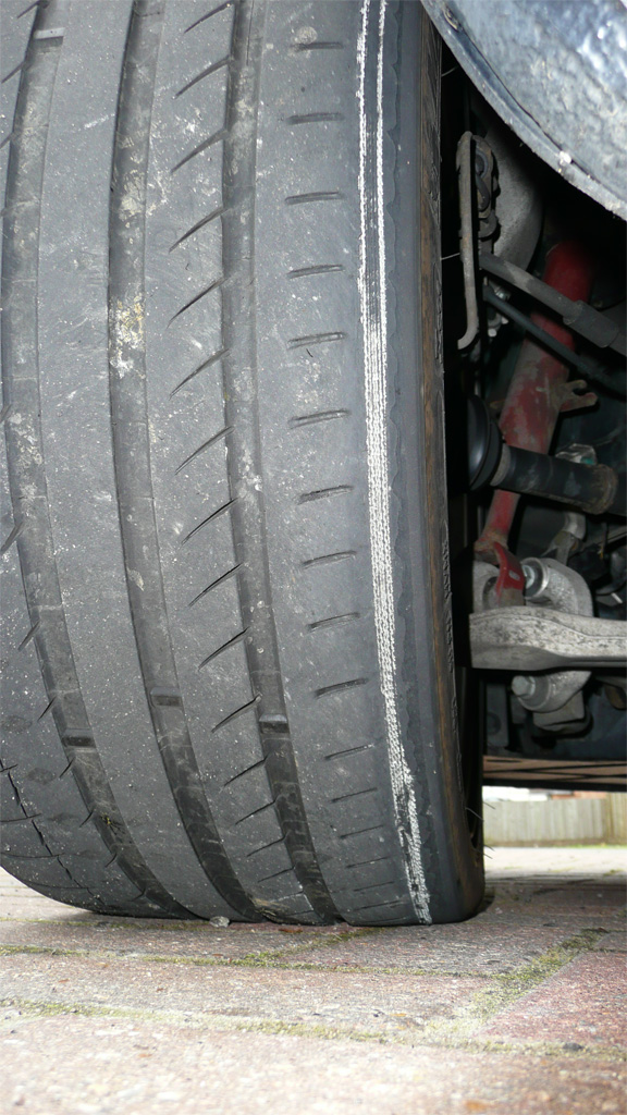

Just found a picture of the tyre before last
Regards,
-=Glyn=-

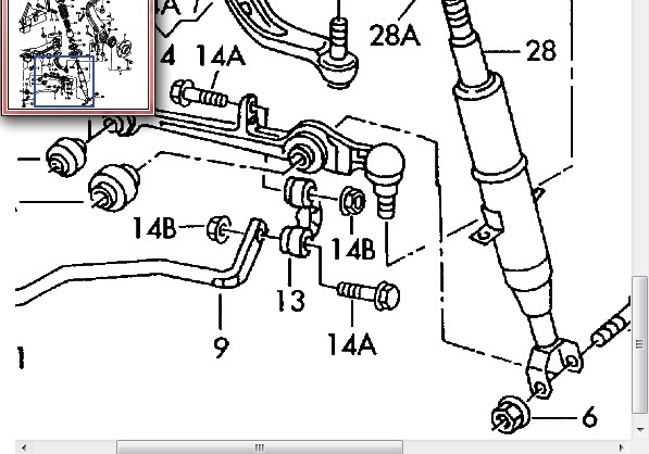

I notice the 'C' link for the Anti Roll bar is on the wrong way round. Should be behind the control arm. Maybe?

Well spotted mike - that might well be causing the problem
Nothing gets past the librarian!!!

But it is behind the control arm in the picture isn't it...it looks like it is the drawing is showing it in front to my eyes.

Ooopps my bad. Just spotted that the photo is taken from the rear. That being the case then the 'C' link is correct.
