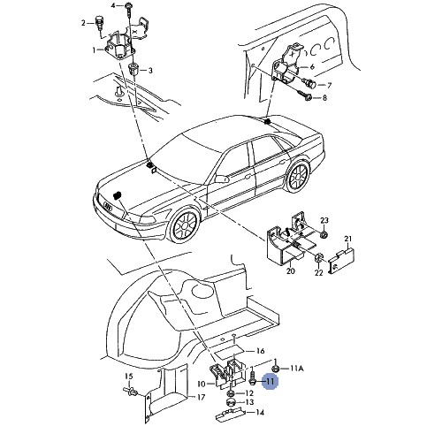

Old 30th October 2010, 12:26 PM
Posts: 3,879
This photo shows the brown earth wire left of the socket ratchet. The purple connector is next to the battery connection box.
The schematic
Old 30th October 2010, 12:34 PM
