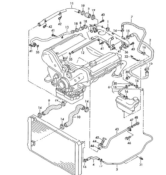

Did not quite work like intended, picture resized way too little, let's try again

Old 25th December 2010, 08:47 PM
Thank You so much, I'm guessing that the 'T Pipe' that split must be No.20.
If so that doesn't look to tricky to replace. Would you have the part number? I need to get down and have a look myself really then if it is that grab it from Audi. To be honest, I'm not sure if it was topped up with water, but that would explain it! Will get some G12 ++ in there now.

Posts: 3,845
I would not call No. 20 a t-pipe. It is t-piece or t-joint part number N 906 930 01. It is ordinary plastic t-piece 8x8x8mm that you do not need to buy from dealer but should be able to get from any car part shop. T pipes would be No. 1 or 12. The thread You pointed to talks about V6 engines and the pipe which would be equivalent to No12. also it is very unlikely for pipe to burst, it could be the rubber o-rings at the ends of pipe.
I would take a look by Yourself first to see where the problem is don't trust AA guys. While some are really knowledgeable others can't do much more then change a wheel, get you a petrol when you have run out or tow You to nearest garage or home.
