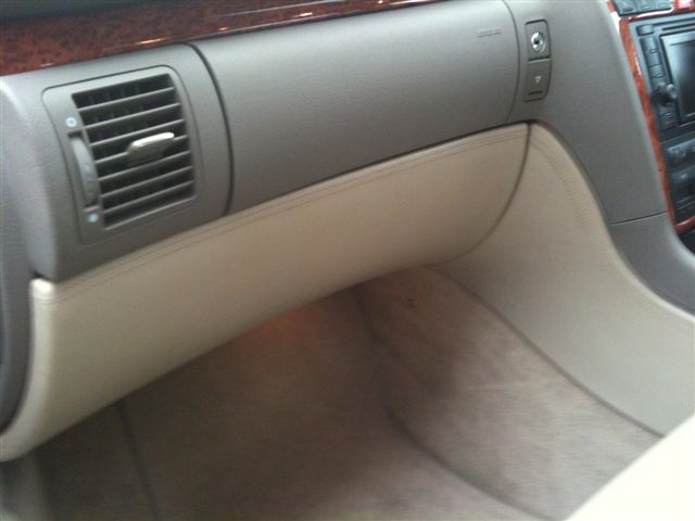

Old 30th August 2011, 05:42 PM
But it looks good, don't you think?

Old 30th August 2011, 08:41 PM
Jim, car looks great. Your panels make car look special.
Fully leather door cards don't make such a difference, and they are nightmare to clean were leather contacts with door seals, so leaving old cards is good idea. Besides, leather door cards easily develop mould on strip of leather outside rubber door seals, since that area is exposed to street conditions. With your color mould would be impossible to mask.
Very very pleasing upgrade.
