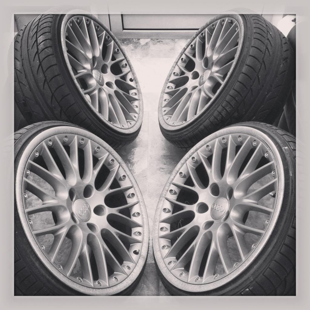

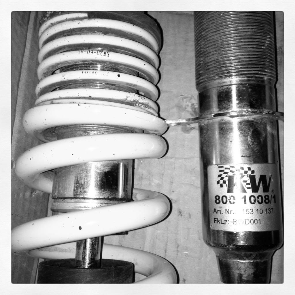

Ive bought KW coilovers and also some speedline alloys 20x10
they've got stupid tyres on at min 235/30/20 with a ridiculous stretch.
Not quite sure what tyres to go with to get the best look when its sat low and wheres best to get them from at a good price.

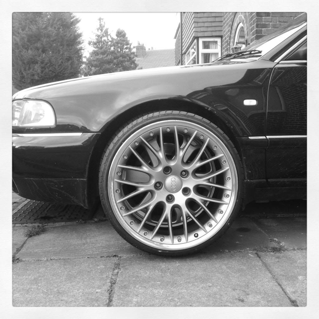

From memory you might struggle to get 20 x 10 wheels on the fronts due to impeding the suspension members, take a look at Audipages HERE for some advice. The widest Ive seen at the front is 275's on a 9 inch wheel so 10 inch is a huge increase, may be a suck it and see job so try bolting the wheel on before you buy the front tyres! Rears can go much wider, my rears are 295 25 21 on 10.5 inch wheels whereas the fronts are 255 30 21 on a 9 inch wheel.
The final editions are 9 inch wheels and Ive got 275's on mine all around when I put them on but if youre lowering the front down like I have on coilovers then be prepared for some adjusting or put up with some rubbing!

Cheers for your advice mate hoping they fit as don't really want to start messing about with arches. Could always have the wheels adjusted to 9". Know a mate who has had it done to get 20"s on his A3 sport back. What exactly have you done to yours with regards to suspension. Was maybe thinking a 255/35/20 tyre for the front? I have no idea as never had wheels this big, I've only ever owned Corrado's and golfs

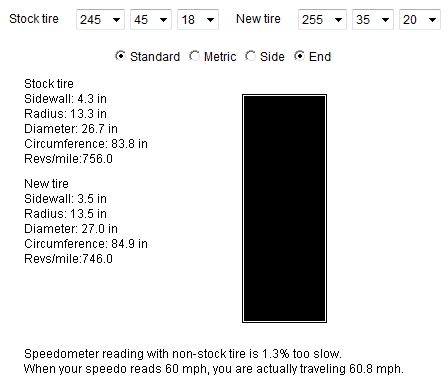

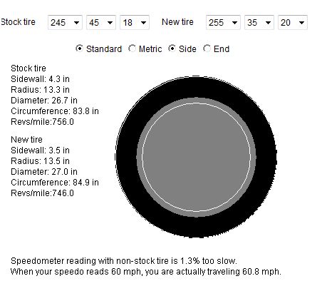

Assuming your tyres are currently 245 45 18 then the new ones will compare as follows on diameter/rolling radius -
The new tyres/wheels would be just slightly larger with a difference in radius of 0.2 inches or 4.4 mm
Its not the tyre size that worries me is the wheel width - a 10 inch wheel I think will still give you problems so you may need to narrow the wheels or get a swap on 2 of them to a 9 inch wheel and then fit staggered tyre sizes like I have

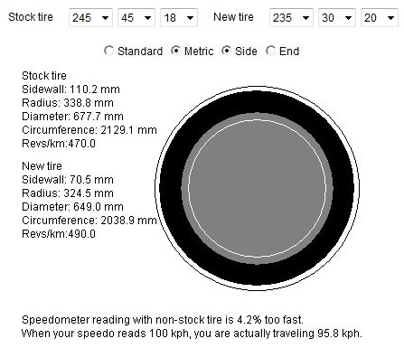

The tyres you have on your new wheels at the moment look like this against
your existing combination -
Overall diameter about 14mm smaller than existing and so your speedo will read about 4.2% faster than you are actually doing. Still not sure the fronts will fit (well they may fit but they wont turn full lock either way without fouling the suspension arms)
