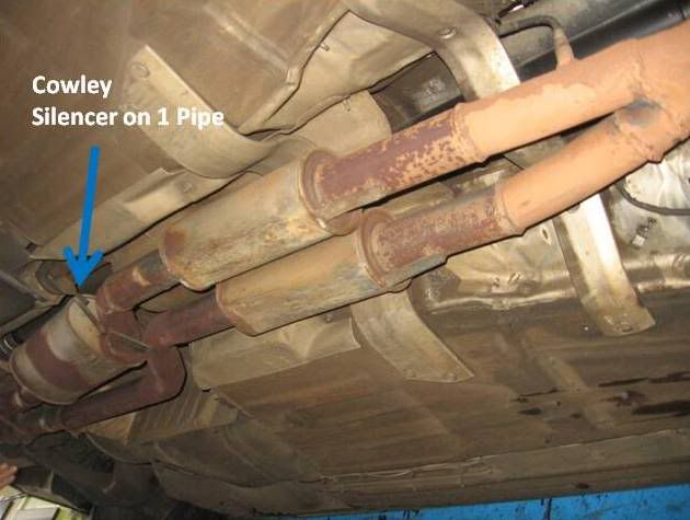

Decided to pop down to the local Powerflow this afternoon and have a chat to Roddy.......and find out what is causing all the fuss about the S and her tendancy to cause Pedestrians false teeth to rattle and every Rice Racer want to take Her On....
Arrived there.... straight on the Ramp..... Inspection.... the whole garage downs tools to look see.....
This is what we Found....

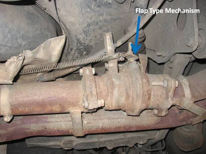

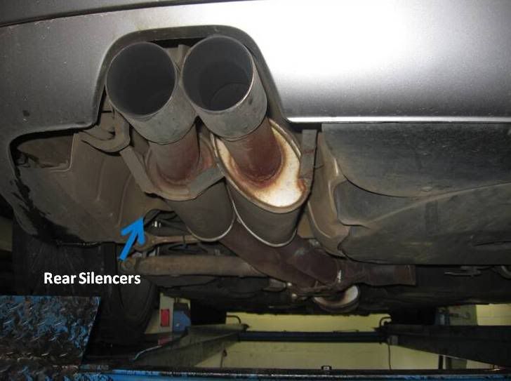

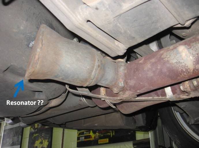

The way I see this is that the The Flap Type Valve shuts off the one pipe when in Prowl Mode
hence the additional silencer on the one pipe and larger rear Silencer ....... and Resonator ???
There is a rocker button under the centre armrests to contol this flap..... so I understand...
This does not appear to be operational.....
Roddy feels the existing configuration is restricting the output .....
Has given me a Quote to replace entire system in stainless...
Offered to re-plate the existing tips...... Cause I don't wanna change them....
I am keen to get the pipework re-done in stainless...... but keep the existing boxes, ...resonator.... , Up-Graded Flap Valve (operational) ....
I really like the sound of the existing set-up and wouldn't want to loose that....
Stay as Is
Replace pipework only
Replace entire system...
Any comments..... advice... Tx.

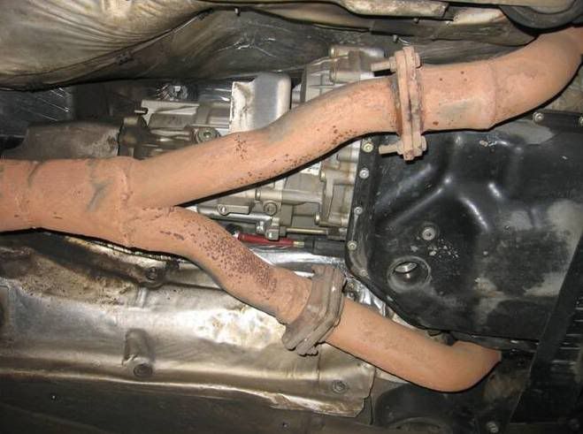

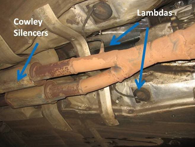

Looks like a balanced pipe or some sort of x-pipe at the front and de-cat!
The bit you have marked "resonator" at the back could be your rear muffler by-pass? Going to stainless will alter the sound anyways.
Certainly a weird set-up, but sounds bloody good

looks very interesting, a long x-pipe, and no cats. I wonder why the rear lambdas arent complaining, maybe the ECU was mapped?

Powerflow are saying remove the x-pipe and run single pipes.... ???
