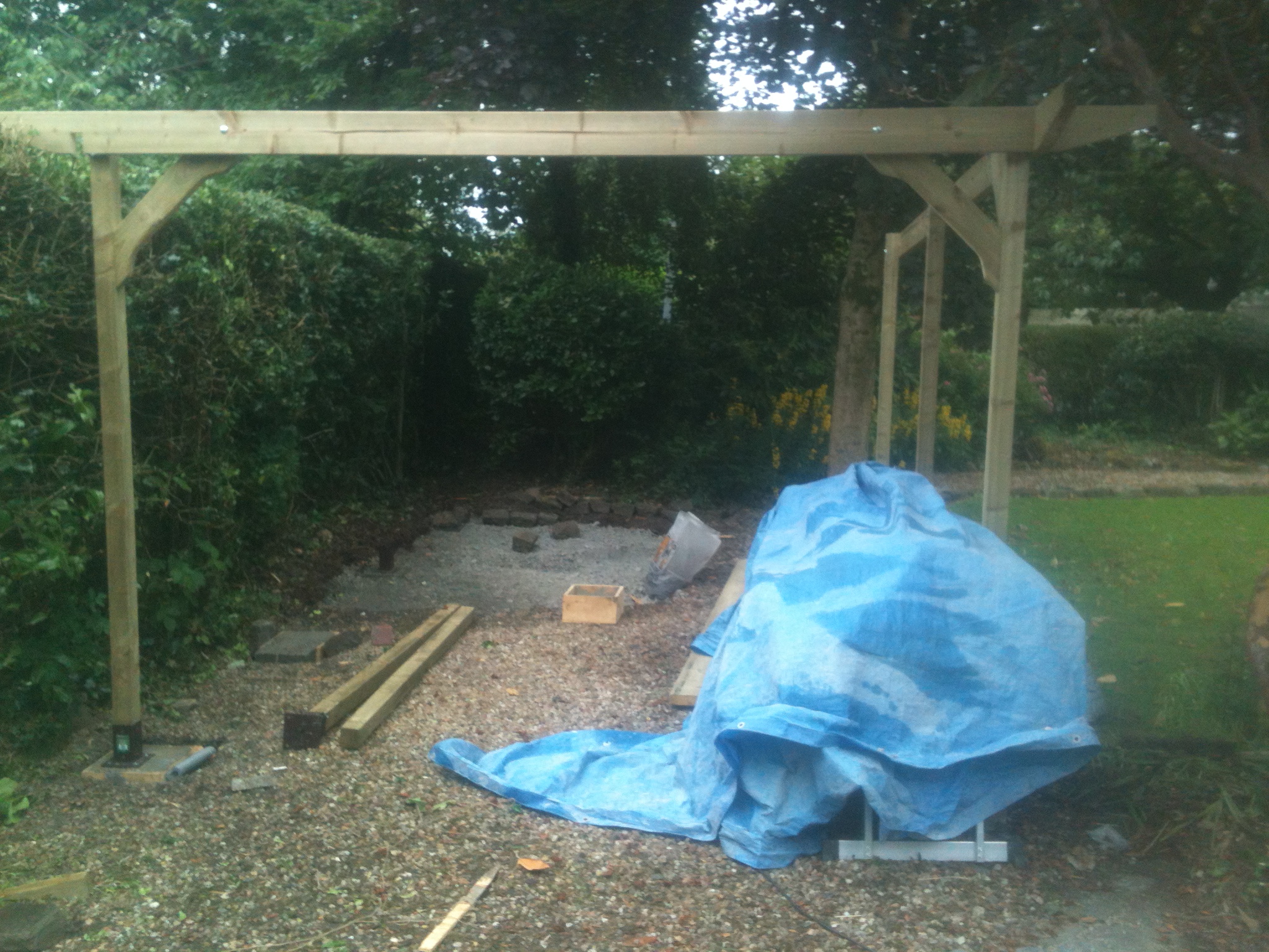

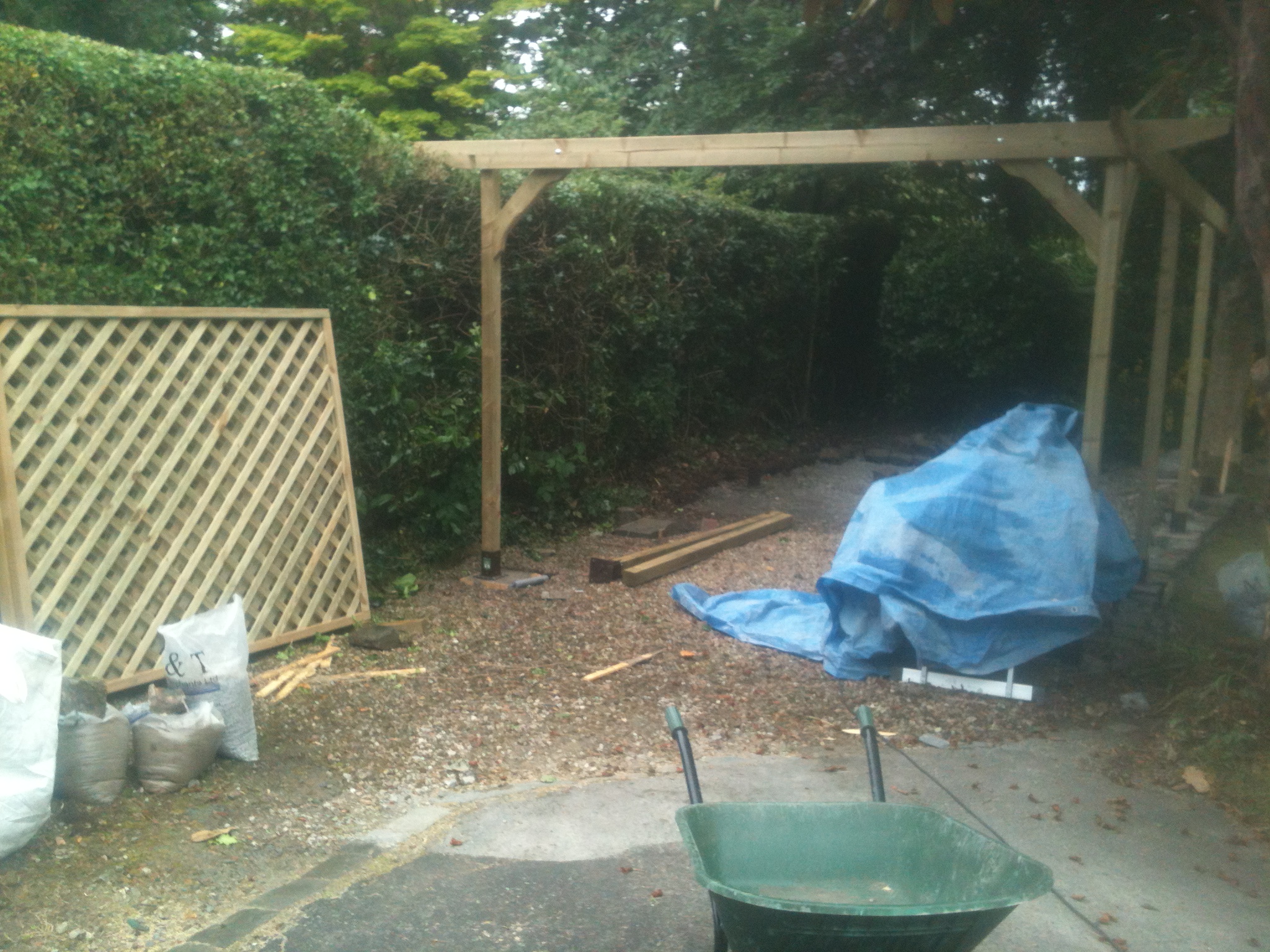

After being in this house for 20 years without a garage, I decided that at least one of the vehicles (guess which one?) ) was going to get some protection. I am fed up cleaning seeds, leaves and airborne cr@p from the car drains. So I decided that the most economically viable option (and sort of within planning control guidelines) was a pergola with a roof. Started a few days ago putting in some pads for the verticals in an area which was the start of a path around the front lawn and making the area larger. Got some of the structure up today having cut most of the parts whilst waiting for the concrete pads to set. When completed it will be a section longer than in the photo at around 6m. So it will, of course, fit a certain car.....

Excellent work! Just make sure the structure is no higher than 2.5m as that's the permitted development limit for buildings / enclosure's when next to a boundary.
Matt

I've been planning to do something similar myself. Like you, I have a parking area but no garage. I had been considering putting up four timber posts then using something like corrugated clear acrylic sheeting as a roof.
Are you sloping the roof to allow the rain to run off?

Thats interesting to find out! Quite by accident the posts are 2.4m at the front.
I intend using Ariel Plastic's Corolus corrugated PVC either 1.1mm or 1.3mm. They do a 0.9mm version but I have been warned off that. B&Q do a good price atm. Polycarbonate is v expensive but stronger. The recommended slope is a minimum of 5deg with 10deg being better for run off. I am going with 5 deg.
I would say that if you want to get all of your '8 under cover then its going to be over 5m in length and if you only use 4 posts then thats a big span without central support and most timber comes in standard lengths under 5m (i.e. my 150x50mm beams are 4.8m in length).

Will the PVC be strong enough for the very rare winter snow? and will 5 deg be enough for it to slide off?
