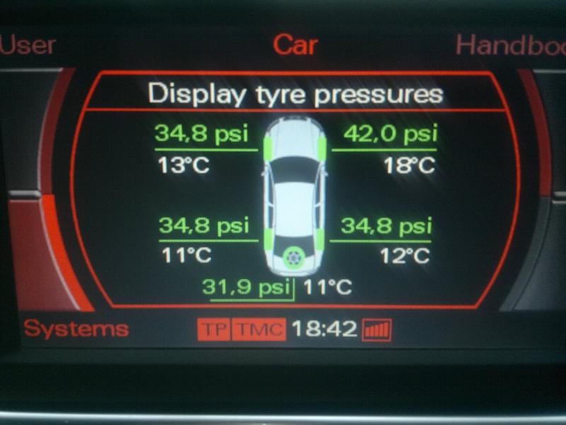

Do they all have temperature and pressure like this one ?
this photo was taken at the end of the day and the car had not moved at all so why different temperatures ?
is there a fault ?

maybe the OSF tyre is "warmer" because the tyre pressure is so much higher in that one?
