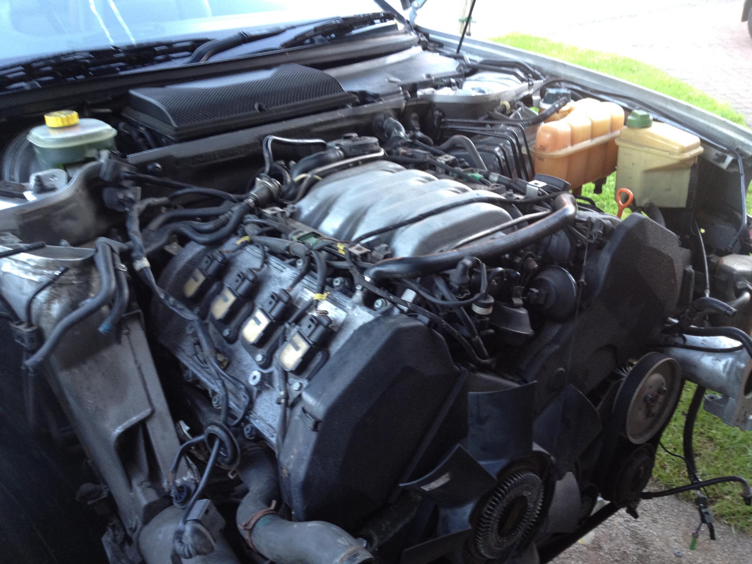

Well here's a pic of all the engine bits disconnected in the engine bay....
All that is need now is something to hold the engine while I undo the subframe and the whole thing will come away.

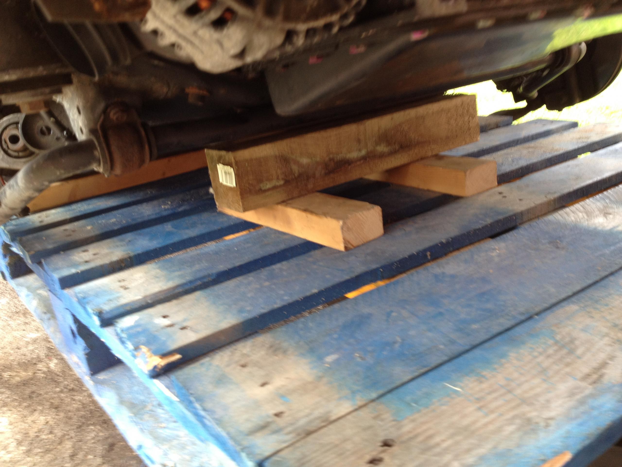

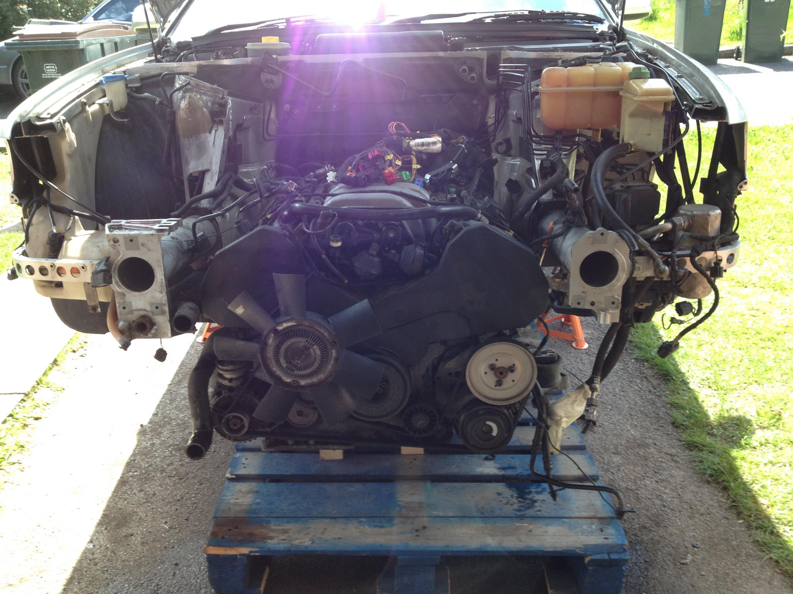

Well I finally managed to seperate the engine/ gearbox from the car.....
Never done anything like this before....so alot of it was taking my time every step of the way....and double checking everything...so it has taken me about 2 weeks to get to this point....doing about 2 hrs a day..
I kept the car on axle stands and got myself a highlift pallet pump truck....that way i didnt have to worry about lowering the car ...instead I just lift the pallet up until it took the weight of the engine....loosen the subframe bolts 2 at the from and 2 at the back...and 6 smaller bolts towards the back....
I managed to drop the engine and gearbox complete to the floor...however that is where I have got to as it is too heavy to move it by myself!!!!!!!!
