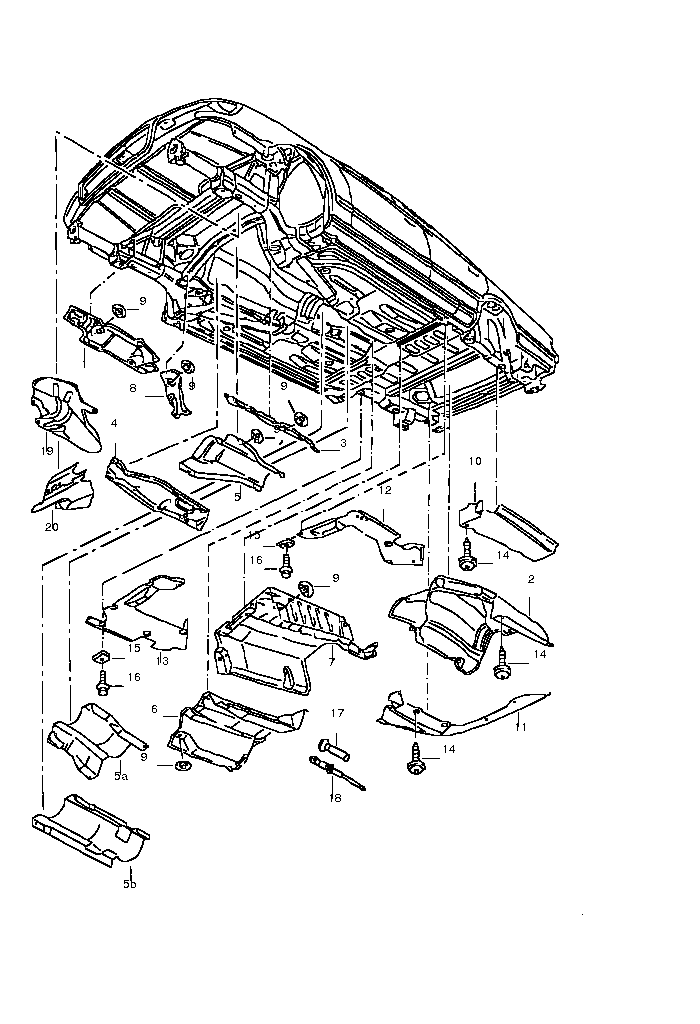

Could someone confirm if this is the right part for a facelift D2
4D0 804 840
http://www.ebay.co.uk/itm/Audi-A8-D2...item2a1345798a
Manny
Past
Old 24th March 2013, 08:45 AM
Yes Manny looks like on Vagcat that that part number goes right through pre facelift and facelift
http://www.vagcat.com/epc/find/?art=4D0+804+840
