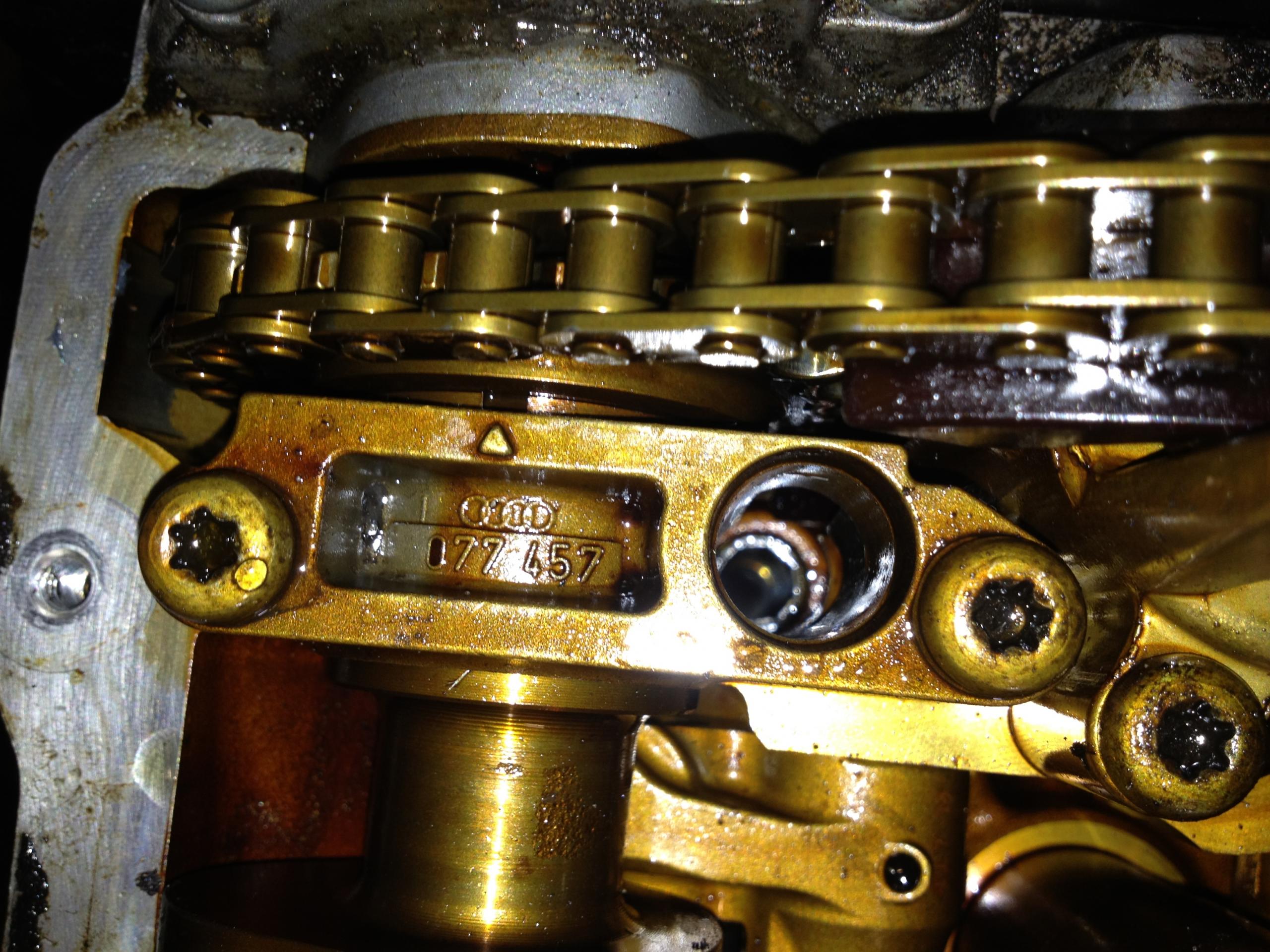

Default Found out how to set the cams at top dead centre
The image shows how to align the camlobes....The arrow should point to a little edged gap on the sprocket of the inlet and the output cam.
