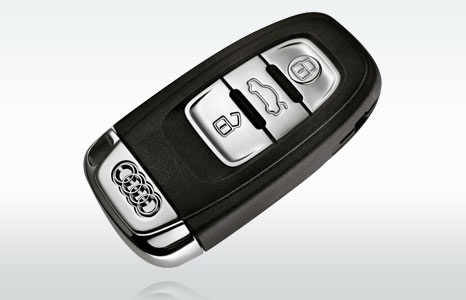

I wonder if we can use the newer type key ( pick attached ) as mine is a 2008 and has advanced key as standard
