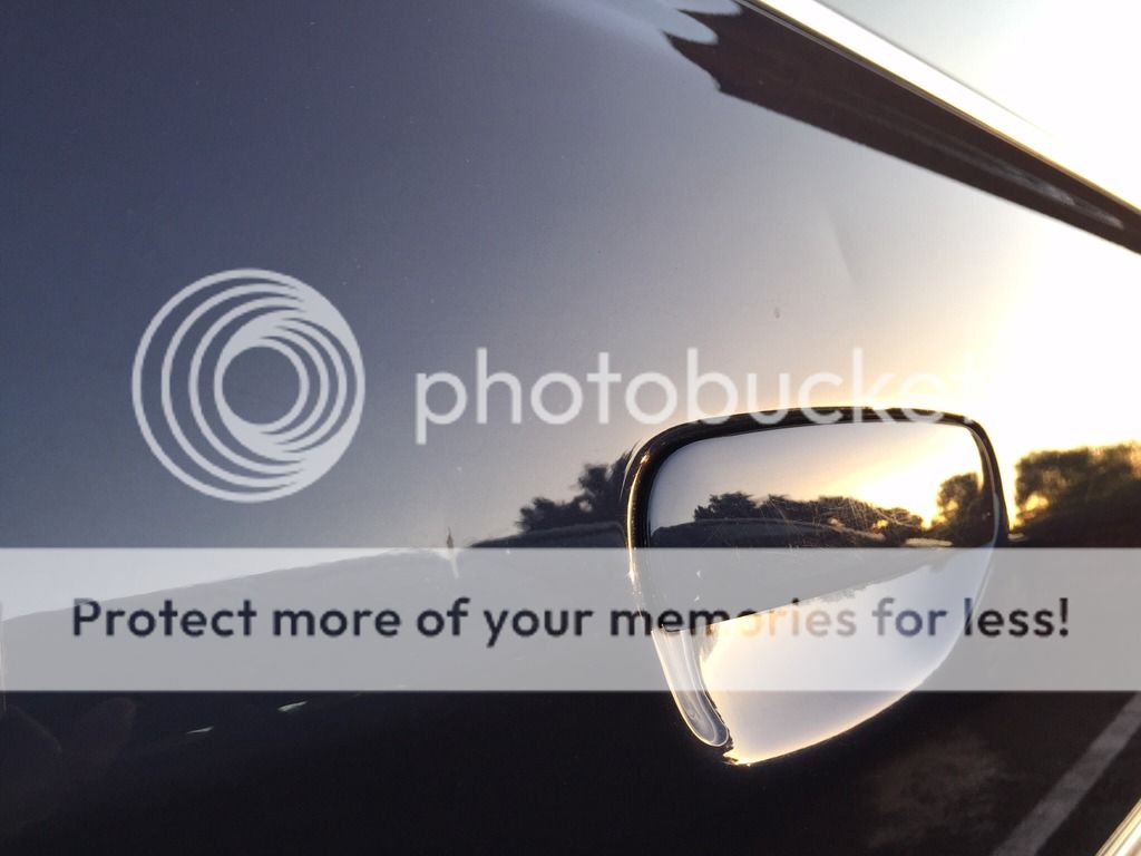

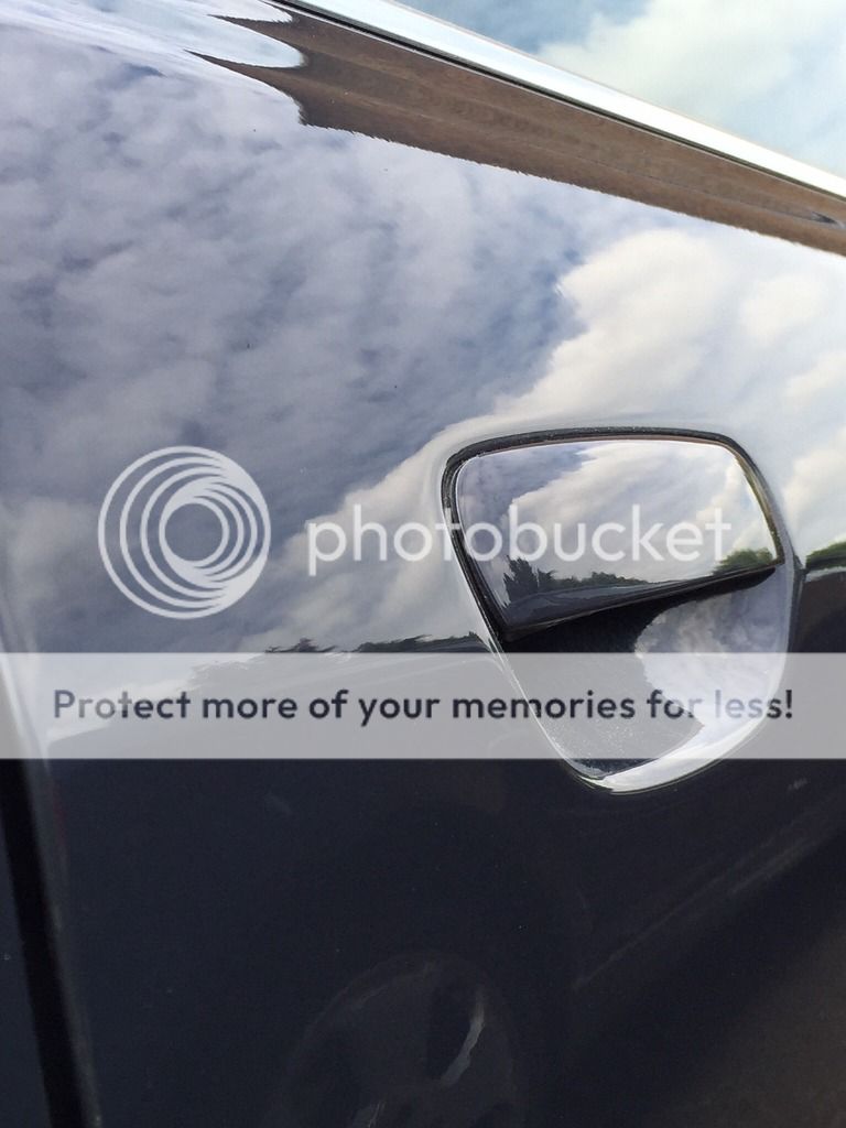

driver side rear door:

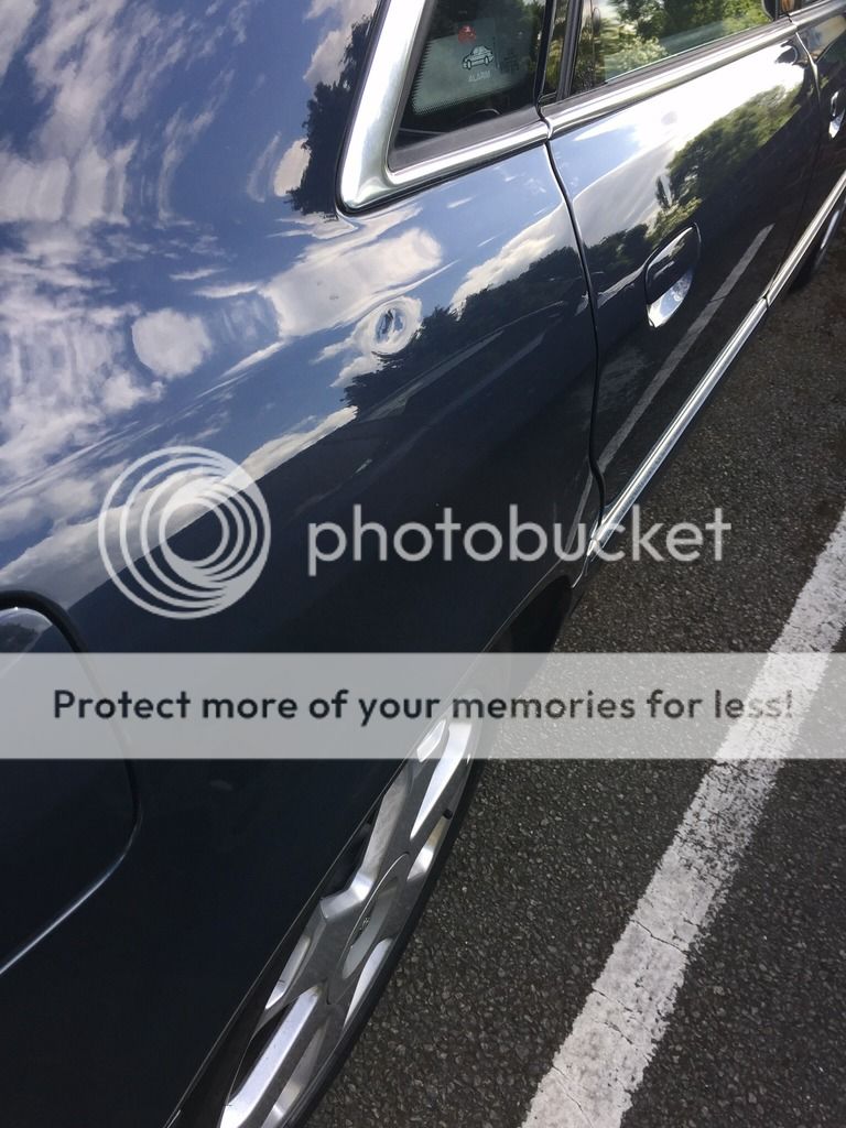

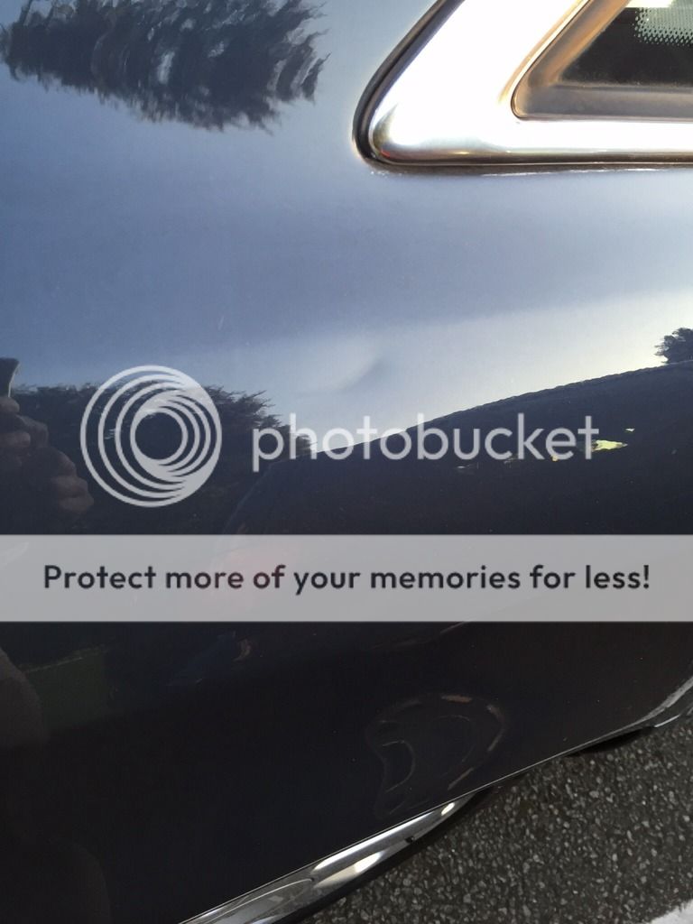

Tricky one - rear quarter - appears to have seen some paint, so unsure if Jake can tackle this:
Looks worse in this pic, the cloud reflection doesn't help:

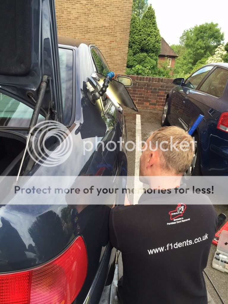

Ok, so job done and I'm very happy with the way its turned out on the panels Jake could attend to. He didn't think he had sufficient access to the work on the front door, a constraint caused by the channelling for the double glazed windows. I need to ask him if he could retry with the door cards etc all stripped out - will see if I can find a photo of the inner view of the door with card removed and see if accessible then.
Otherwise some pics of progress:
Arch liner removed, 8mm access hole drilled into inner skin for access to outer skin from inside:
Dent is pushed out from behind and tapped out from outside - seemed counter productive to be tapping in, but what do I know:

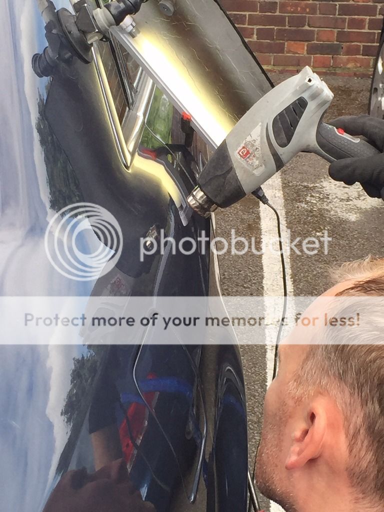

Bit of heat to assit paint flexibility, but with ally also helps soften the panel:

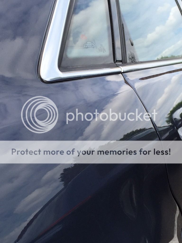

Final result on the tricky panel - was treated with a rotary machine with cutting compound, prior to final polishing. The dent has gone, so smooth to the touch, however there is a very minor 'flaw' in the paintwork, ie it looks like a crease in the paint, but is smooth to touch if that makes sense. You really need to look for it, and so much better than before!
