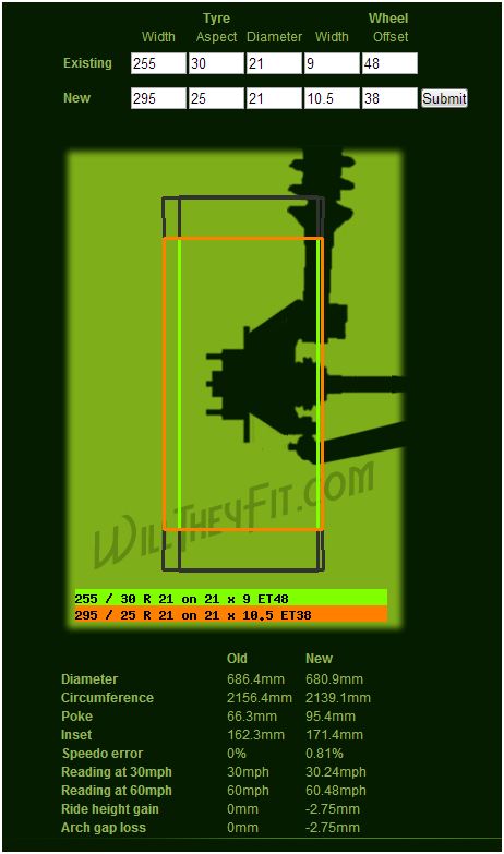

if you want genuinely staggered wheels then you need the 2 different widths on the front and the back but you then need to pick tyre sizes for each axle that will result in the same rolling radius front and back or within 1%
You can use a site like www.willtheyfit.com to check one axle's overall rolling radius against the other. if you use my wheels as an example -
front wheel size is shown in green and the rears in orange.
The difference between the wheel sizes is 5.6mm which is 0.81% difference so under the 1%
if you find a set of wheels you like then you need to look at -
a) what size you have now versus what size you will have (to check for and be aware of any speedo error percentage)
b) compare rears to front on rolling radius to check you are within the 1% difference.
The guy I bought my staggered Kahn wheels from didnt understand this and had 30 profile tyres on the front and rears and was getting quattro errors and sold the car (A8 D3) and the wheels because of not understanding the issue!

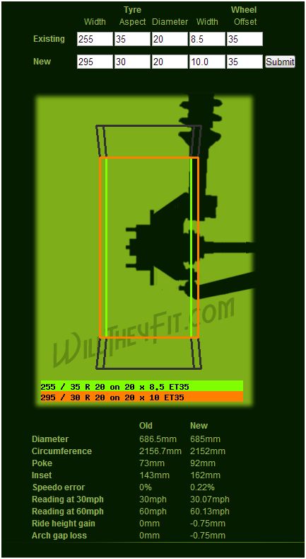

I would go for something like below on the 2 sizes as the rolling radius works - only 0.22% difference in radius.
you would have 255's on the front and 295's on the back but at slightly different profiles.
