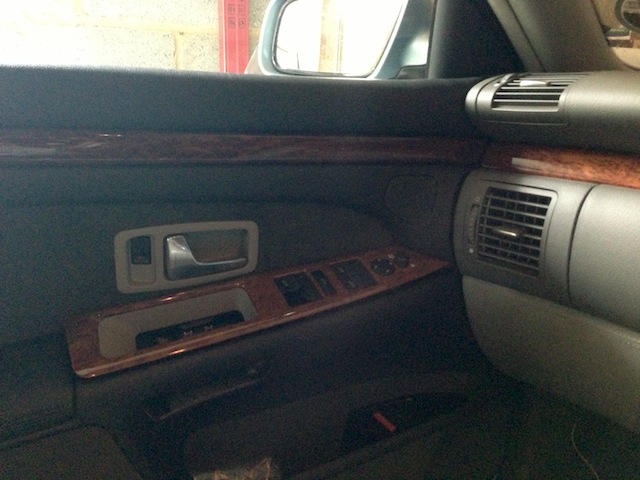

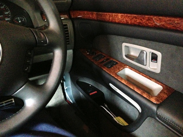

It's a little project I plan to accomplish before annual meet.
Couple of WIP pictures:
Of course, driver can switch off everything with his blocking switch.
The idea is simple: take all genuine panels/parts from LHD car.
Passenger door card has specially marked plastic area that can be removed to create bigger hole for bigger handle with central lock button. This was done to avoid creating too many part combinations (door cards are the same part number for LHD and RHD cars -- Audi only removed that plastic part from proper side in a factory).
