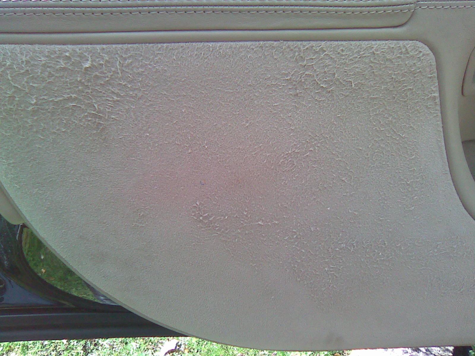

Old 12th August 2013, 09:45 AM
Default Alcantara amenable to repair, to some extent!
After some advice yesterday at AITP to try a fabric "de-bobbler" on my damaged alcantara I had a go yesterday and this morning, plus did a bit of research.
A de-bobbler didn't really do much as the fibres of alcantara are so strong and interwoven that removing a bobble tended to pull up another tuft.
Some online research suggested that shaving it carefully with a new blade works well, but the multi-blades I had available did little.
Then I thought about an electric razor, the sort with slots (e.g. Philishave) reasoning that the remaining tufts would generally get into the slots and "should" be sliced off reasonably neatly.
And that indeed is the case, though it's an extremely slow process.
The picture attached is of my front passenger door. The really bad "furry area" originally was even worse and extended in a strip all the way across from left to right.
First I de-bobbled it, which didn't really do much at all.
Then I worked away at the centre of the bad strip with a small Philips rotary shaver for several minutes. It really is a lot better as hopefully you can see in the picture.
I don't think the end result will ever look "as new" but hopefully will be less jarring on the eye, but it will take time!

Old 12th August 2013, 10:05 AM
That's considerably better than it was Andrew! How new are the Phillips blades? Maybe if you get the worst off with the current blades then put some fresh ones in it may get it looking even better
Old 12th August 2013, 01:30 PM
The blades are fine and self-sharpening, the problem is that the bits clog them up (don't pass through like hair trimmings) so it needs dismantling and cleaning every few minutes.
After a few more minutes it looks like this, only the small rectangle top left has been left for contrast.

Old 12th August 2013, 01:47 PM
That looks a lot better. Good effort. (perhaps you could have tried waxing - the ladies swear by it! )
Old 12th August 2013, 01:56 PM
Don't get me started on that subject!
Anyway, whilst not finished this is the result close-up after going over all of it. Needs a final trim but actually looks pretty good from normal viewing angles, though I say it myself.
That was the second worst door, the drivers needs rather more attention and the back ones are nothing like as bad.
