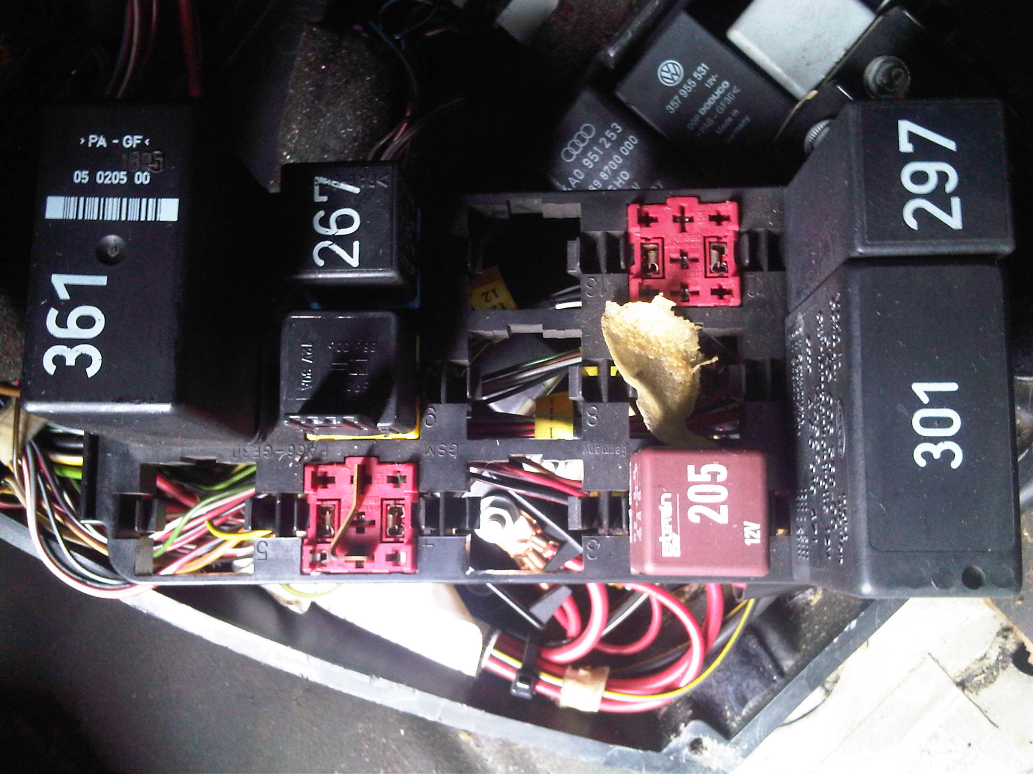

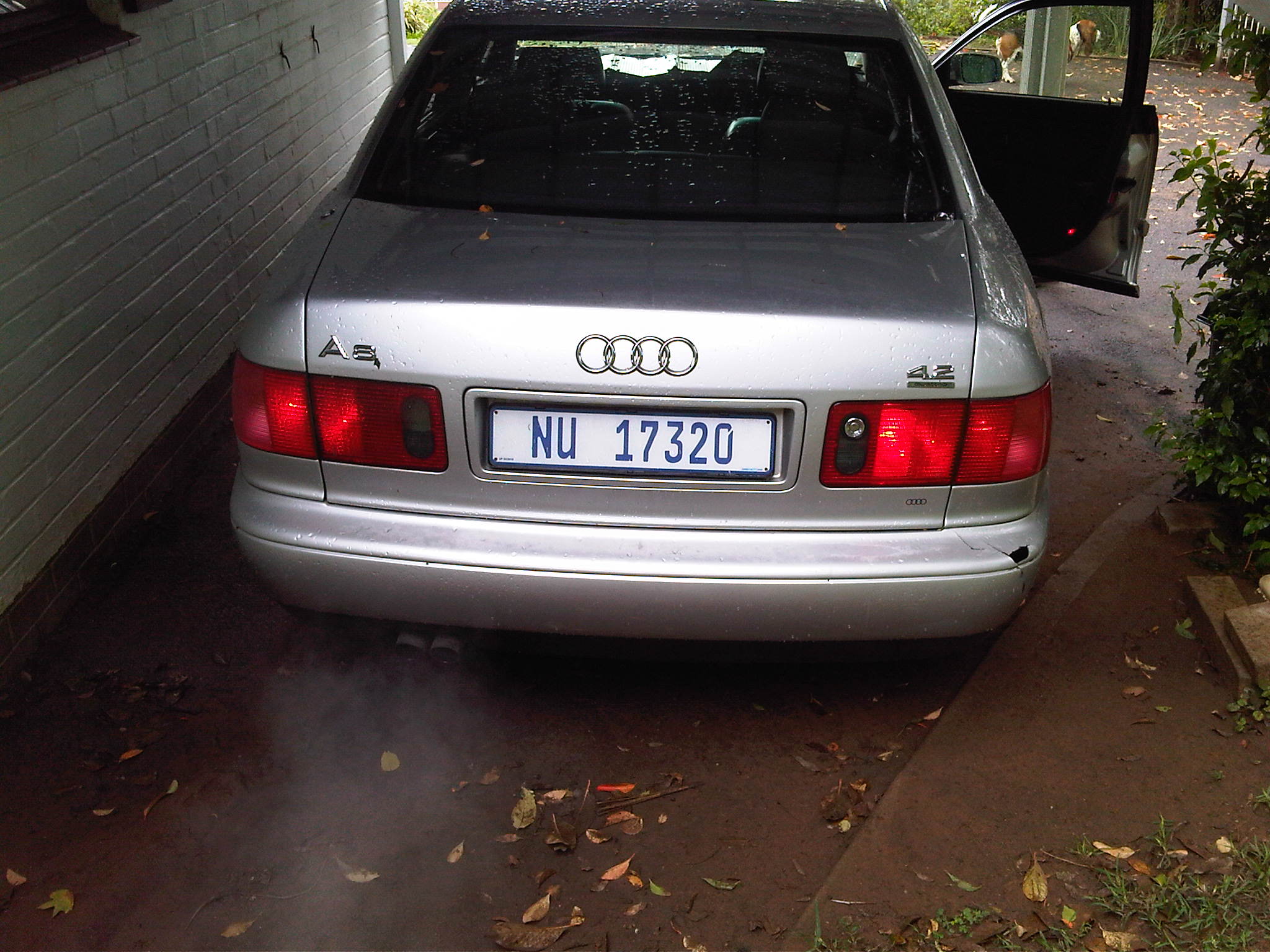

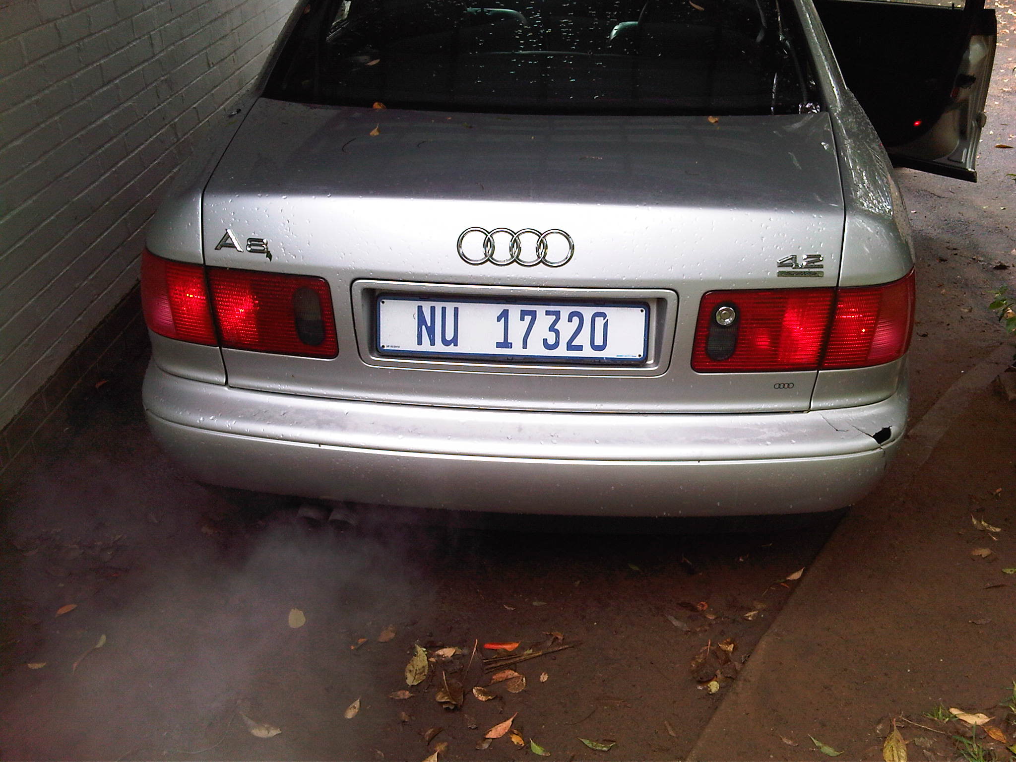

ok. i had a look its called the fog light switch off relay.its in the passenger foot well behind the carpet.you will need to remove the cardboard cover its the centre holder. in the picture attached its the relay below 267 the only black relay without a number. i also attached picture of the fog light on my car which works but only on the right the left is not fitted, i think its a euro specification that there is only one fog light as my understanding is all the A8's where built in Germany so its a import car to South Africa.
your car might be different as mine is PF and yours a FL but sure wiring is the same.

Old 29th October 2013, 10:57 AM
Usually the wiring is there for both, just break out the blanking plate and fit a bulb/holder and connect it and you have 2 (like mine).
Only problem is that the reflector bowl around the bulb probably won't actually have any reflective material on it, so the additional one will appear dimmer. I "mostly" fixed mine with adhesive reflective material that I fed in through the socket in strips and pressed into place with my fingers.
Opening up the whole unit doesn't look practical and a replacement from a LHD country is probably rather expensive.
