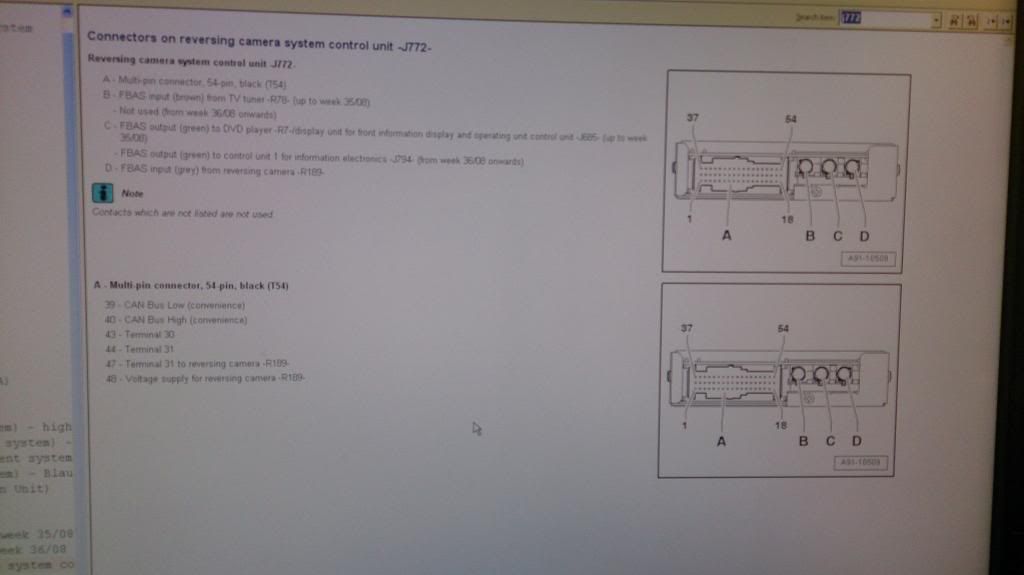

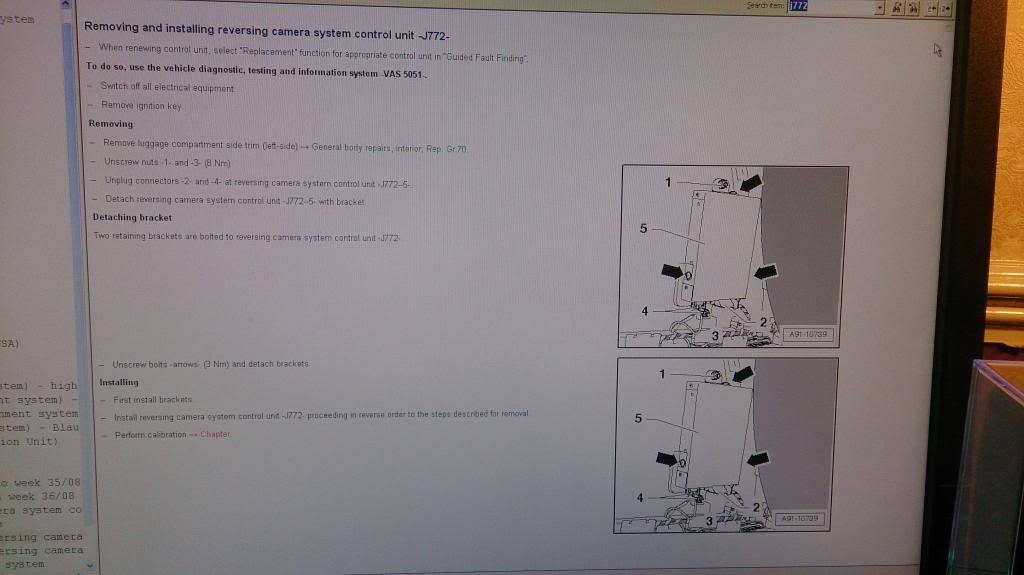

Old 4th February 2014, 04:28 PM
Hope that helps mate
If you need more help just let me know
[IMG][/IMG]
[IMG][/IMG]
Old 4th February 2014, 04:40 PM
Doh why didn't I look in there?
Old 4th February 2014, 04:57 PM
