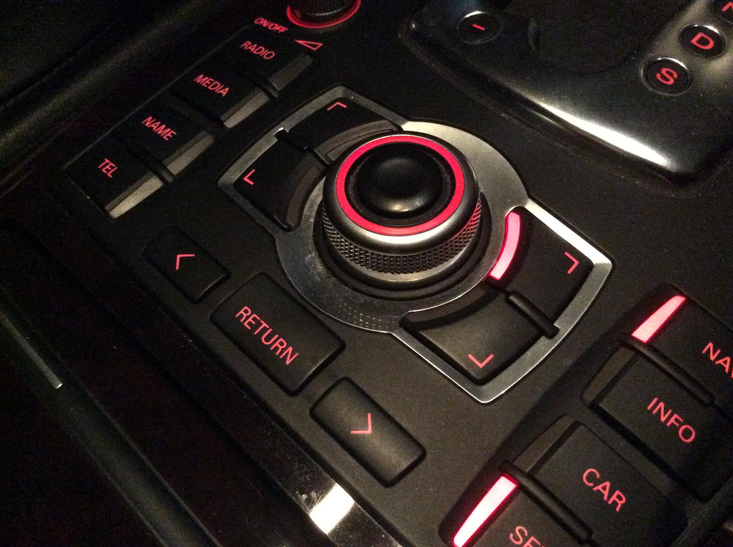

Prior to starting the update process here was my software version:
You can check the following version information by entering Engineering mode. Press Car + Return and hold till the menu opens up. You can also perform backups of the settings and contacts profiles from here.
In Engineering mode, hit Update then choose your Update Medium, usually the SD Card. THe MMI will then search for updates on the SD card and prompt you to choose and continue.
At some point the update process will start and will take 2-3 hours to complete. You can actually leave the car unattended and locked while the update takes place.. just make sure that your battery charger is hooked up otherwise you'll have big problems if the power runs out.
After it's all done your navigation database will be updated.
However you now need to apply the activation key patch otherwise you'll get a message that the Navigation data is blocked. I did so by puting the required files on a seperate SD card and followed the same update procedure.
