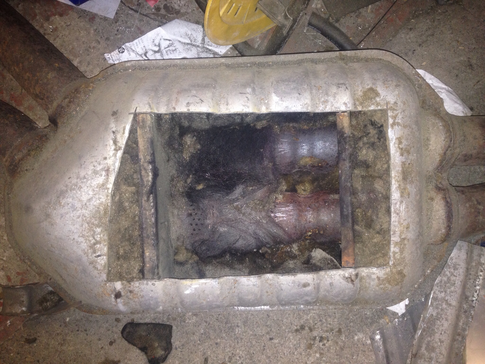

Hi I've been looking into the std silencers and the centre box has a crimp on each pipe and the rear silencer is a work of art! But not for performace! The drivers side at first looks like its a straight through type, but just before the tailpipe it has a insert with a 1"3/8 (if my memory's correct) hole through it.
And the p/s is totally different with 2 180% bends!! Not ideal
Cheers dave
